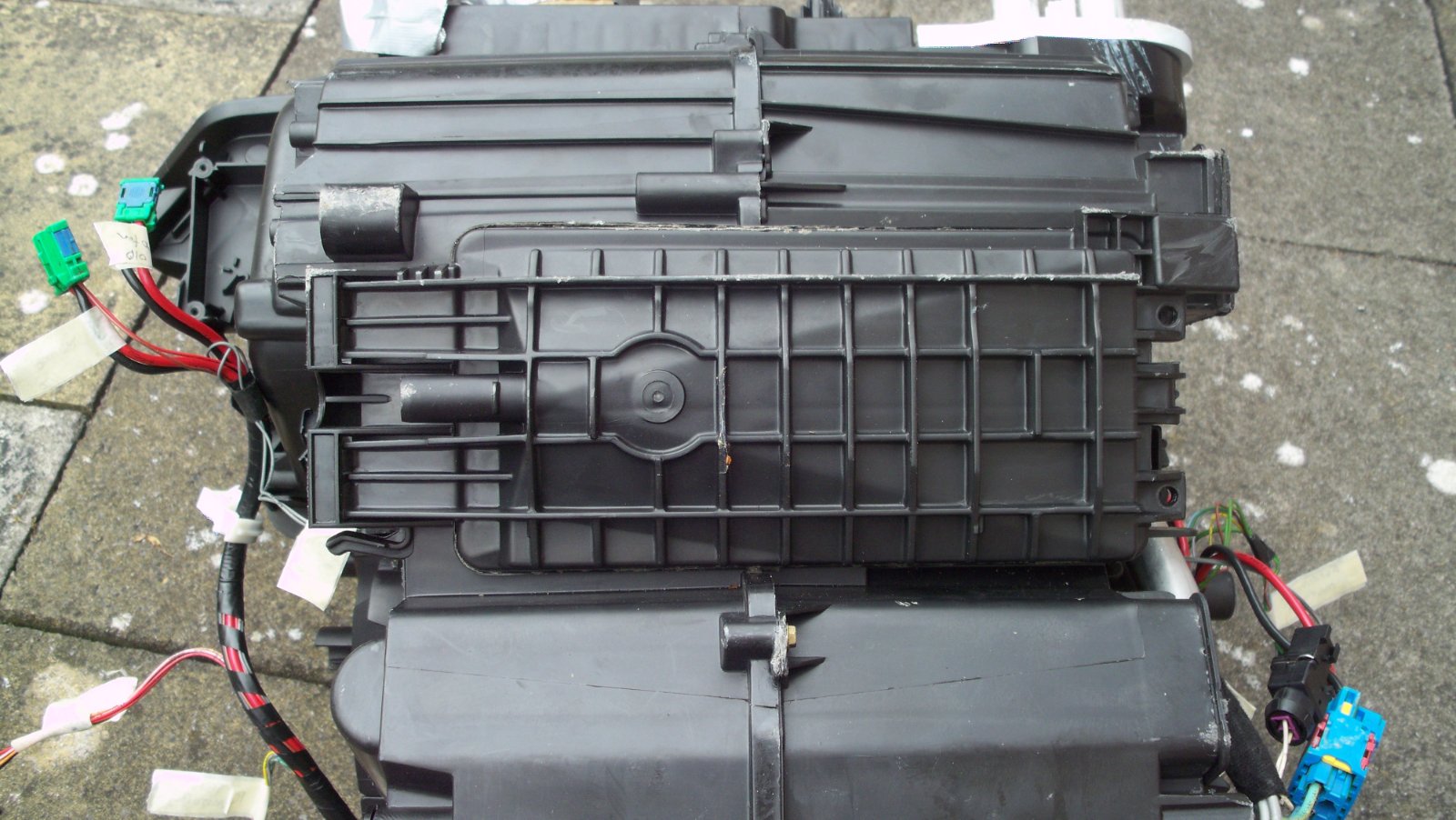

Ok, so the water evacuation pipe is on the left hand side of the heater unit and should go directly out to plug at the other end that may or may not have a further hose for the water to fall onto the road.

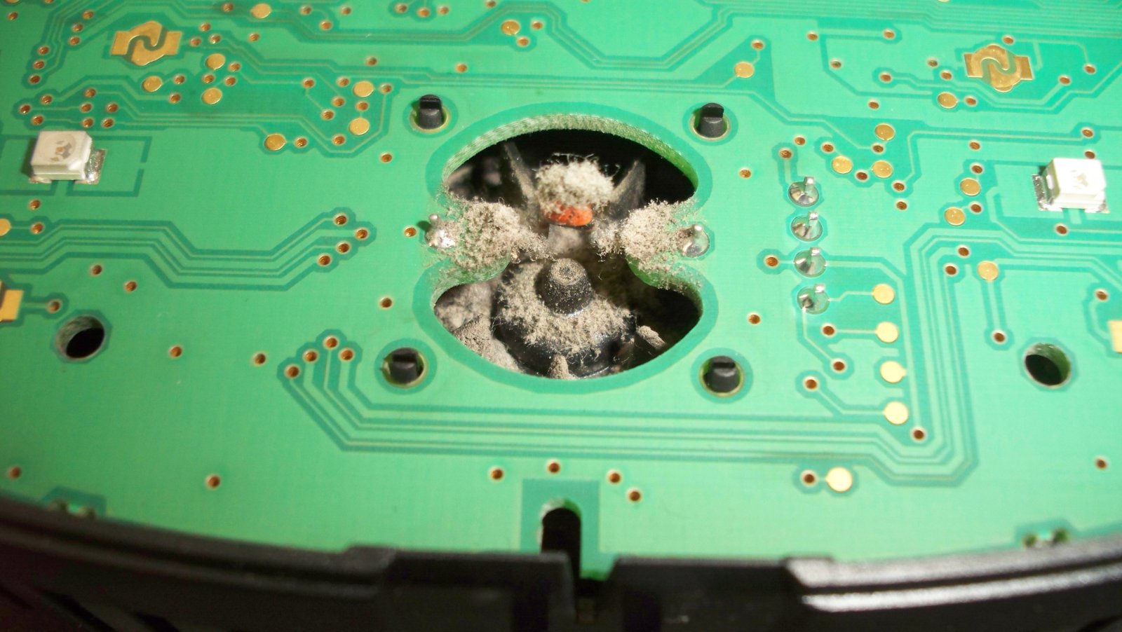

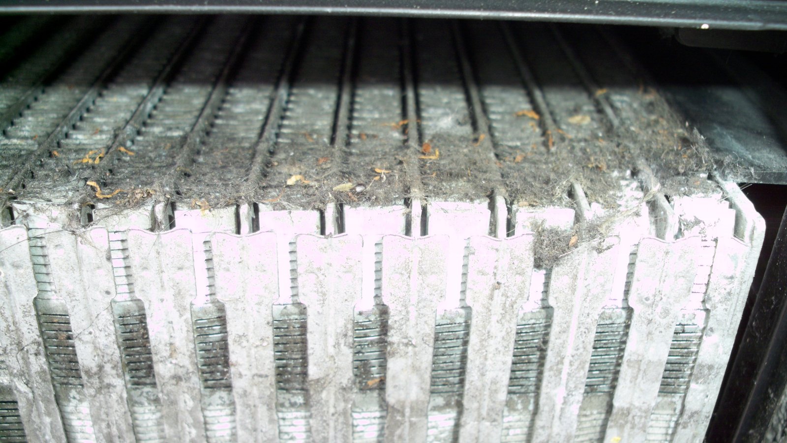

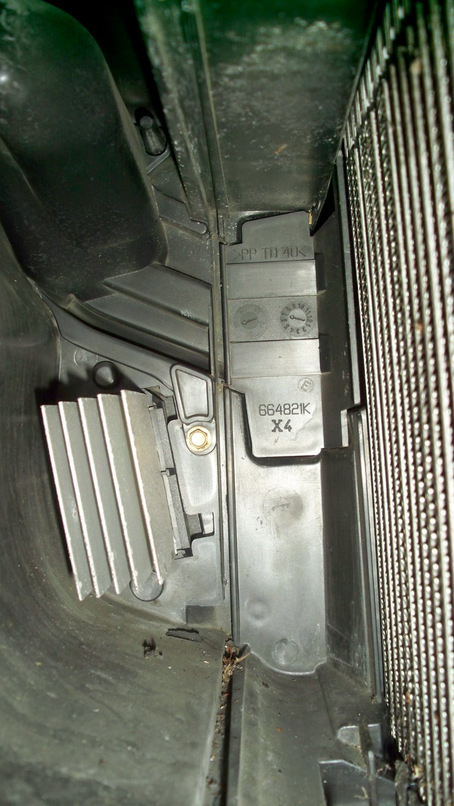

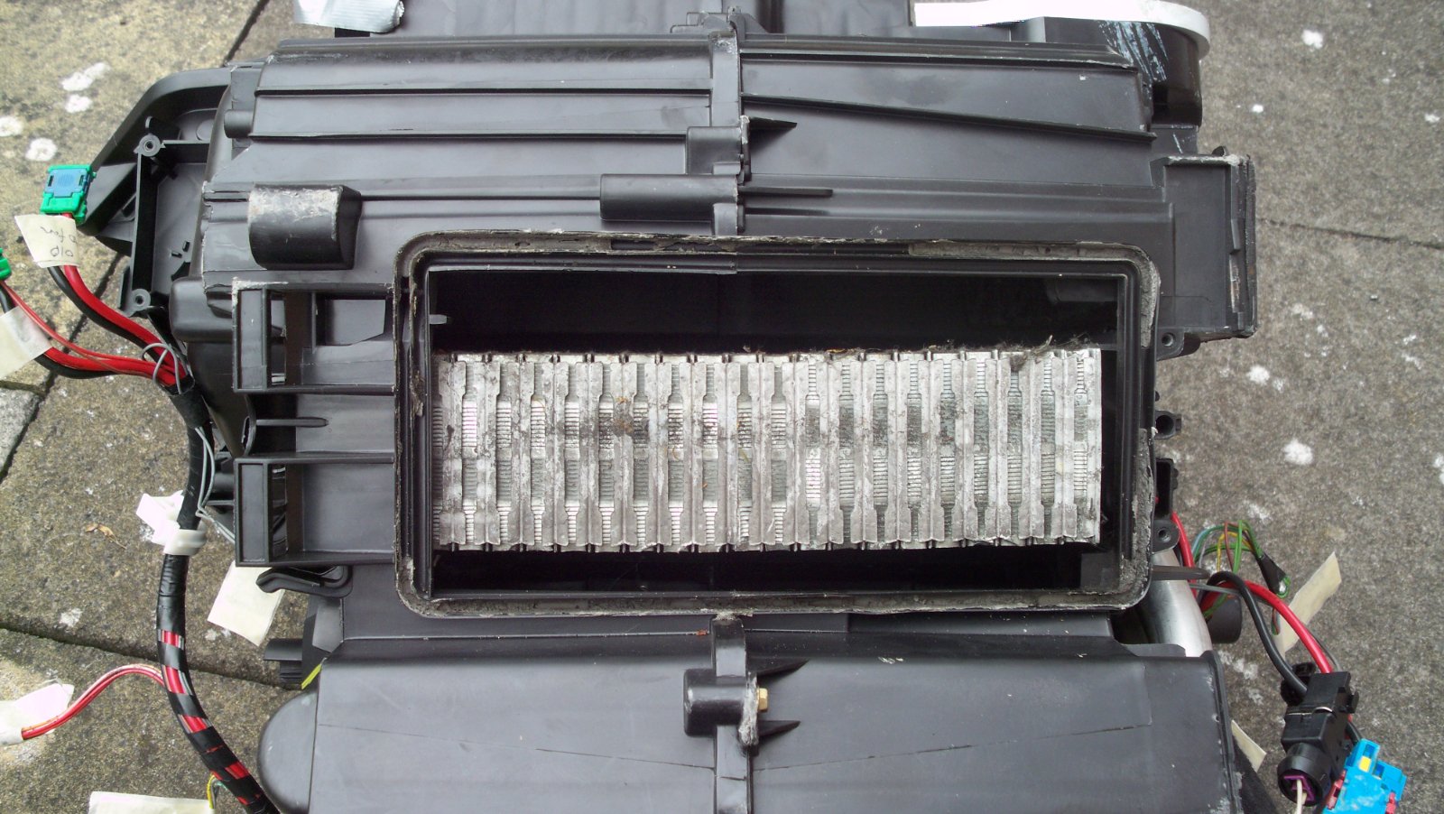

Regarding the condensation drain. The quickest way to check it is remove the cabin filter and pour some water inside. If the pipe is still connected and not blogged the water will immediately drain out of the pipe on to the floor.
Beforehand, I recommend you poke a camera inside the cabin filter aperture. You will see the photo below ie the front face of the evaporator matrix (and the cooling fins for the fan resistor). If the car has ever been run without a cabin filter, or a damaged filter, you may find debris inside. Also, expect to find some green mould. In a worse case, if the pipe is blocked, I suspect the water level would rise until it reached the cabin filter aperture. The drain pipe is actually connected to rectangular tray directly under the evaporator. The tray runs the full width of the heater unit and has a seal. It is retained by 2 screws at one end and plastic tabs at the other. I doubt its seal has failed.

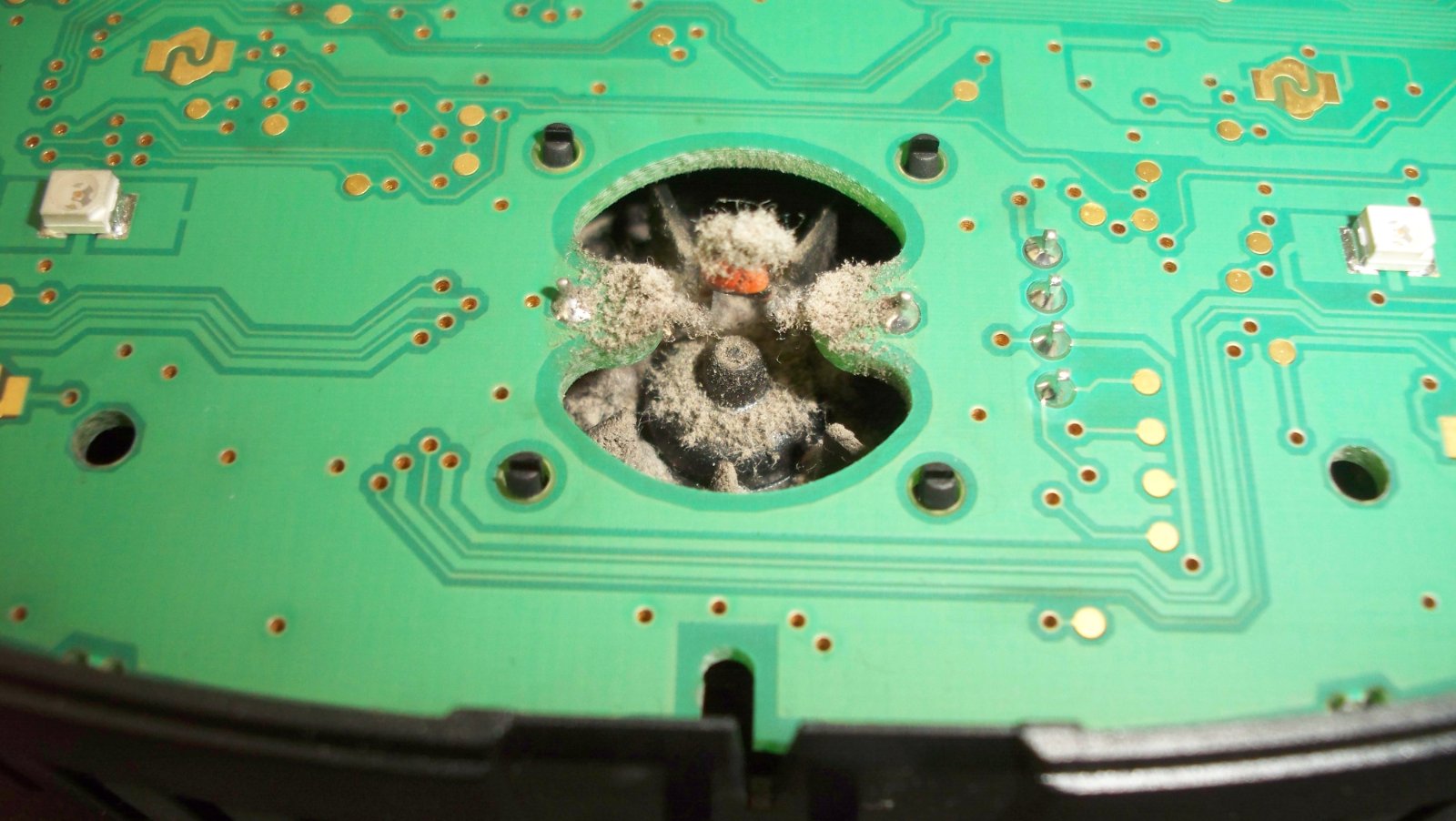

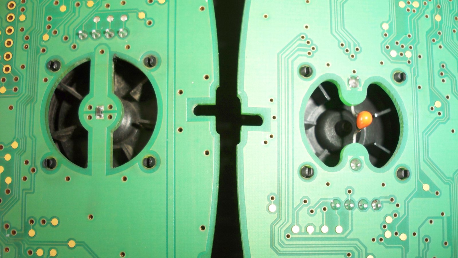

Re: Air Conditioning water exit

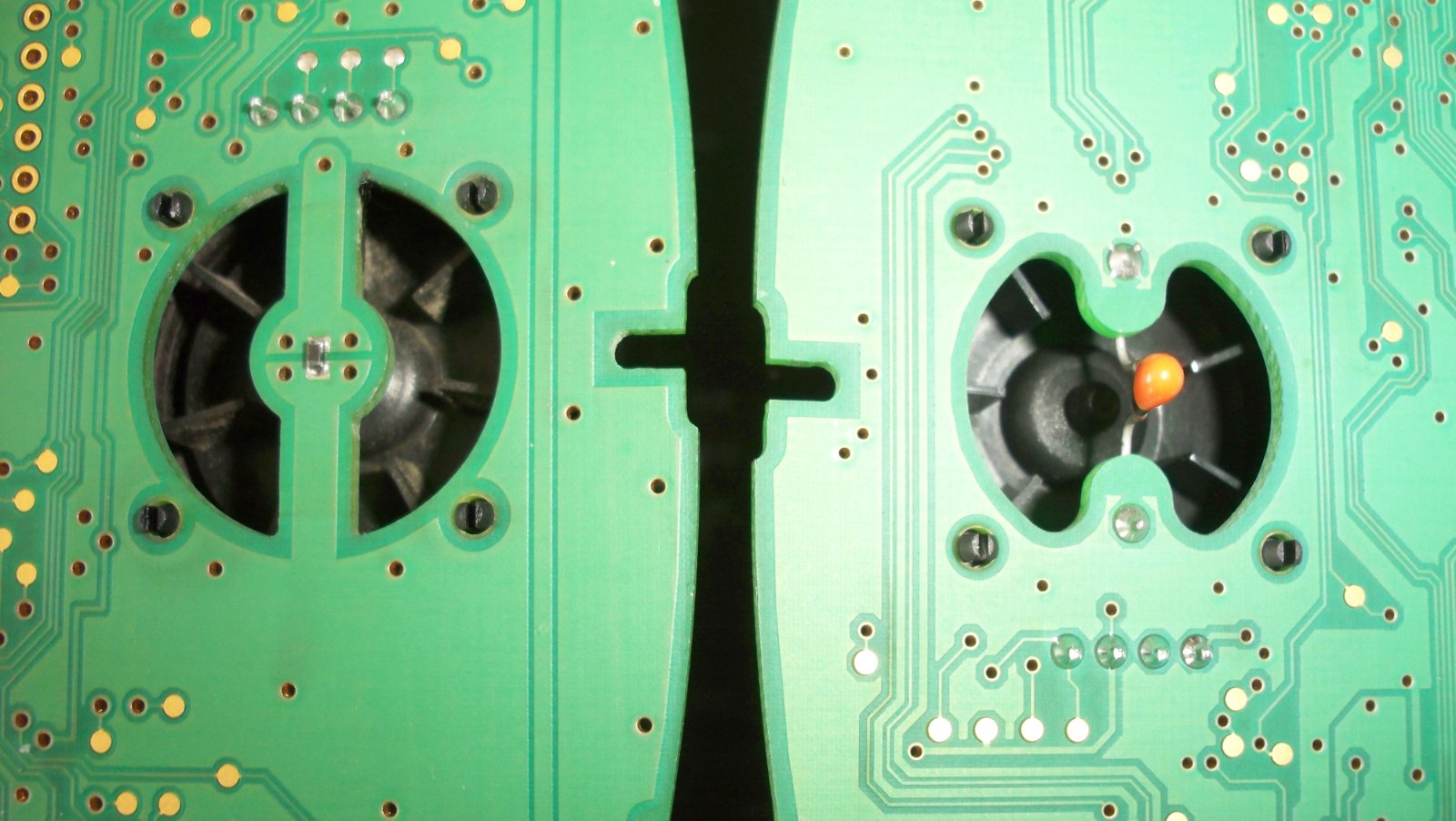

Regarding the heater unit controller. The tiny PCB-mounted fan draws in cabin air and passes it over a thermistor to measure its temperature. The photo shows 2 types of thermistor used. The right one with the orange blob is obvious. The tiny component on the left is less obvious.
This was the state of mine before I dusted it off last year (after 20 years).

Mine has the small thermistor. I did clean it all with a brush, but didnt thought that such a tiny part would be the thermistor. It's free from dust, anyway , and after i take care of the rest of the motors, i'll check if inside temperature read is correct, with Diagbox.aspire_helen wrote: 07 Mar 2023, 00:09 Regarding the heater unit controller. The tiny PCB-mounted fan draws in cabin air and passes it over a thermistor to measure its temperature. The photo shows 2 types of thermistor used. The right one with the orange blob is obvious. The tiny component on the left is less obvious.

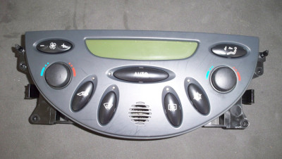

Another thing to sort out is that dammn gummy stuff on the rolling buttons. They are super sticky at the moment - yuck

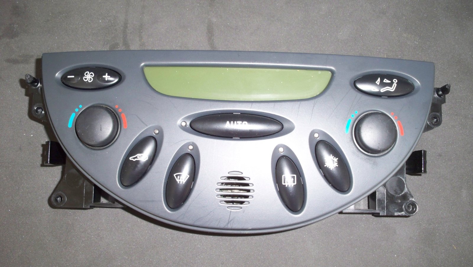

Ref the "dammn gummy stuff"......the soft touch coating can be removed by abrading with WD40 on a cloth, resulting in a smooth black finish (see photo). Since then I have also done the radio volume knob.
