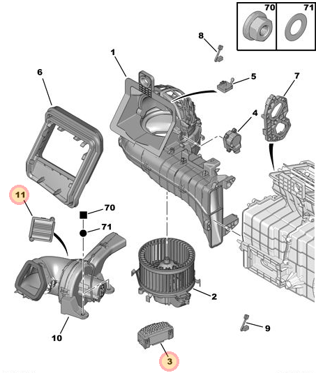

Ok, so the reason may be that you have a Main Blower Motor (2) and an Additional Blower Motor (10), each with their own Heater Motor Control Modules (HMCM) shown at (3) and (11) respectively.

Re: 2008 Grand C4 Picasso AC / blower speed
Yes, mine did exactly this. I believe it's part 3 you need to replace. A pattern one off eBay cost me around a tenner.
Looks fun to get to! If I'm replacing one I may just replace the other at the same time so I only bit my head / scrape my wrists to ribbons once.
In hindsight I'll stick to part number 3 for now seeing as the one at number 11 is rather expensive!
I forgot to add the current retail prices and parts for you:
(3) 6441CE, £280.79
(11) 6441X3, £292.76
