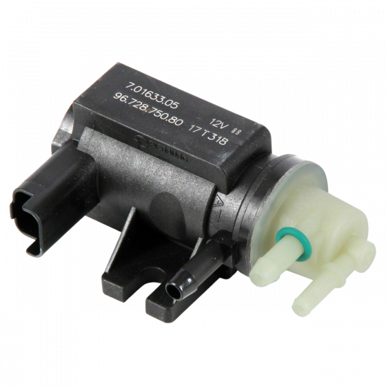

Well this is i believe my turbo solenoid valve (Stock picture) and theres no filter on it, so i replaced it for good measure and still nothing, replaced the actuator too and still nothing, i currently have the DPF off, by god did a LOT of crap come out of that with the cleaning solution! First jet black stuff followed by thick reddish brown stuff the consistency of grease but dissolved as soon as it met water????southwea1976 wrote: 01 Mar 2023, 10:18Thanks, will trace the vac pipe back to it and have a look, it has good vac so i don't think its going to be that but its worth a look whilst I'm under the bonnet.admiral51 wrote: 28 Feb 2023, 21:03 If you are referring to the Turbo solenoid Valve then yes it does, a very fine mesh/linen filter. If very dirty will look black and not like a filter

You're going to tell me this isn't the valve i was looking for aren't you?!

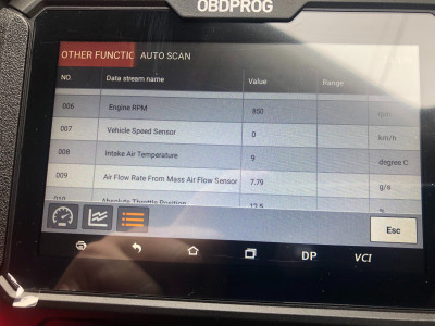

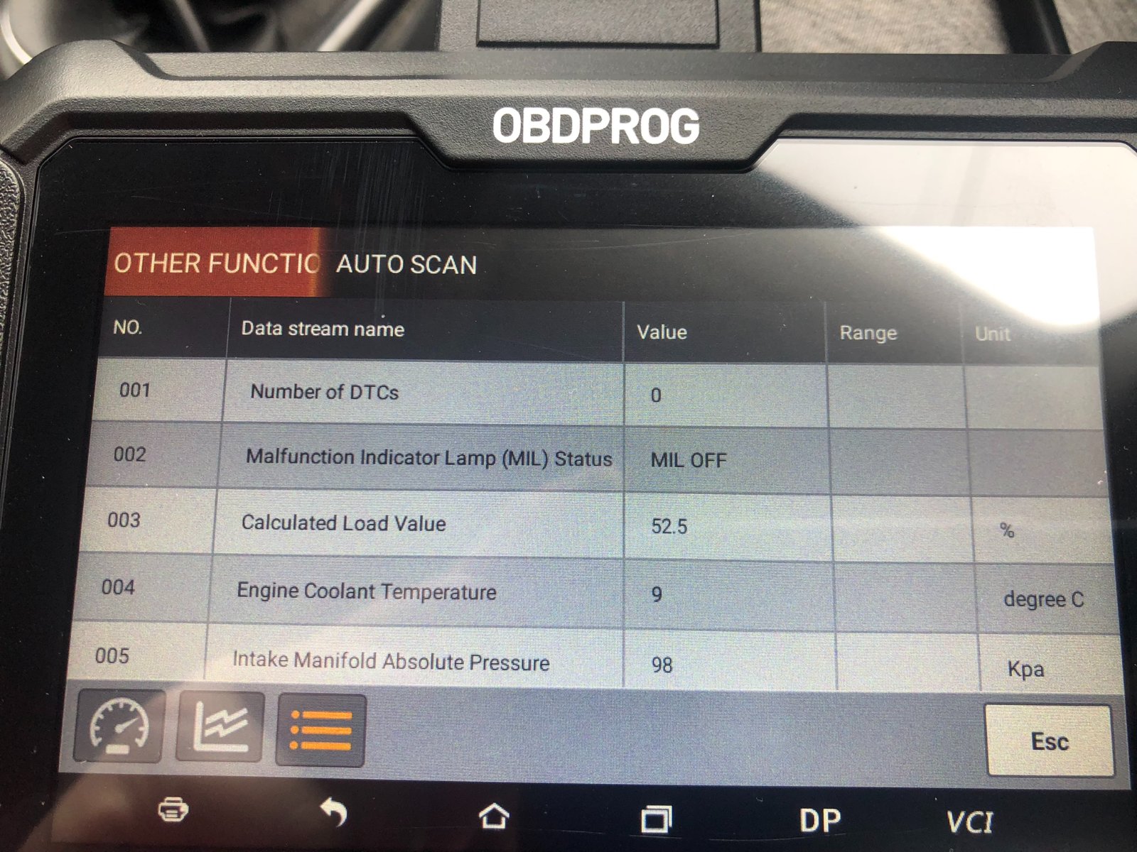

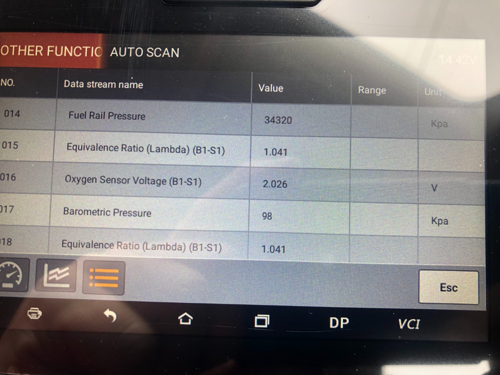

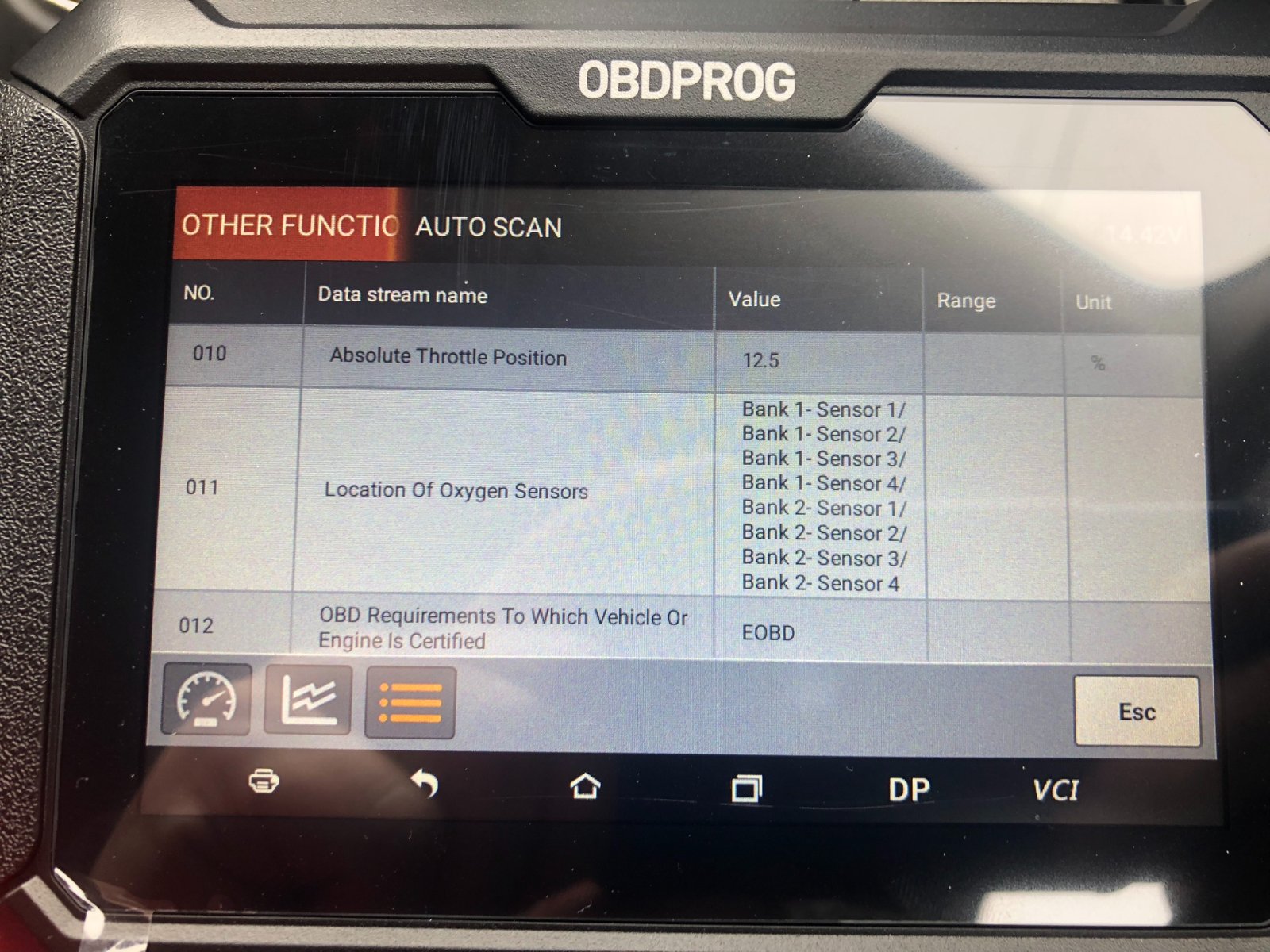

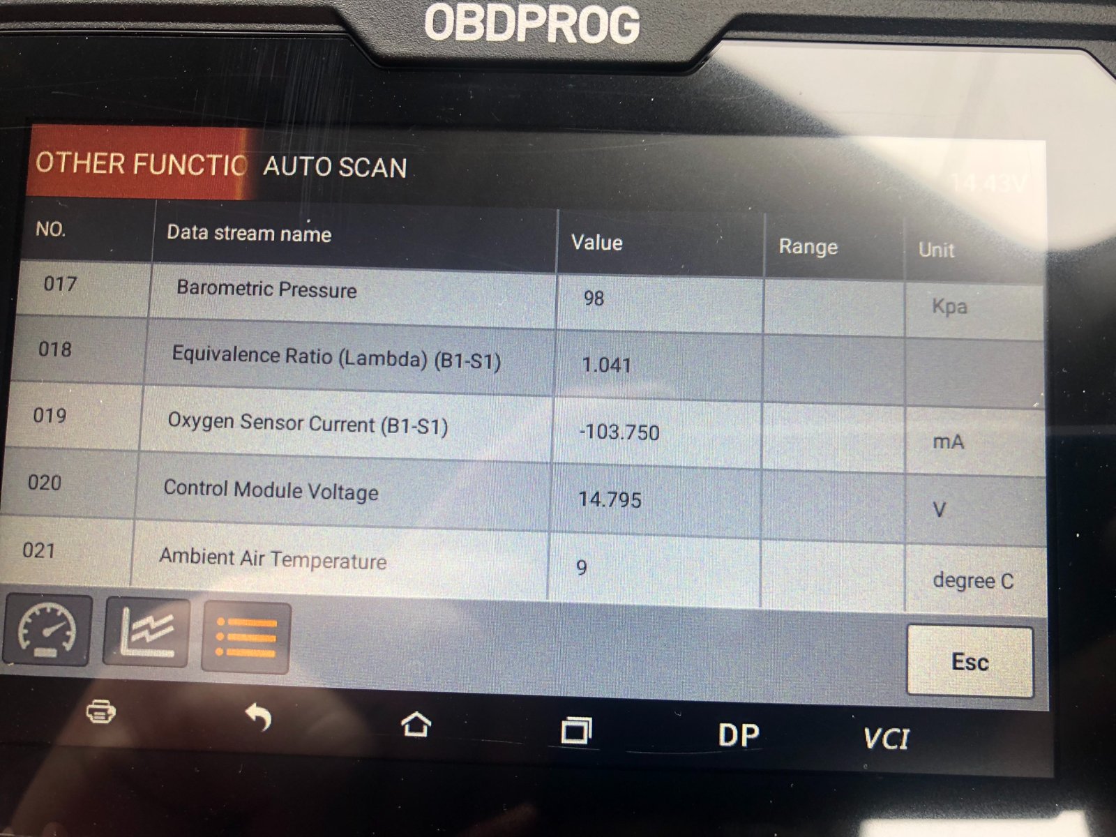

Added all the live data it shows if it helps anyone see anything out of place?
