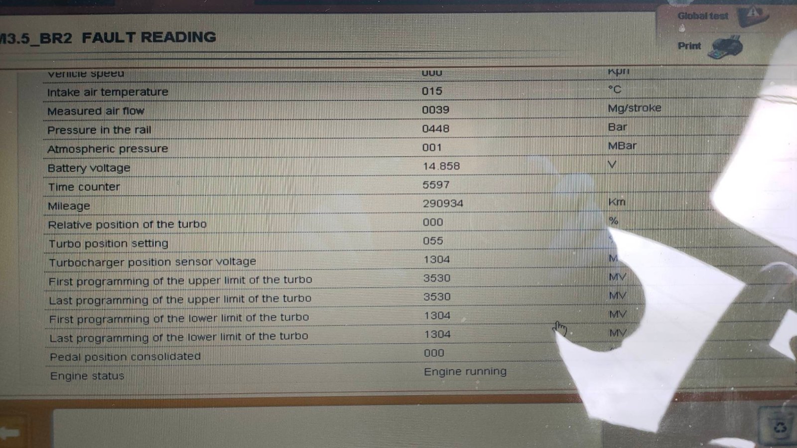

Have a look at the live data for the engine ECU - there are lots of tests you can select that will show live data in Diagbox.

Hi, @GiveMeABreak.........I'm wondering if you can make any sense of this data, or direct me to a place of info where I can make sense of it?
Still no engine light on van, but using Diagbox 7.83 now showing P2566. As I've already changed the solenoids and completed several actuator tests with nothing to report I'm now not sure what to do next.
Any help greatly appreciated. thanks.

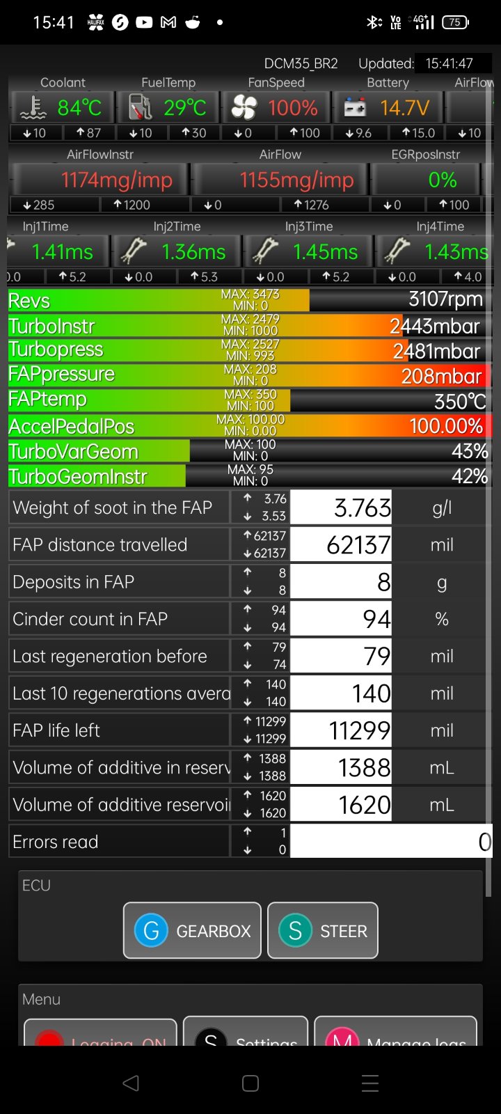

The turbo actuator arms moves by hand, though it's quite hard on the fingers, it's goes up and springs back with a decent amount of force. Upon starting the arms pulls and holds.
I'm starting to think this app is a little temperamental and sensitive and giving me reason to think there are problems where there are none.
I still think it's a leaking injector issue.
If you can take a look at the following info and tell me if anything stands out?
Specifically the readings from the Turbo at the bottom. WOT and showing as 43%?
I'm going to assume this is only 43% Open/Closed as Off throttle it's closer to 80%. I've asked the app developer for input on how to interpret the bars.

FAP PEUGEOT CITROEN APP.

Unfortunately I don't have that sort of data for this later (DW10CD) engine and wouldn't want to provide info from a different DW10CTED4 engine as it may have a different setup.
Re the codes - they can differ from engine to engine and constructor to constructor, as they are designed to allow for that, so therefore can have different triggering conditions, values, symptoms and causes, so I always like to use the exact engine and engine ECU for members where I can.
