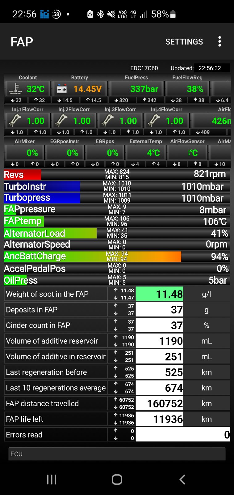

Finally regarding the dpf/fap I have used the app to check stats and I will upload a screenshot. I'm trying to ascertain what the different descriptions mean, for example the fap life left is this just an estimation? Also the deposits in fap is 37g, does anyone know the level for which this alerts for a replacement or cleaning of the fap?

Next, your DPF additive tank has a capacity of about 1.2L and it is estimating you have 251 ml (about a quarter) of a tank of fluid left.
Next the Deposits in the FAP. There are elements in the organic Cerine compound used in the Eolys additive that cannot be burned off through regeneration of the particle filter. These along with elements of the engine debris, carbon and ash will ultimately block up the filter.
The grammes weight of the additive in grammes that is deposited in the filter are estimated by the engine ECU and when they get to higher levels it will trigger replacement of the particle filter warnings.
The FAP Life left is an estimation of service life remaining based on distance before it will need replacing or cleaning. Depending on version and engine / model these have a varying life of anything up to 150k miles. But this can be increased or reduced depending on driving style and conditions and how blocked the filter is.

Many thanks for the replies. I will post the vin later when I get home. Yeah I have seen many forums and videos of dpf cleaning rather than replacing at a much cheaper cost. I'm just a bit confused regarding the deposits in the fap vs fap life left. I have seen mention of around 80g for the deposit limit in the 1.6 which would mean it is around half capacity at 100k miles but yet the fap life is saying less than 10k miles is remaining. The yearly milage has been fairly high so I'm tipping a lot if motorway miles ideal for passive filter regeneration as opposedto active. If driving habits were to stay the same would that mean potentially another 100k before issues for cleaning or replacement arise or am I looking at this wrong?

Not really, as you forget that the additive is dosed into the fuel system whenever fuel is added. Therefore the Cerine is already in the system, regardless if the filter is passively regenerated or actively regenerated. So highly unlikely you will get another 100k out of it.

Ok thanks Marc much appreciated. Do you think I should be concerned about the 12k fap life left? I also run archoil 6900 or millers cetane booster and detergent for a cleaner burn and always get brilliant results on economy and use a concentrated form one shot every 6 month for a deep clean (archoil 6400d max) This also has combustion catalyst in it which is supposed to aid in regeneration and lower temps but as this is slightly different system with the eolys should I proceed with the same process or could I risk damage? I'll ask their tech support aswell see what they recommend.

Ok many thanks, I'll look at getting them both done soon. What are your thoughts on the fap life left? What would you roughly estimate for those figures? Also if 3/4 additive has been used does that leave roughly 20k miles before needing top up? Quarter of 80k being 20k

You can safely ignore the DPF until such time as you start getting warnings about clogging or a service message. Also you will get a warning about the Eolys fluid requiring a top up (which is calculated from the estimated volume remaining as it is not physically measured) when it looks at the estimated remaining fluid against the miles remaining on the service maintenance indicator. If the fluid is deemed to be low and from the miles remaining until the next service it thinks the fluid will be insufficient, it will flag a warning up about requiring a top up.
