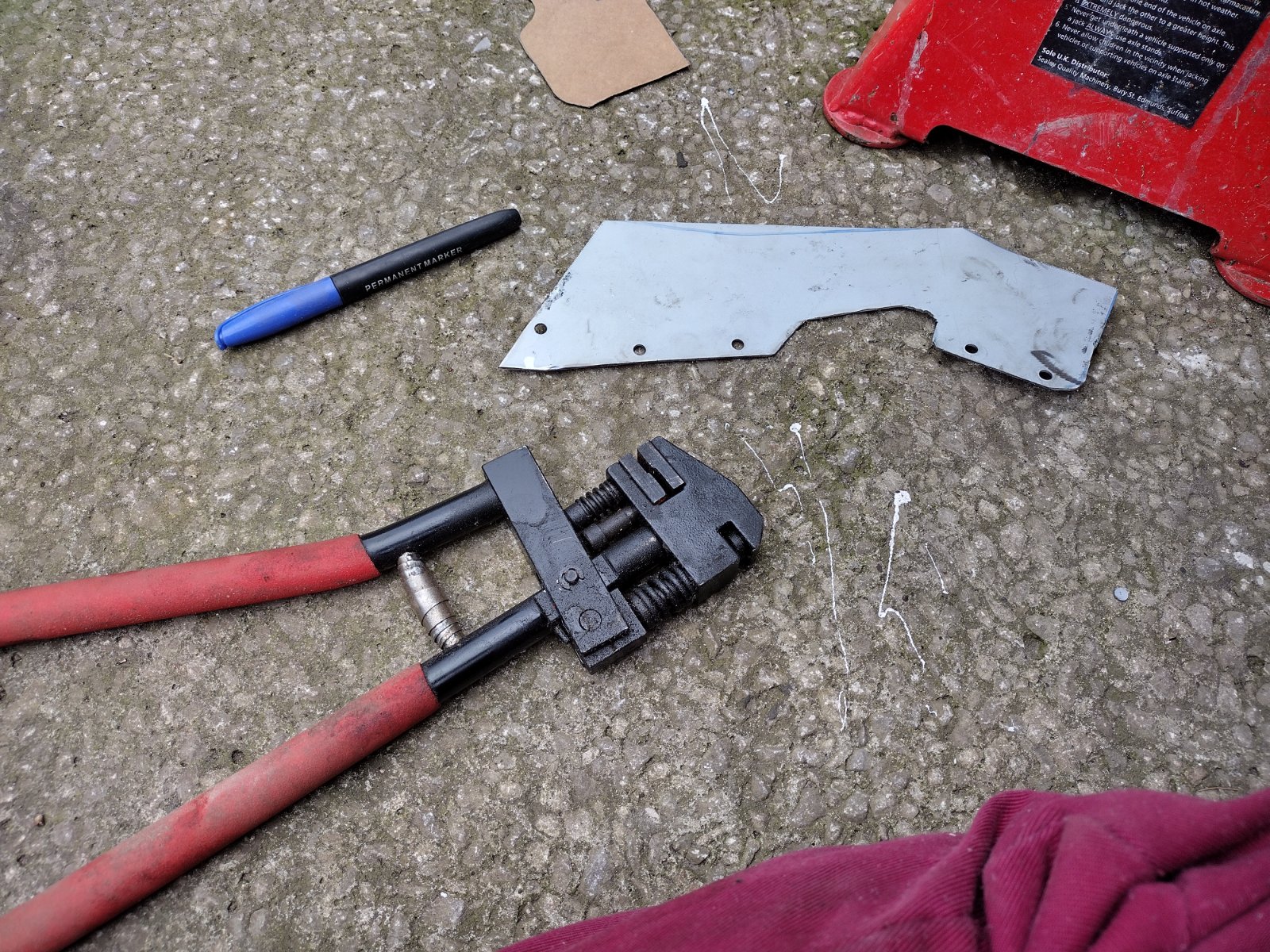

Finally some Coupe welding progress!
Rear arch panel cut from my piece of "Zintec" and tweaked to fit. Small holes to weld through, aka a plug weld (substitute for a spot weld)
Bigger holes (12mm) for a squirt of waxoil or similar into the cavity behind once completed. To be sealed by a blind grommet to then keep the weather out.
Not very neat, will "lanish" it back with angle grinder flap disk shortly, then quick paint.

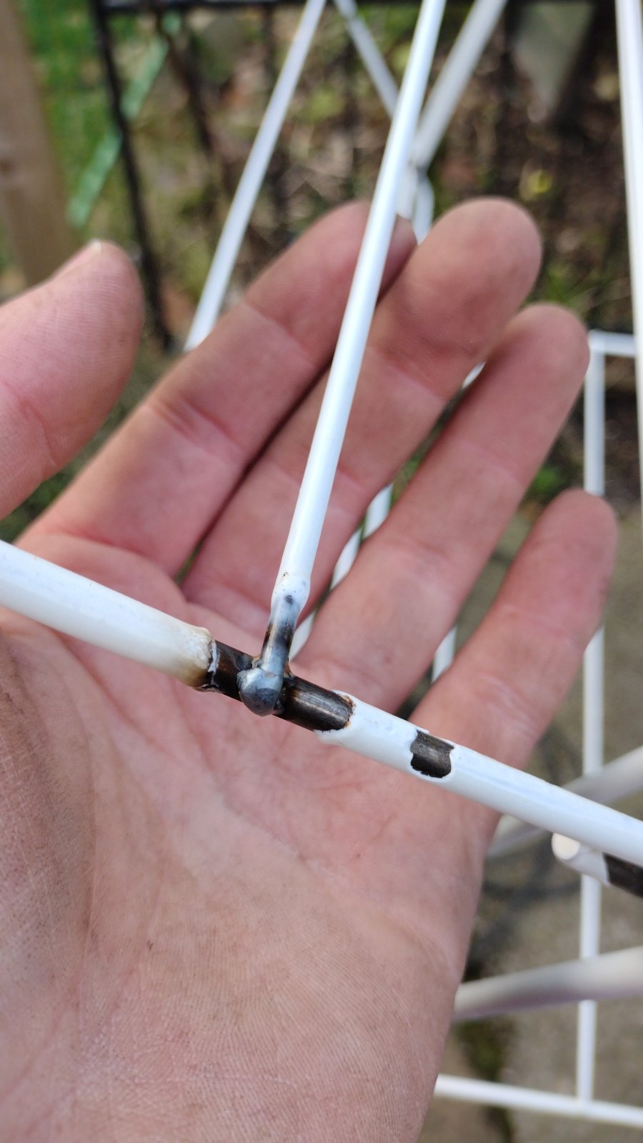

Then remembered the loose bits on the clothes airer - so welded that too (Yes they're cheap enough not to bother doing this, but will let it carry on a bit longer)

Nothing wrong with a bit of side tinkering matt, always good to do several thjngs at the same sort of time , busy minds need the input, nice bit of sheet metal work there too , once all flatten are you zinc coating or just black stuff ?

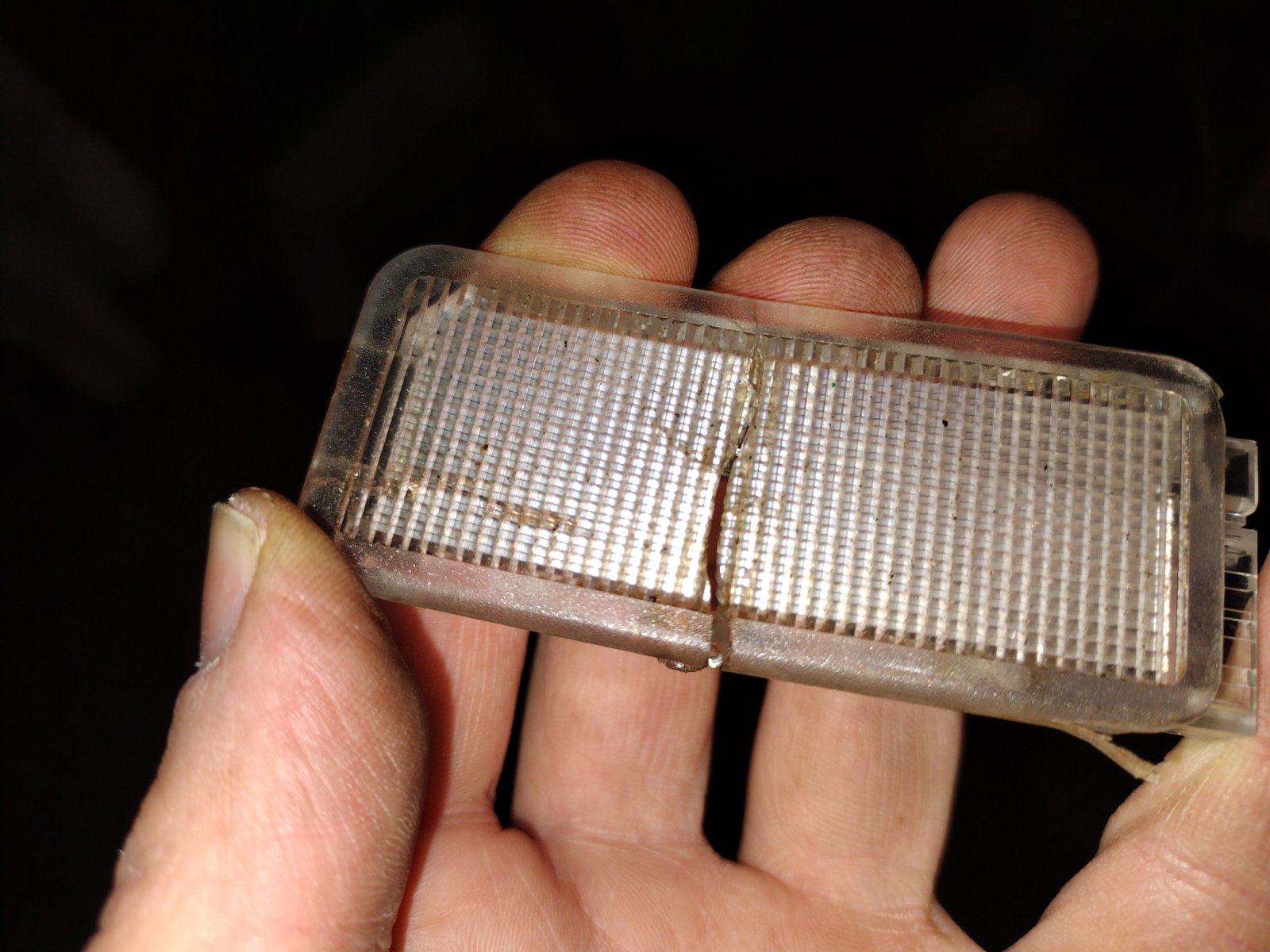

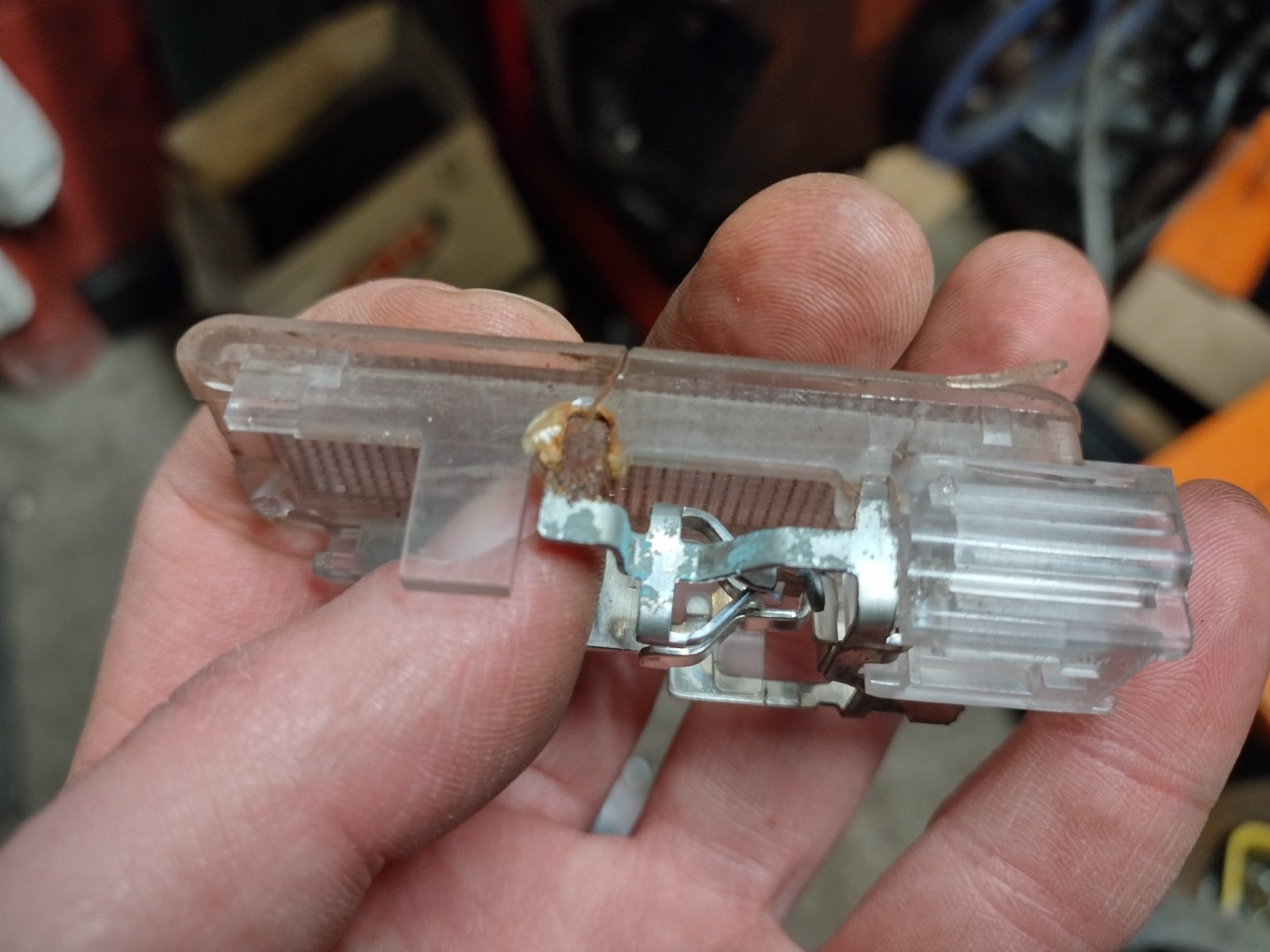

Front, rear and left hand boot light bulbs swapped for LED replacements. Instigator was realised that the boot light lens wasn't staying in place as it was completely knackered! Thought a deep scratch on the lens was actually completely cracked in two! Fortunately I have one "in stock" that's been kicking around my garage for a decade or two!

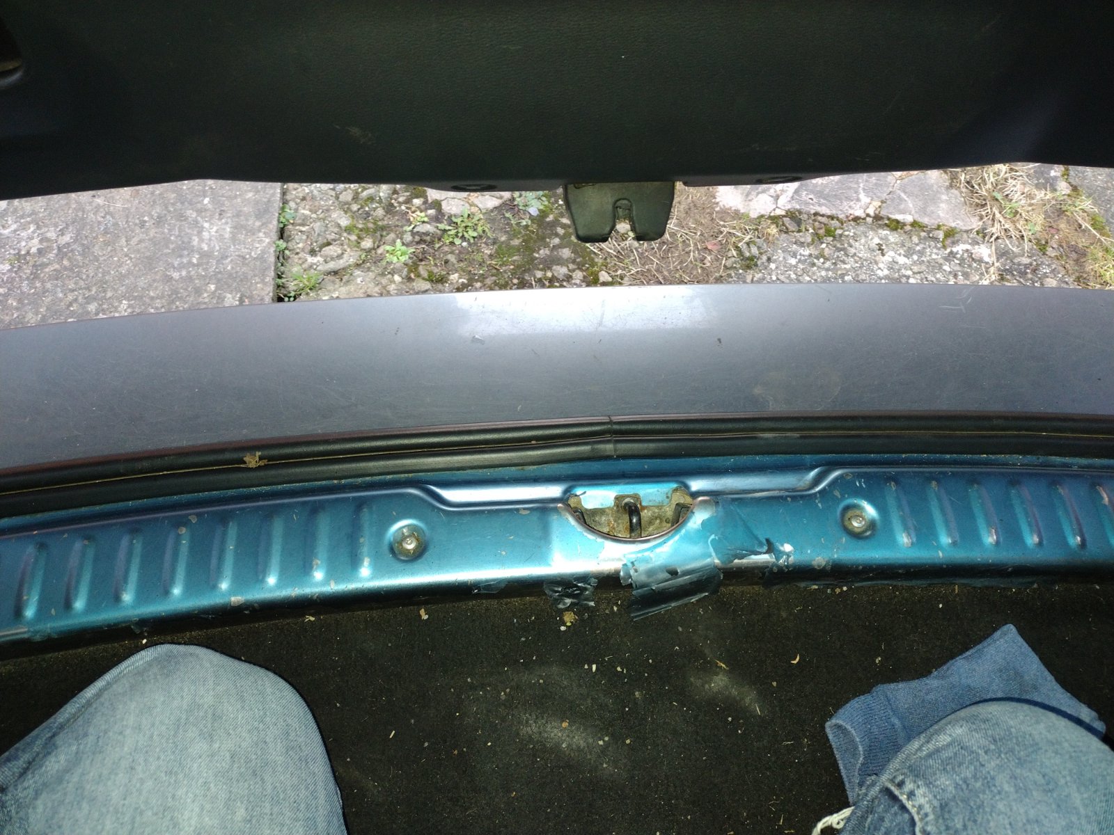

Boot sill trim piece - stainless steel - the raggedy piece of protective blue film it came with new peeled off. Considering this is supposed to be removed when new, I think the blue stuff hasn't done badly since 2011!! The right hand tie down point was wobbly, but straight forward fix = tighten the Torx head mounting bolt (under the stainless trim)

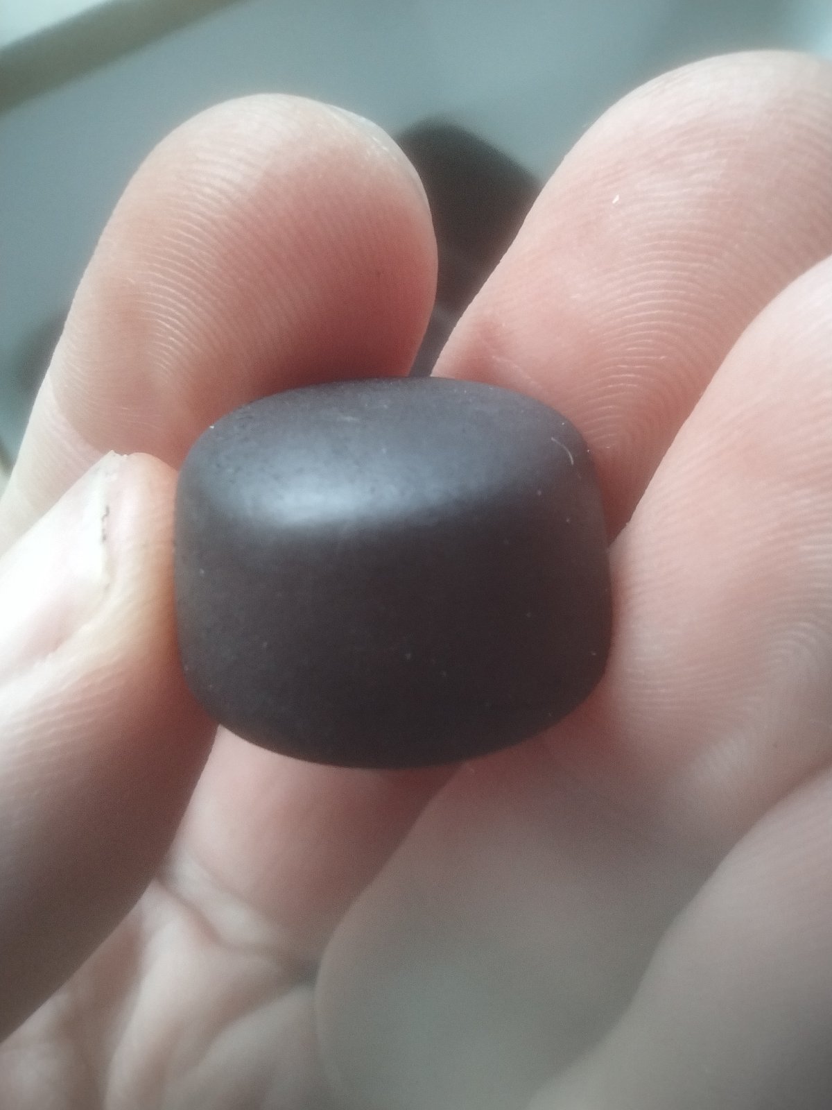

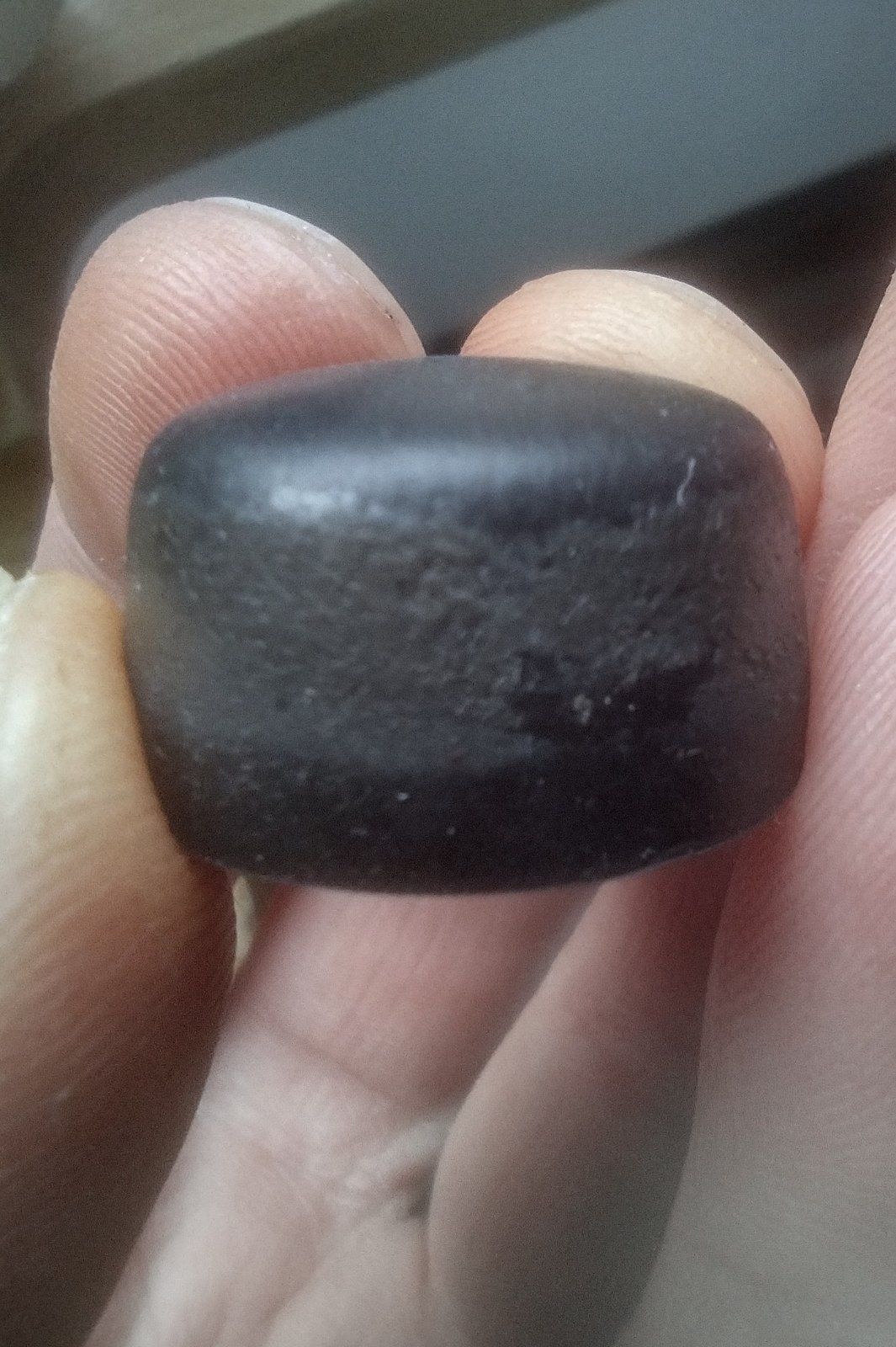

Next the grim volume knob was pulled off and cleaned up:
308:
