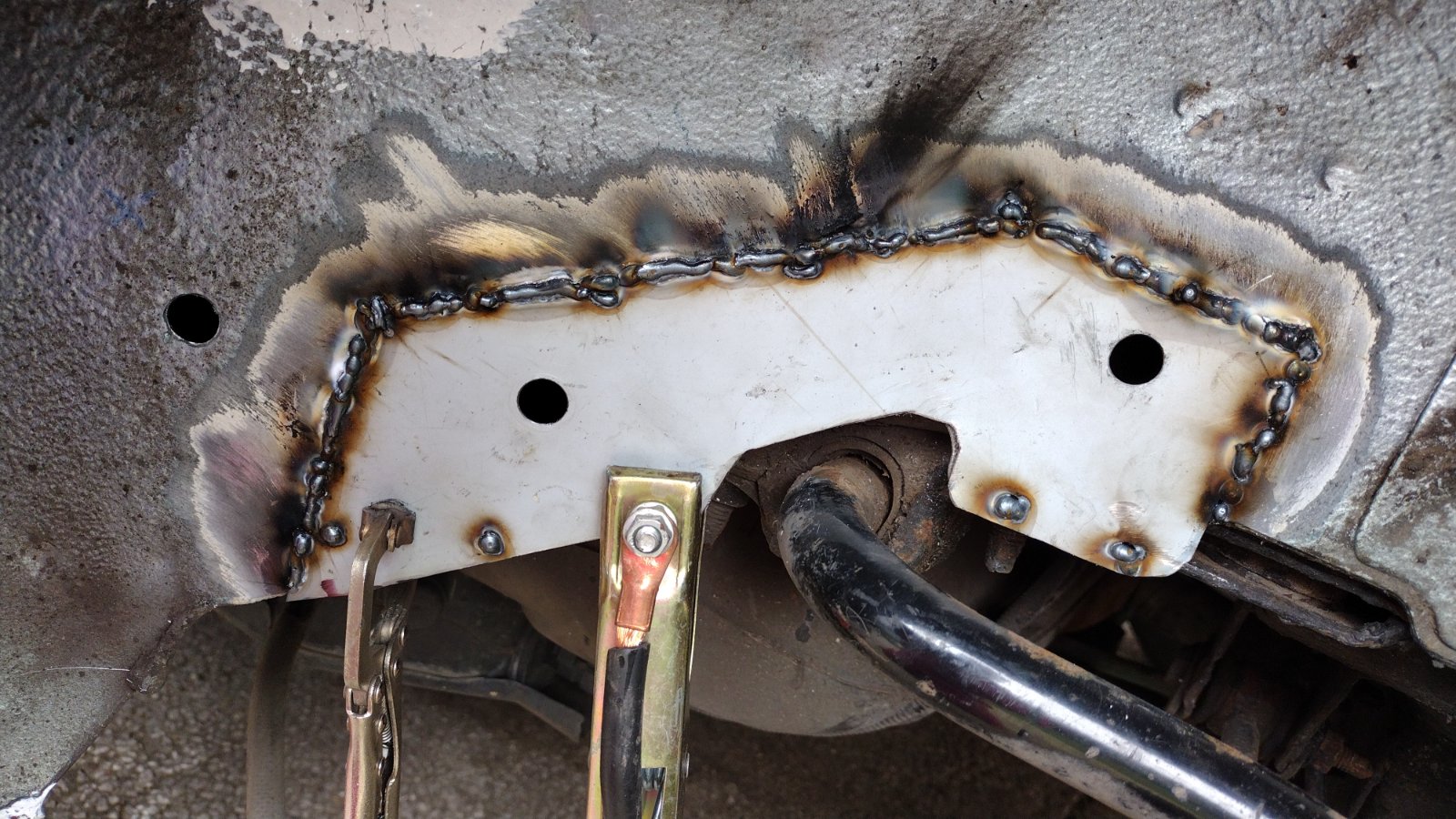

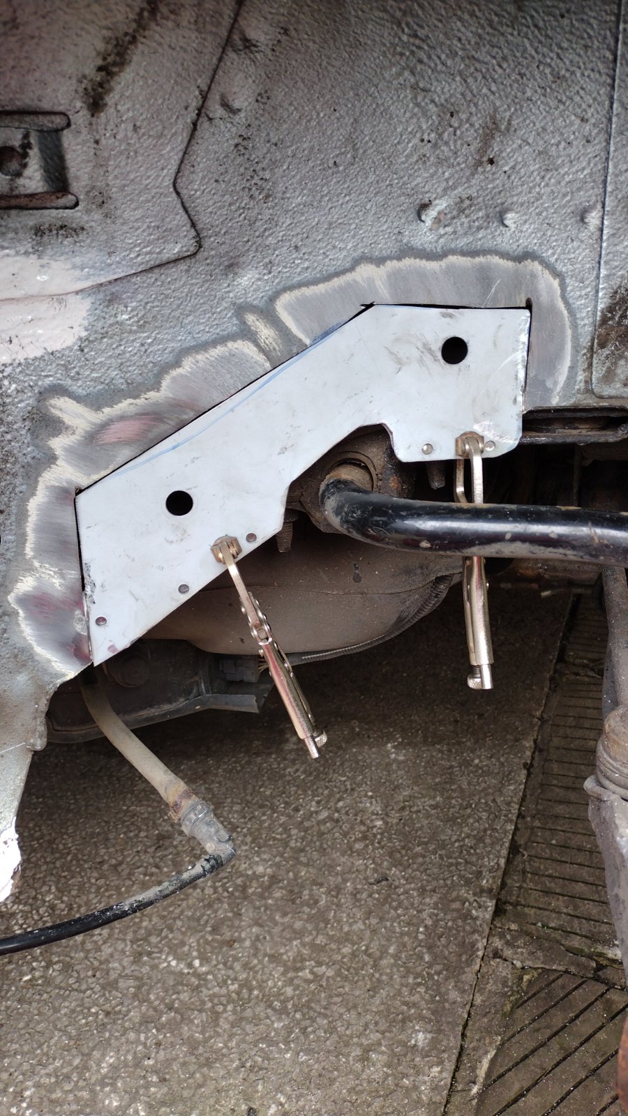

Finally some Coupe welding progress!
Rear arch panel cut from my piece of "Zintec" and tweaked to fit. Small holes to weld through, aka a plug weld (substitute for a spot weld)
Bigger holes (12mm) for a squirt of waxoil or similar into the cavity behind once completed. To be sealed by a blind grommet to then keep the weather out.
Not very neat, will "lanish" it back with angle grinder flap disk shortly, then quick paint.

Nothing wrong with a bit of side tinkering matt, always good to do several thjngs at the same sort of time , busy minds need the input, nice bit of sheet metal work there too , once all flatten are you zinc coating or just black stuff ?

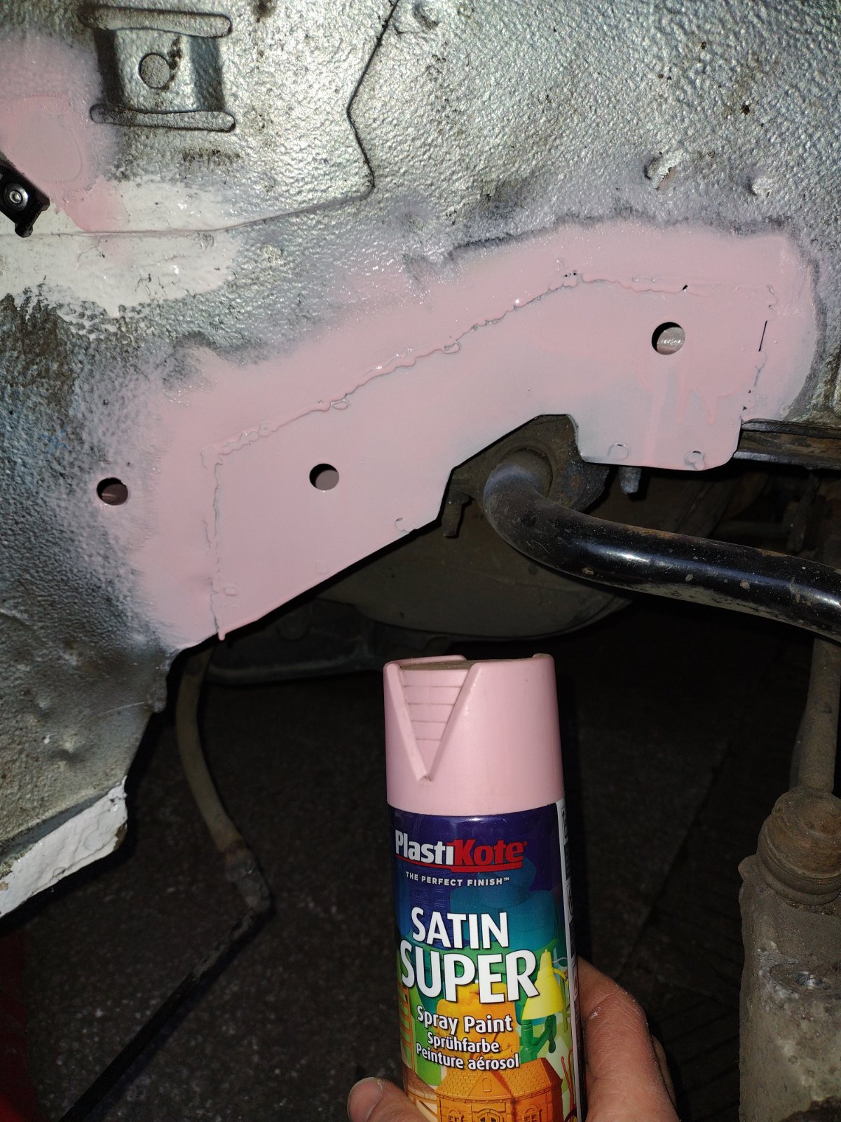

Welds tickled with the flap disk and yucky pink quick spray job to keep the rust off (and a good squirt in each of my new Waxoil holes too) Sadly loosing the light so need to off-road the welder again and pack up.

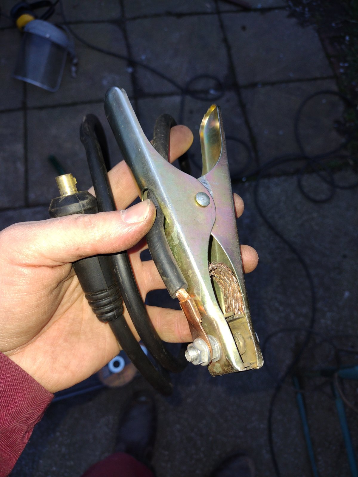

This one: Came with the welder, works well (lead quite short though to be honest)

Barbie woz ere ! Long as it keeps the rust off it all that mattersMattBLancs wrote: 03 Feb 2024, 16:48 Think with me there's probably a line about "if it squeaks, grease it" !

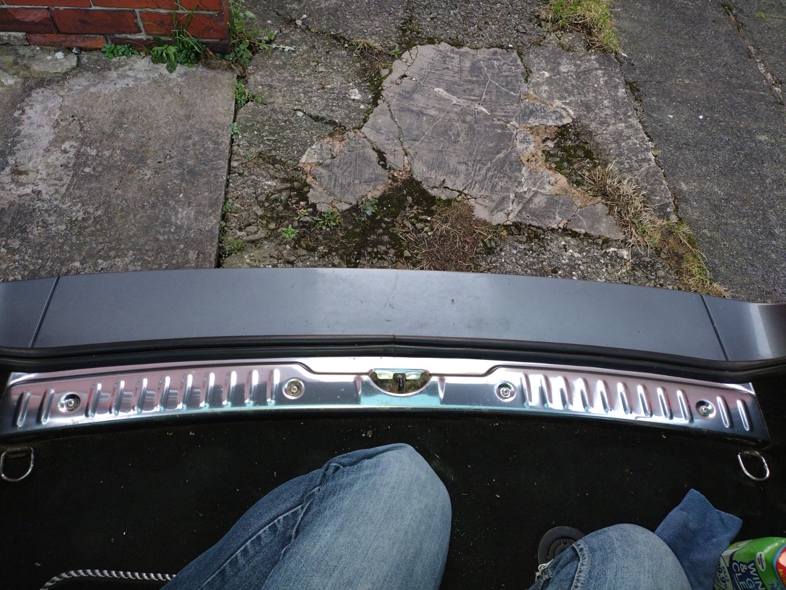

Boot sill trim piece - stainless steel - the raggedy piece of protective blue film it came with new peeled off. Considering this is supposed to be removed when new, I think the blue stuff hasn't done badly since 2011!! The right hand tie down point was wobbly, but straight forward fix = tighten the Torx head mounting bolt (under the stainless trim)
