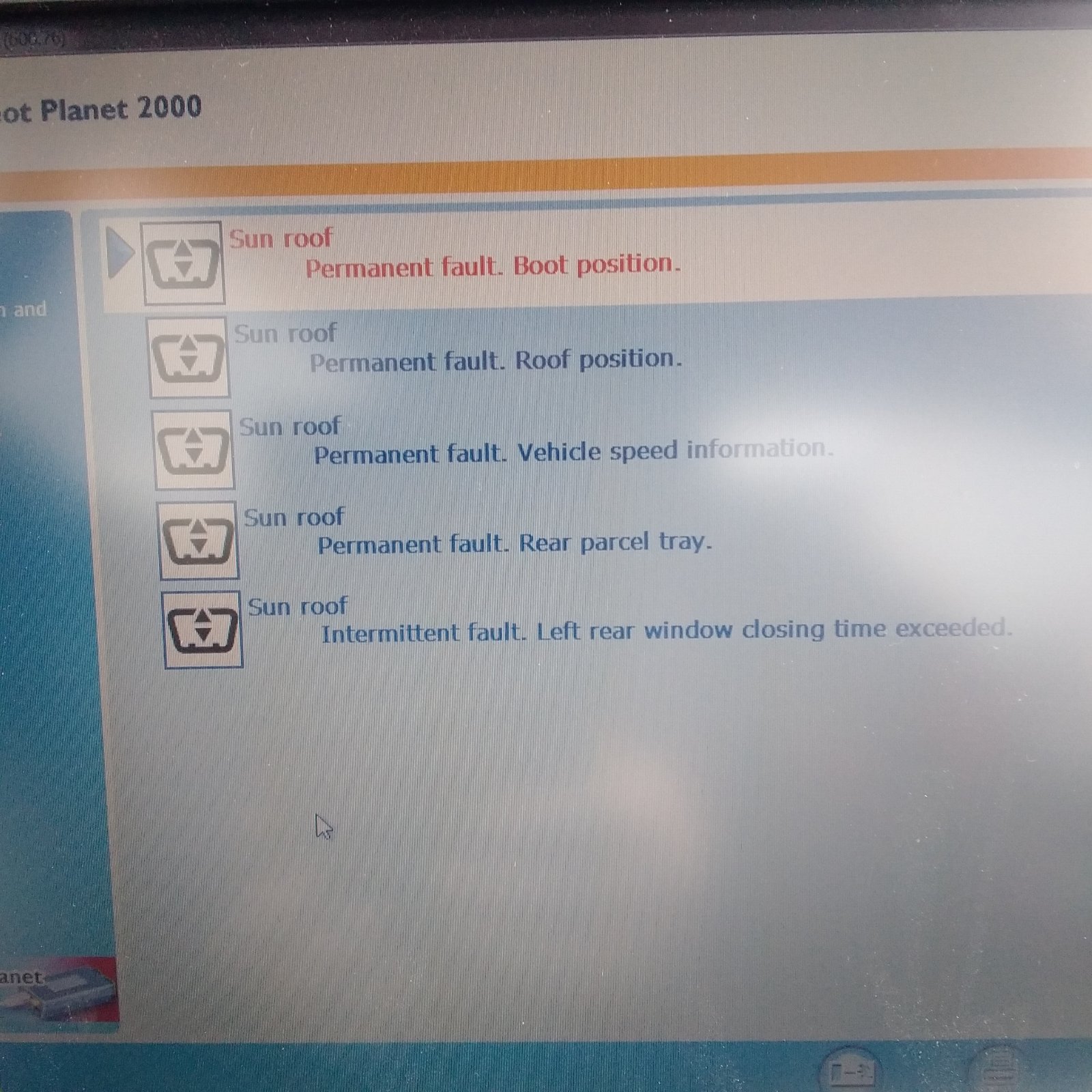

So today i plugged pp2000 see photos attached then decided to clear these faults & try the roof off thingy again hey presto ! Working again, I did open and close the roof about 7 times as it was noisey the first time but by the 7th it was back to normal. How ever when the boot lid locks it locks left side first right side second. I can live with that & are now much relived the roof now works , I will mot the car May or June then the heavey old 307sw can have a rest.

The missing photo of faults
Reason: Photo added

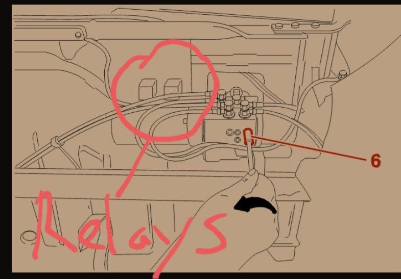

Only thing i found showing location of said relays.
Just incase anyone else may have same issue.

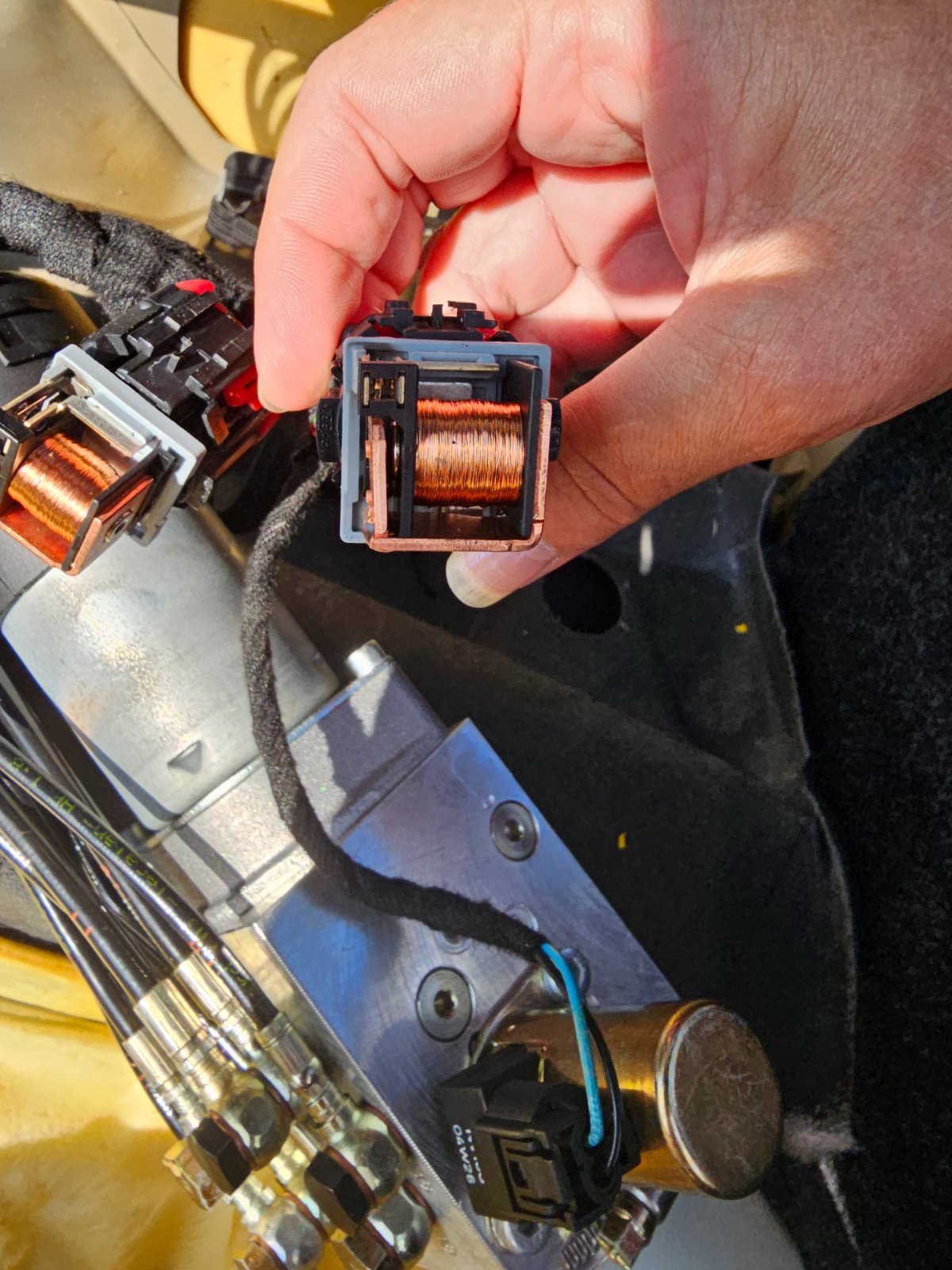

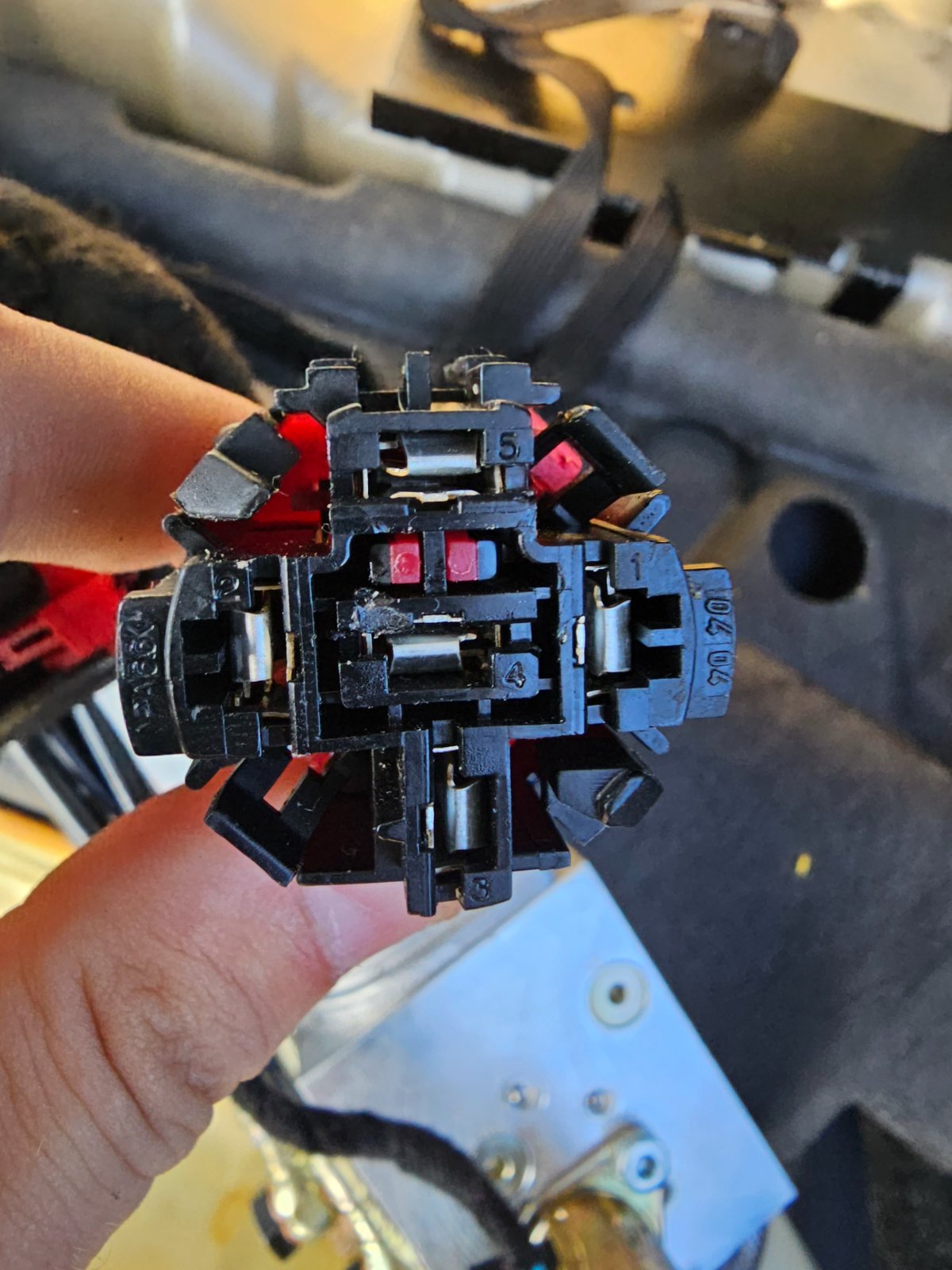

Hello mate I'm with my mums car now, I have split the relay but not sure we're I should be pushing to make the lock work I will try attach an image. Thanks again
Michael1994
- Posts: 4
- Joined: 08 Sep 2023, 11:46
Re: 206cc roof issue & fix.
I have popped cover off now I think I was in the wrong part of the relay, the only thing I can see is a connection on the side I have tried pushing it to make contact in both relays and neither are doing anything.
