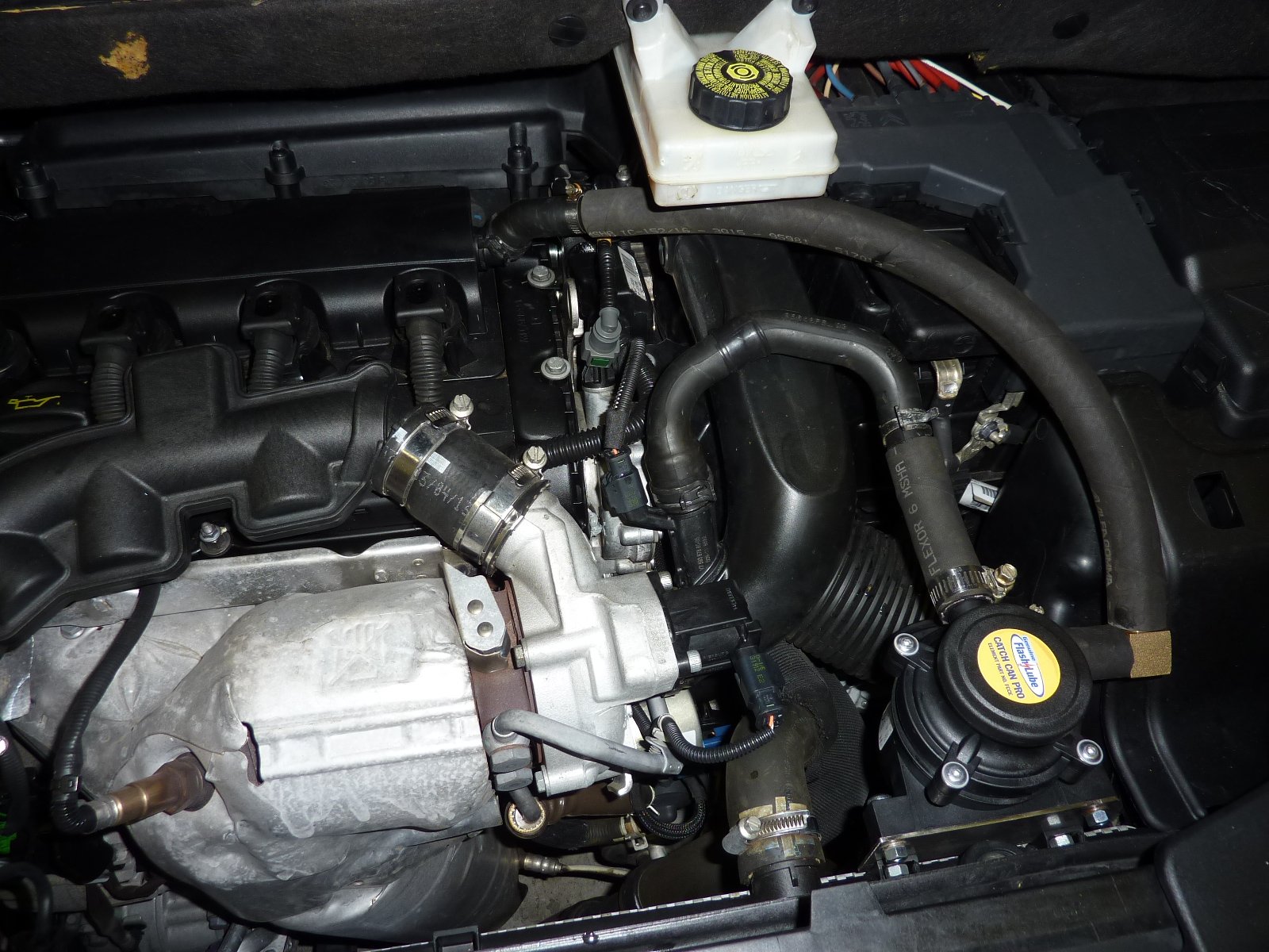

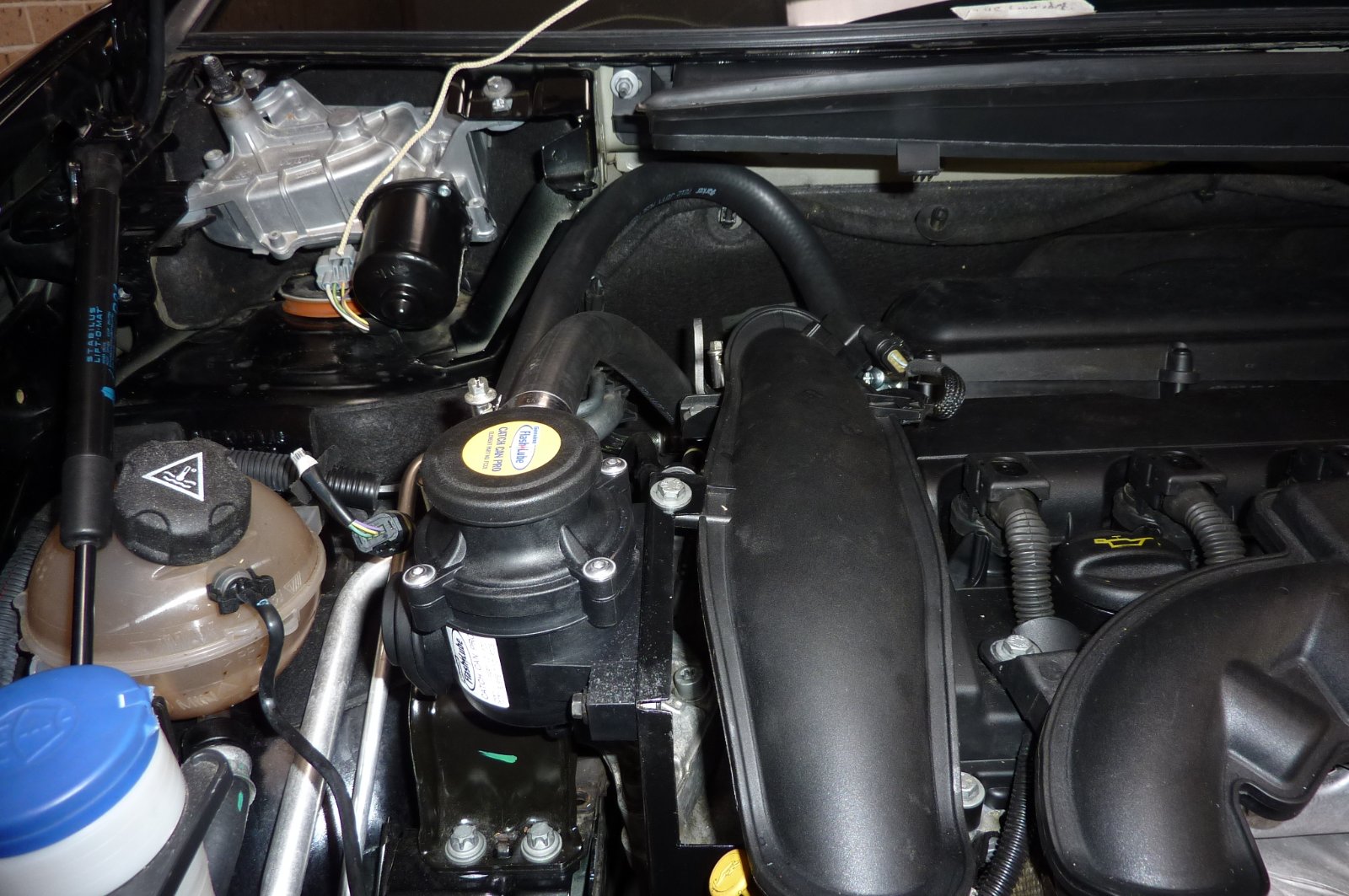

On my 2013 DS5 THP155 I installed catch cans on both breather circuits. The turbo inlet can was mounted on the radiator on a simple plate, but the intake manifold required a more complicated bracket at the end of the motor. The big mistake I made was putting a non-sealed can on the intake manifold side- it blew off the pressure release valve no doubt because of the turbo boost. And if I had read the OCC instructions more carefully I would have realised it was not recommended for circuits with boost. I replaced the one shown in the photo with a sealed unit. I get as much as 10 times as much liquid in the intake manifold circuit, the equivalent of ~500 mls per 10k km. But I still get oily smells from under the bonnet so I would suggest getting fully sealed cans for both circuits.
my own photo
my own photo
my own photo
my own photo

I’m afraid I have not been keeping up with the forum of late so please excuse the tardy reply. I made the U-bend by cutting and rejoining the existing pipe although I am now a bit vague on what joiner I used.
