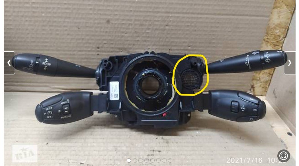

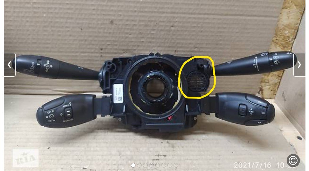

Re: Seat belt alarm, indicator sound not working
The tick sound & beeps come from the little speaker located inside the coms unit (indicator & wiper stalk assembly). Its not meant to be a seperately replaceable part but im sure if you are handy with a soldering iron it wouldn’t be to hard. I can’t imagine this has anyone to do with fuses as this would affect everything else that goes through the comms unit.
Thanks.. I have taken a look in that area, but could not identify anything that resembled a speaker. Maybe I need to try harder
Or open up a friends C4 and locate the source of the sound on a working unit.
At least I now know roughly where the speaker is... that helps!
It may not be immediately obvious as the speaker is an integral part of the unit.
I know this pic is not from a C4 as they have the fixed centre steering wheel type but it was the best pic i could find showing the speaker just to give yo an idea. You may have to remove the unit to see it
