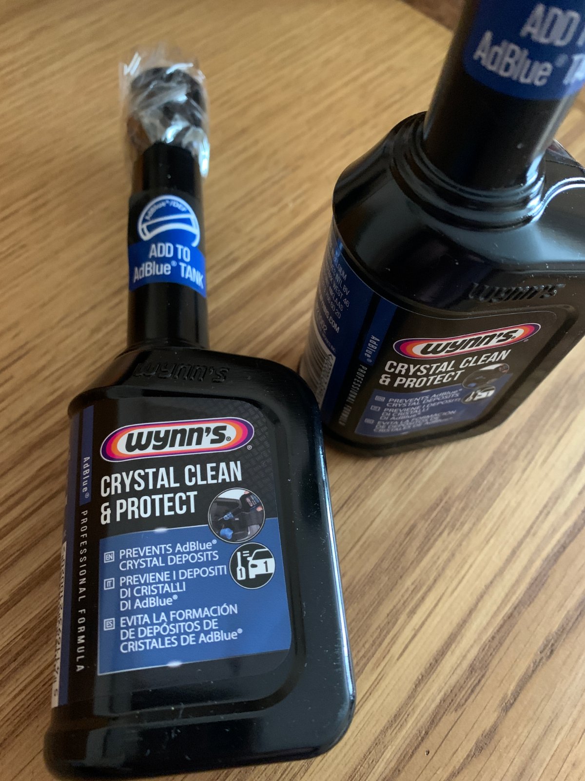

I've also ordered a few bottles of Wyn's which has just arrived.
I plan on adding the necessary quantity for a full tank (17 litres) to my filling jug and then top up the Adblue tank. Then in future, I'll dose the new 10 Litre retail Adblue container with the correct amount of Wynn's and just continue topping up the Adblue as normal, knowing it has the anti Crystallisation additive in the mix already.
