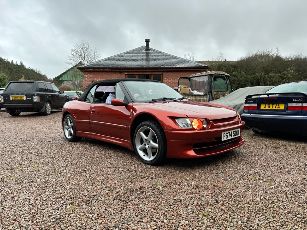

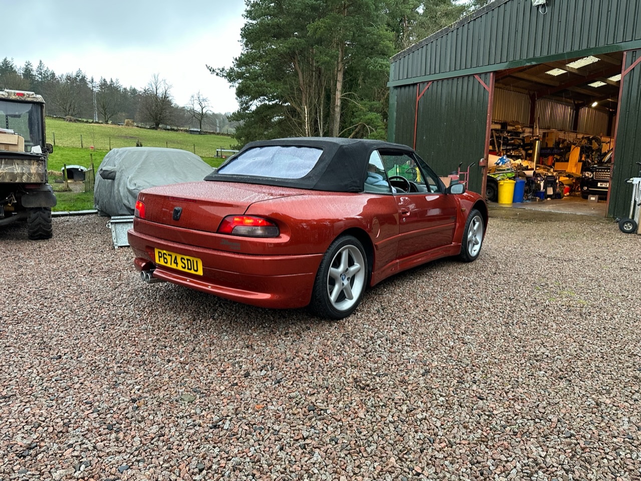

I spent a few hours today trying to help a friend out.
He’s got an incredibly rare 306 Cabriolet. It’s a genuine Dimma. 1 of only 2 ever made. It’s the one that featured in the Max Power magazines back in the day. It was originally yellow but when he got it the paint was trashed so he repainted it. It’s stunning and ever since he’s been here I’ve been looking at 306’s again. My first car was a 306 and it’s reignited that love.
The car is a Phase 1 306 but it’s been transplanted with a Phase 2 306 GTI engine, loom and ECU.
The car is bogging down when trying to accelerate and smells as if it’s over fuelling. It does accelerate but it feels very flat and has very little get up and go to it. Nothing at all compared to what a GTi6 engine should go like.

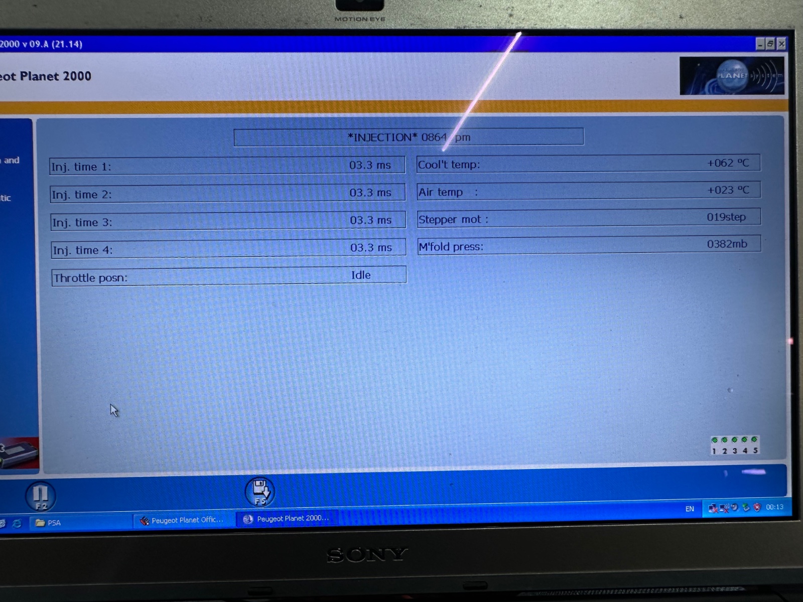

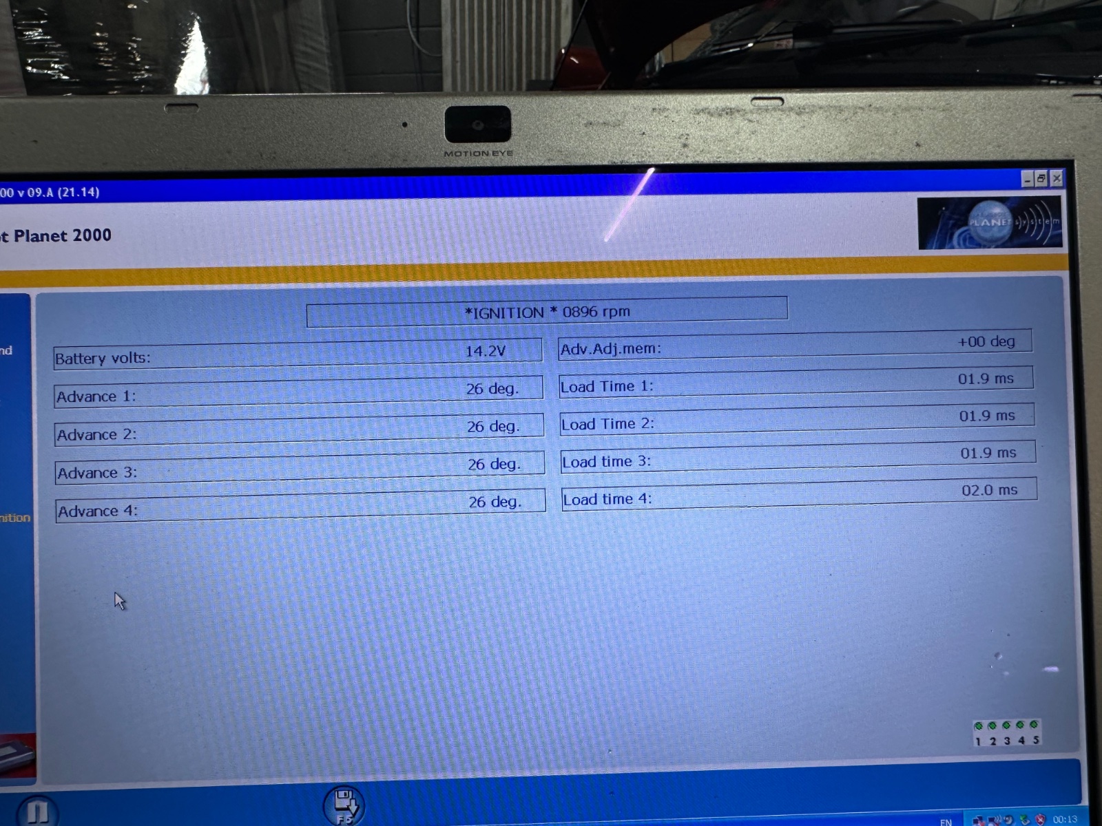

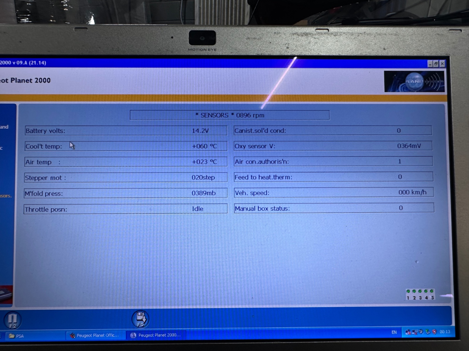

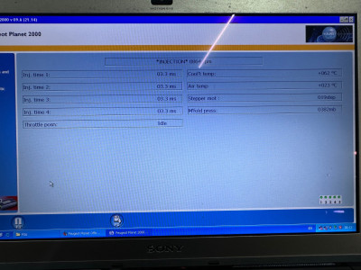

Then using the live data we managed to get the below information:
Ignition Values
Injection Values
Sensor Values
I thought the advance looked a bit high but we compared that to his other 306 GTi6 and it was identical. All of the other sensors were pretty much spot on when compared to the other car as well.
