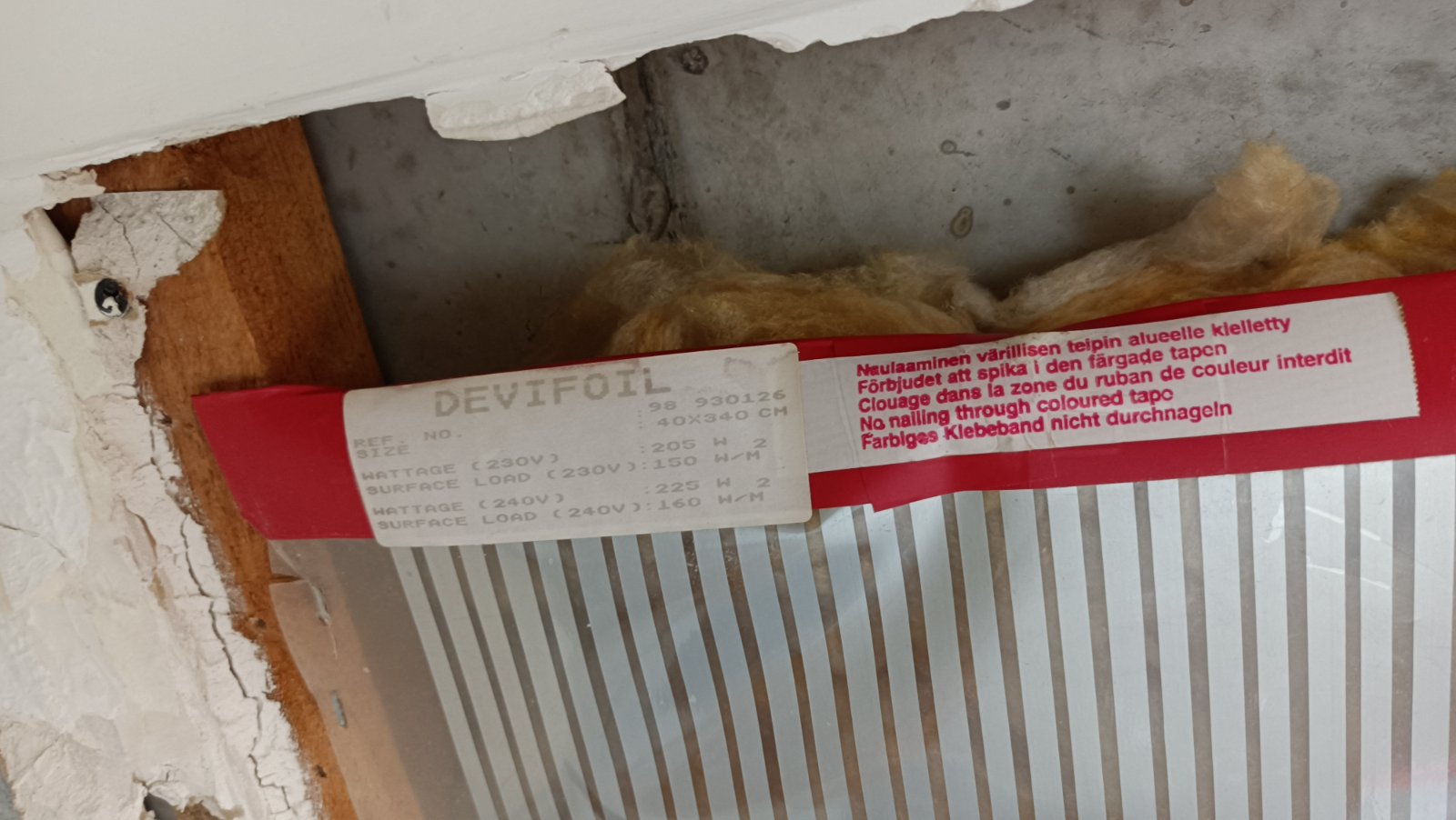

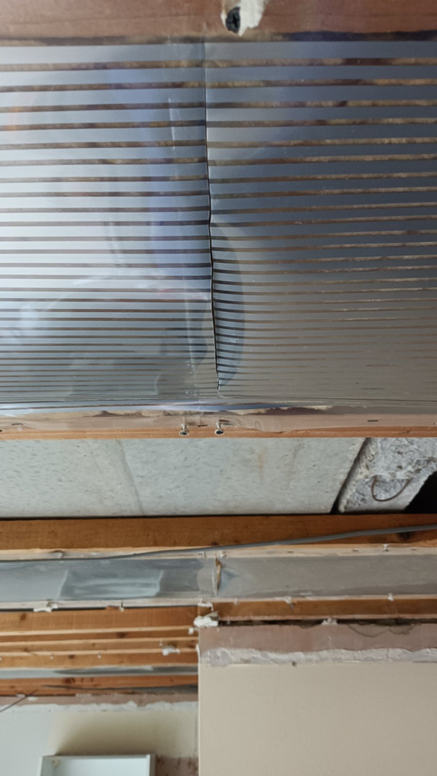

I got to investigate this recently. The heating system system was made by Devi (later merged into Danfoss).
The ceiling heating is controlled by an electronic thermostat on the wall. Turning the knob on the thermostat brought on an LED and a relay could be heard to click, but an infrared thermometer did not detect any warming.
A quick check found that the relay is faulty and not actually passing any current. A resistance check and quick calculation showed that power dissipation of the elements would be about 250W, which is much less than I expected (1000W - 1500W).
Yesterday I got around to dropping the ceiling. My first look at the heating elements was: And when the whole ceiling was down, there were 3 of those strips, giving a total power of 750W.
Note the neat line of the slice where someone has previously replaced a sheet of plasterboard. Perhaps after repairing the heating...
So the system has been running for at least 13 years on just one strip, and not at all since the relay failed.
I will be stripping it all out.

You are welcome to them. I don't see an easy way to repair the 2 that have been sliced, but you may think of something.

Really intriguing, never heard of those! Basically radiant panel.
Are the strips aluminium? Would think solder or even mechanically joined back together (e.g pop rivets) would allow them to live to warm another day??
