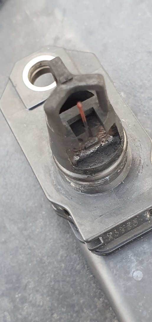

The X7 has some weird small shake while using few accelerator (cruising using few fuel) , so i've been trying to realize what may provoke that.
One injector was bad , so the 4 new were fitted (company car that needs to be fully operational , so when timing belt was done also got 4 new injectors , as the other 3 could fail in the wrong time)
Diesel and air filter is new. MAF was just clean on the exterior (See photo) as i was not sure i could send MAF cleaner inside without getting into some trouble.
MAP was also clean.
I noted some improvements , but continue to feel a bit of shaking.
Battery is also new.
Any clue on what may be wrong there?
