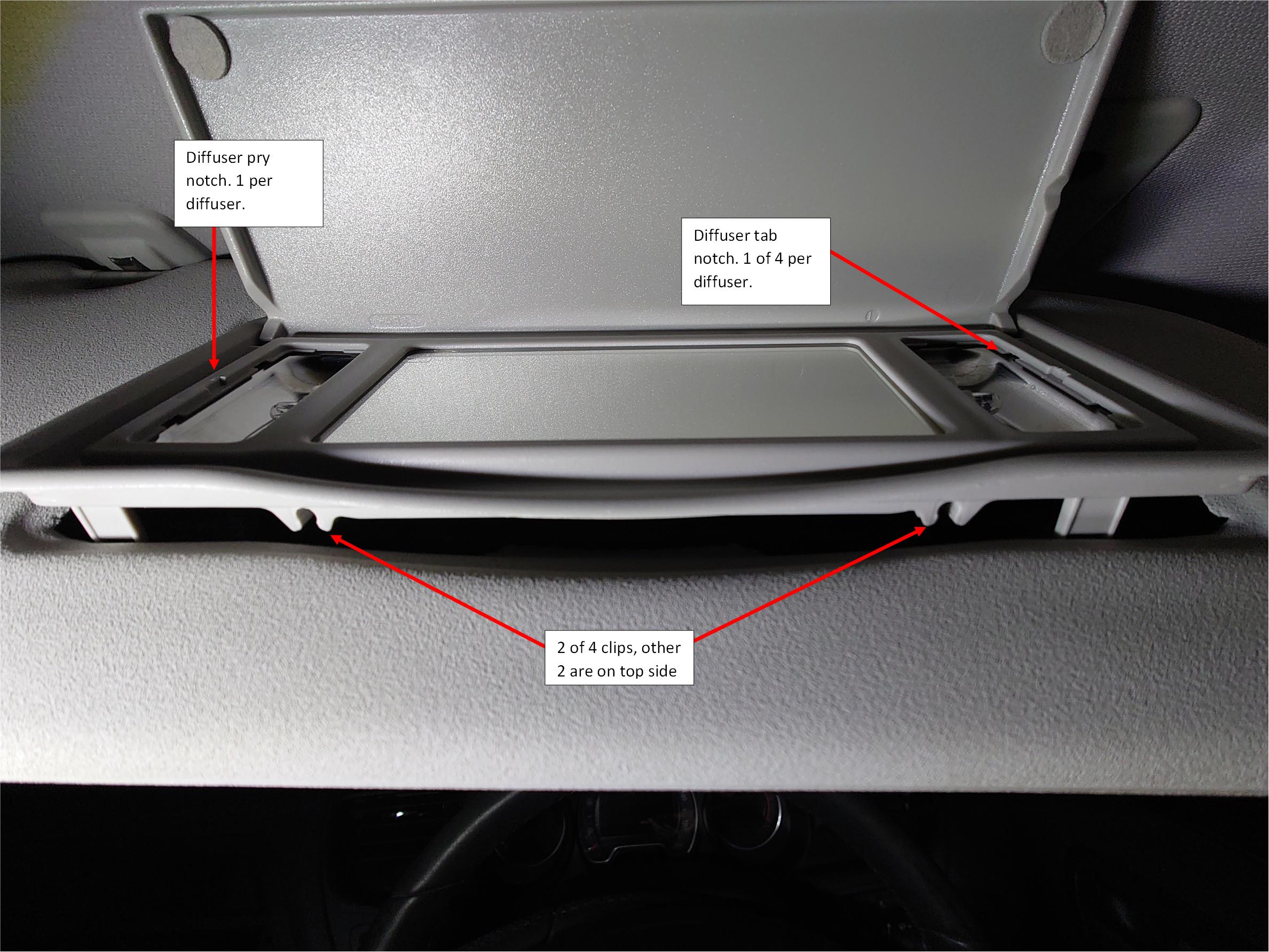

- Pry off diffusers. I had to carefully use a flathead screwdriver as my spudger was too soft.

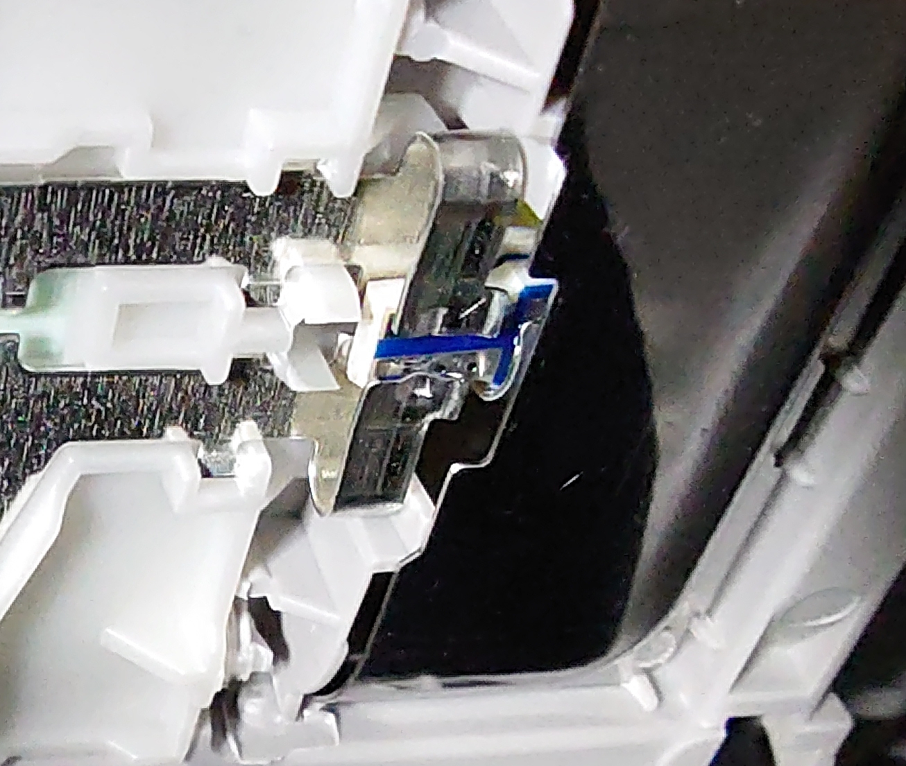

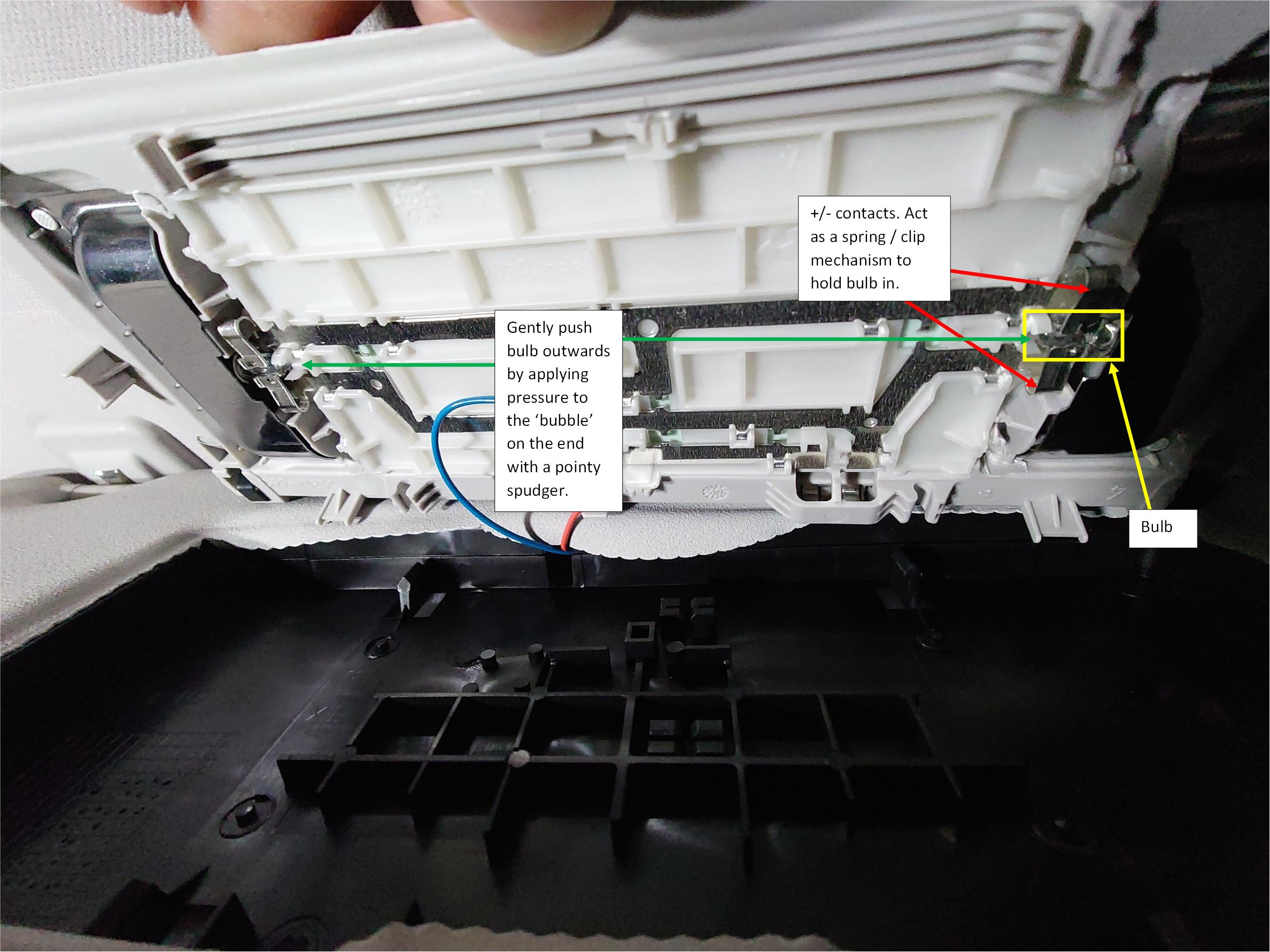

- Pry mirror / bulb module out of visor. I started at the corner and slid my spudger along the long side. When the last clips let go, DO NOT yank the module away, it has a pair of short, thin, wires soldered to it.

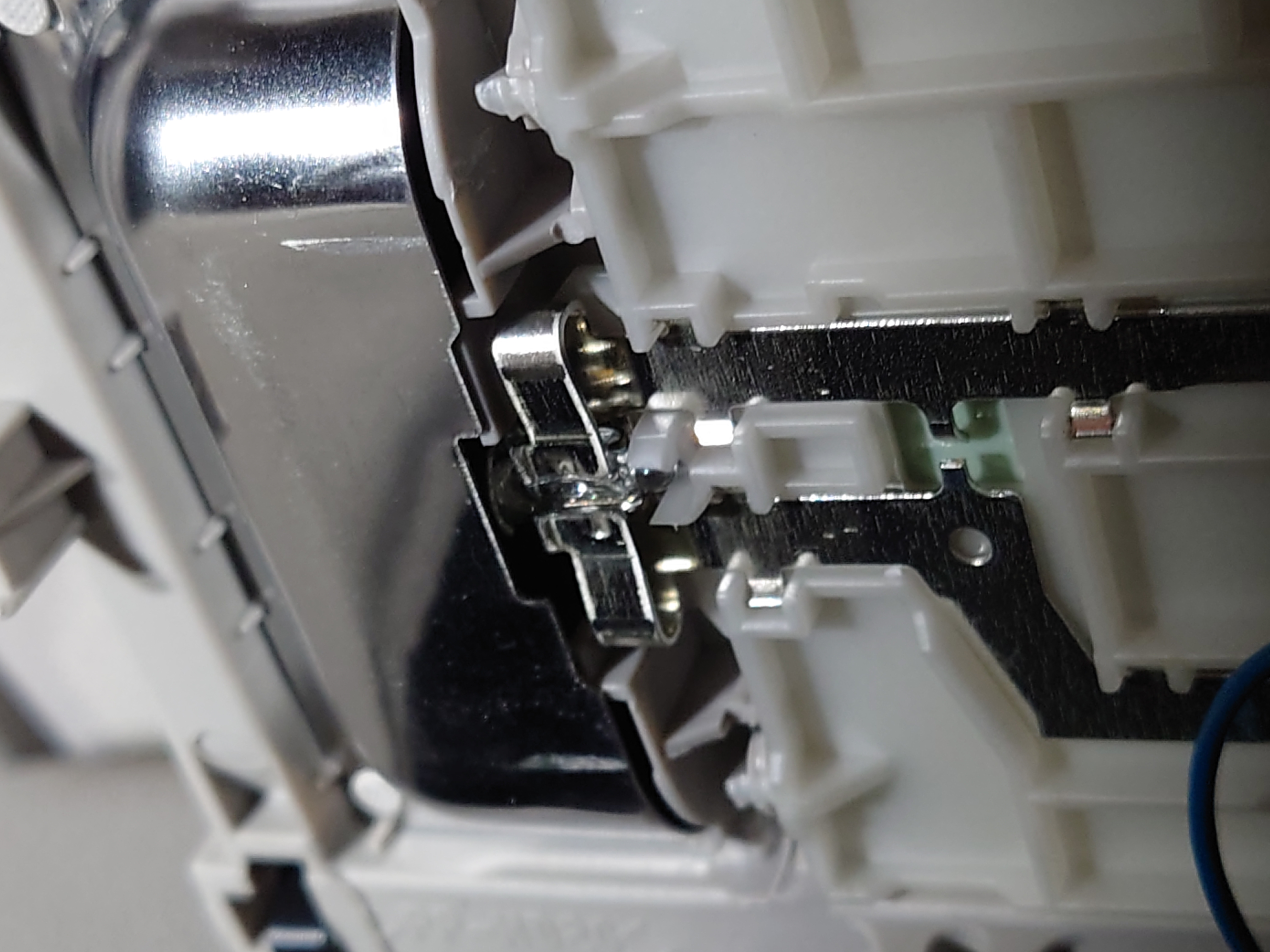

- Pop bulbs out from under side.

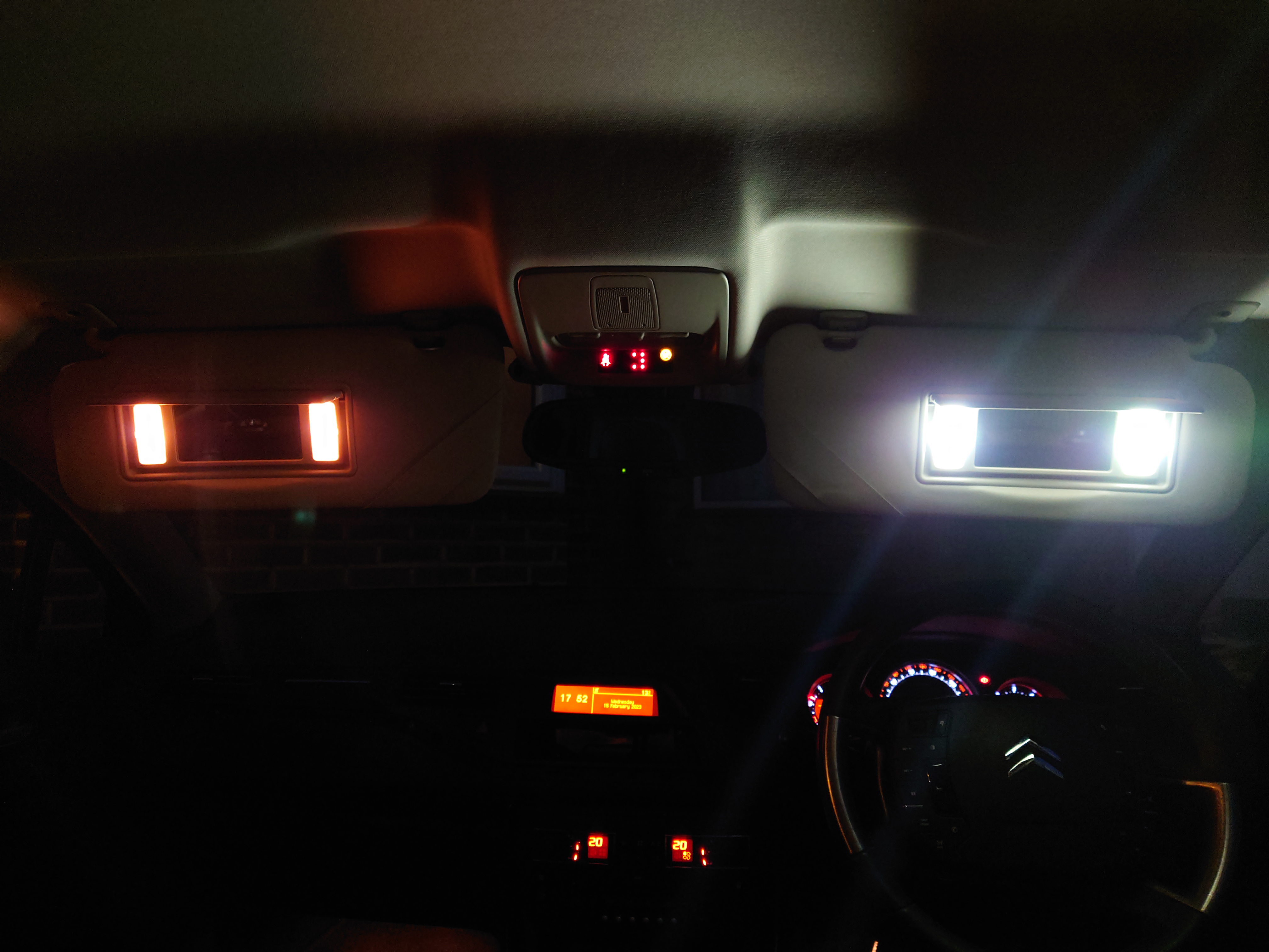

- Fit LEDs.
- Turn on ignition to check LEDs are lit.
- - If LED isn't lit, try moving it up or down a little, contacts might not be aligned properly (check underside of module to see alignment).
- - - If LED still isn't lit, flip it 180 degrees as they are polarised
