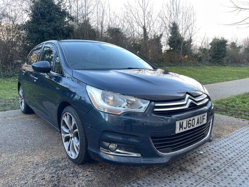

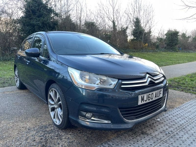

Both pictures taken from current Auto Trader ads relavent to post
1st picture MK1
2nd picture MK2

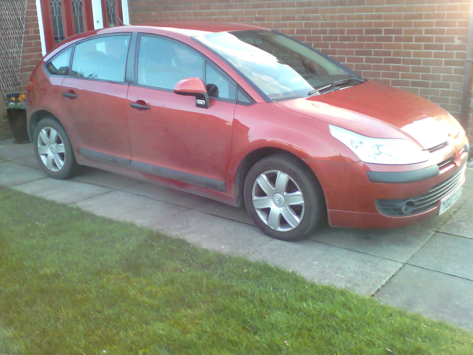

I owned a 2007 mk1 C4 in 1.6 HDi (110) manual, 5 door LX form. My dad owner it for several years prior to that (think about 5 years he had it, only about 2 years for me)
Engine excellent, reasonably nippy and very economical. Mine was no DPF, seems Citroen did some with, some without.
Fixed hub steering wheel good, swapped it for a leather version from a C4 Picasso. Cruise control a surprise given low spec.
Ride quality on the 16" wheels ok. Nice and quiet. Could do with a sixth ratio.
Only issue my dad suffered was a coolant pipe back of the engine split / chaffed?
Actually, no, he had the standard issue "boot wiring frayed where passes from body to bootlid" which gave rise to sporadic no boot access (stupid electronic button to release boot catch about 200mm away!
) and other weirdness until diagnosed.
I had gear cables snap (so had 3rd and 4th only, but it got me home and thankfully didn't kill the clutch in the process!) Also a dying battery.
Oh, also had a snapped front coil spring which went straight through the sidewall of the tyre when setting off to drive 100 miles home! Not a fun day that one!
Then I had a "chuffing injector" at the time too many projects on the go, so sold it on "spares or repair" for a pittance.
The buyer said it was fixed but checking the MOT history suggests it didn't do another year after my ownership. So not sure what killed it off in the end.
Was a good car but never really "got under my skin"
Had around 160,000 miles on it when I sold it I think, so did well in that regard
