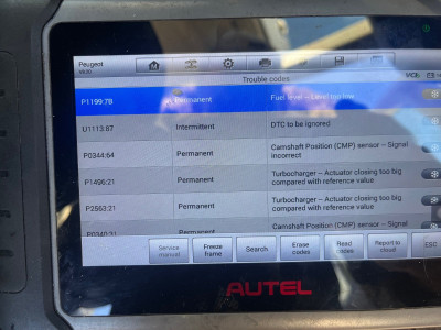

Hi I am wondering if anyone can help me I have a Peugeot boxer 2019 2.0 euro 6 it keeps coming up with the faults in the photo . I have changed map sensor , turbo boost sensor , engine wiring loom , turbo , all vacuum pipes , egr and throttle body . Any help would be greatly appreciated as it’s about to find out what a can of petrol and a lighter can do to fix this problem

I deleted one of the images as it was showing the exact info as the other one.

Why have you changed the MAP sensor when it's telling you the Camshaft Position sensor is faulty?

Re: Nightmare Peugeot boxer
For the turbo faults to see if it helped at all
It’s also had a new cam shaft sensor and has the Feeds it should to the sensor but saying incorrect data or cam shaft can’t be detected
It was taken off a running van I have about 10 boxers and the sensor off this one run on that
So what is the actual fault with the van? Non starter? rough running? loss of power?
Goes into limp with the 2 turbo faults
Have you tried a mityvac on the wastegate actuator on the turbo & make sure its moving freely & holding vacuum?
