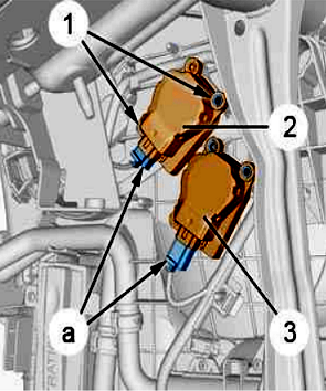

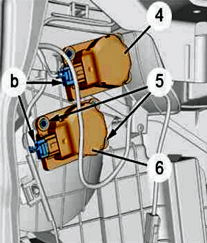

Unlikely. The heater system consists of air distribution motors and air mixing motors. It could be several things such as either one of the air mixing motors which as left the mixer on one side in a fixed position. If this is the case it could be either the motor or the spindle / gear from the motor that moves the mixing flap.
Diagbox should be able to confirm whether the specific motor is responding to commands using the appropriate live data parameter. If it is registering the motor movement, then that would indicate that the actual motor is operating, which could then leave the spindle / gear as the fault.
The other possibility is a blocked heater matrix. When this happens it can lead to blocking of one side. To rule this out, try setting the cold A/C to the opposite side with the problem. If that is working and changes back to hot when commanded on the same side, then the matrix is likely OK.
Right Side
Distribution Flap Motor = (4)
Mixing Motor = (6)
Left Side
Distribution Flap Motor = (2)
Mixing Motor = (3)

So caution here - as sometimes they refer to left / right which makes it easier to know which side they are referring to, but in terms of 'passenger' or 'driver' when it comes to info, it may mean they are talking about the driver's side on a RHD vehicle...
So if this is the case you may be in luck if the actual reduction motor is the culprit. It's quite rare that the motors fail, more often being the internal gear they attach to, which often means a major intervention on the heater assembly itself, as in dash out most likely.
Fingers crossed that as Lexia states it is actually the motor though, which on the UK driver side means you need to disassemble the driver's knee airbag unit to get access.

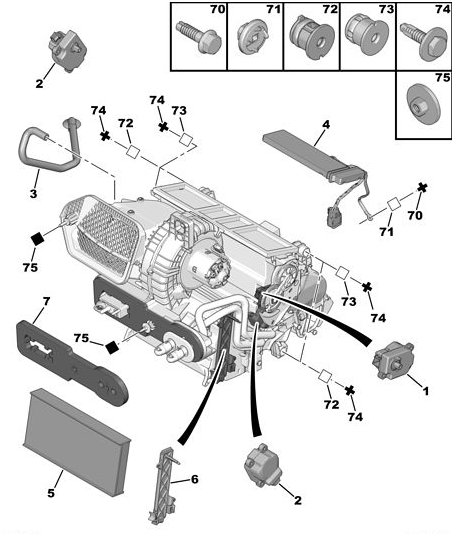

Parts Diagram showing the motors
So if this is the case, you would be looking at the right side mixing motor in my previous diagram (6) in my previous post, which should equate to motor (2) in this parts diagram below. Part number 6447RJ, £127.44 inc. VAT from Citroen.
