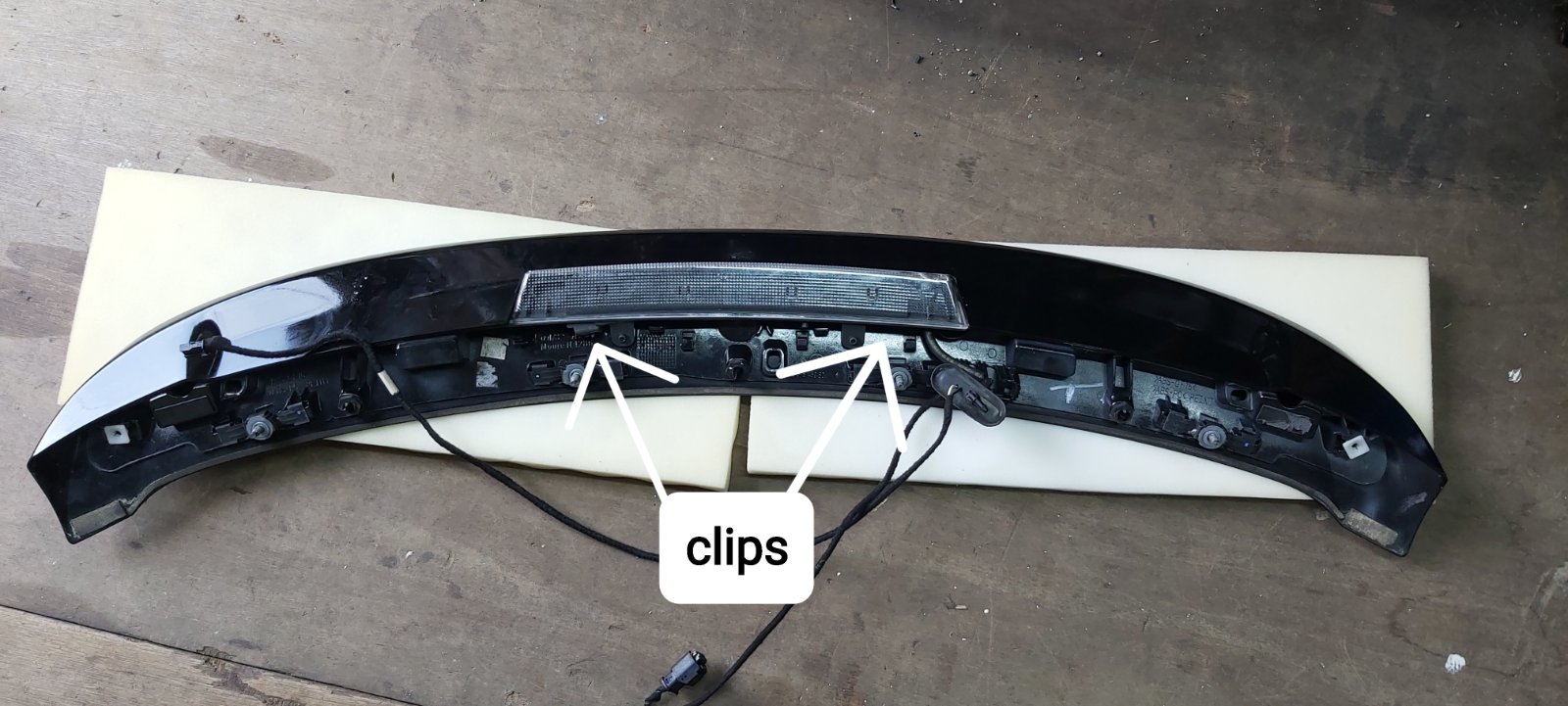

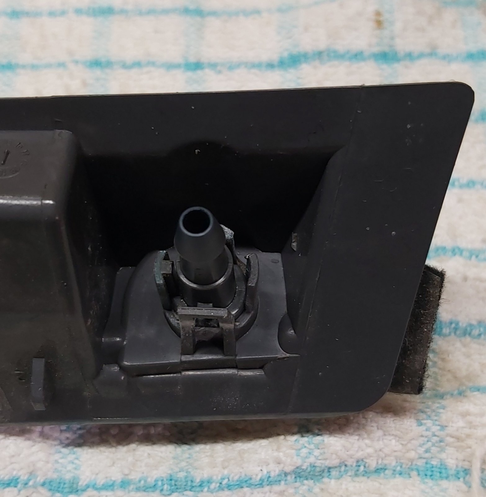

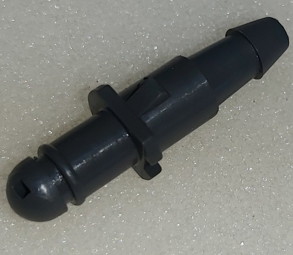

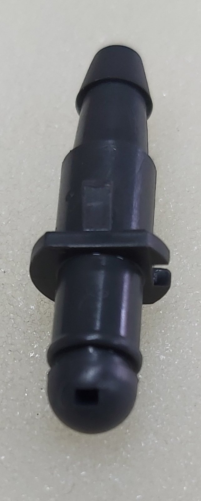

Hi,
I finally took mine apart and have attached pics of the jet and how it sits in the light fitting. Cleaned my jet but still doesn't spray properly. I've tried to source a replacement but nothing on the net showing up. If anyone knows the part number for just the jet please let me know. I have more pics of the trim pieces removed if you want me to post them. Trims were quite well fixed and took a bit of wrestling to get off. Beware when removing the light from the spoiler as there were 2 plastic lugs which I missed and consequently snapped, but didn't affect the light being held in place securely (shown in photo of spoiler). Let me know if you want the pics of the other trip pieces. Good luck
DS5 dsport blue hdi 2ltr diesel Auto 2015.
No job too small, no hammer too big
Big Dave
- Posts: 33
- Joined: 07 Feb 2023, 21:45
- x 3
Re: DS5 REAR WASHER JET REMOVAL
Apologies the clips I broke were on the inside of the torx screws, not to the outside as shown in the photo of the spoiler (I'm not that good at editing pics on my phone ).
