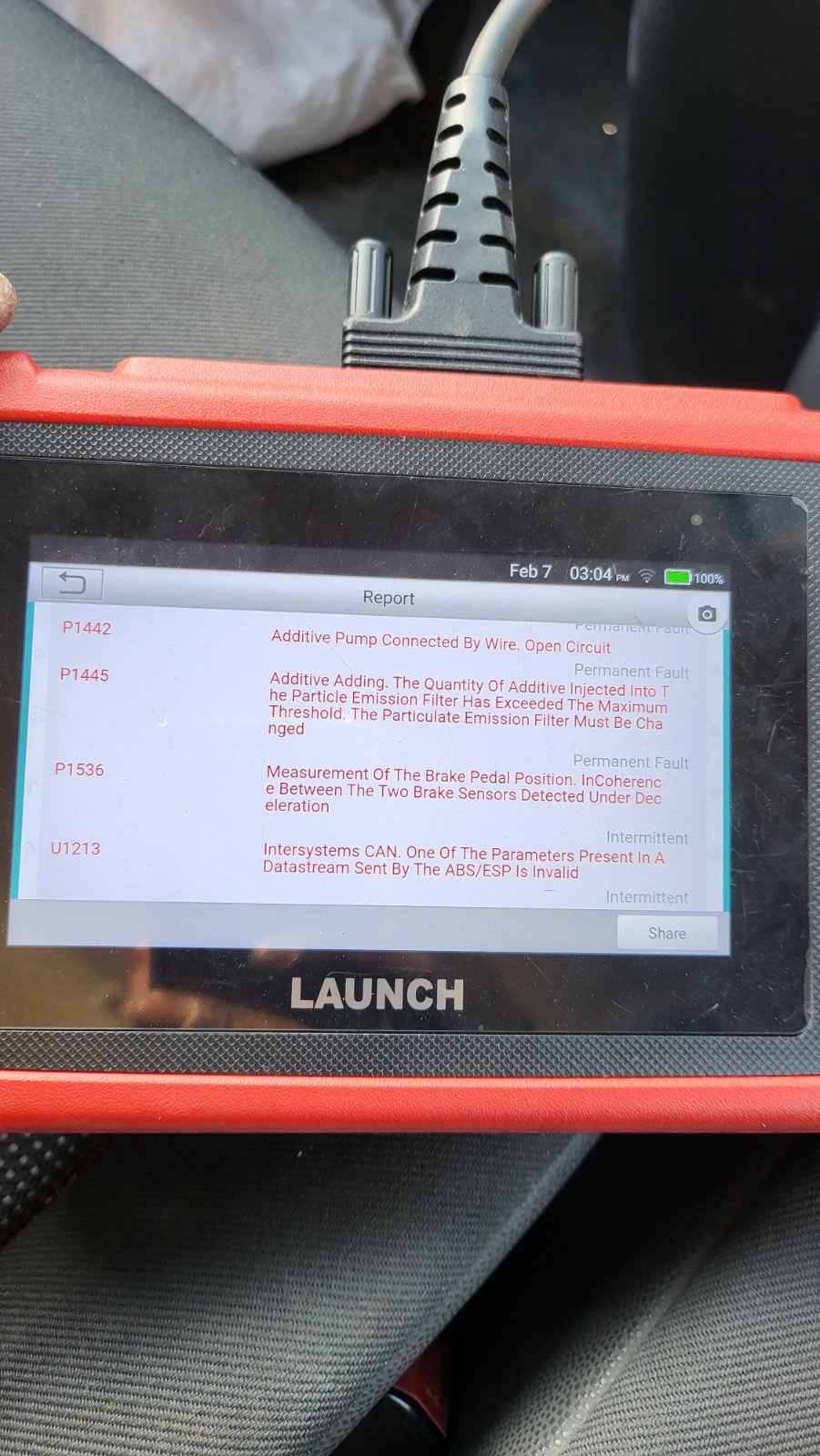

I have a Citroën dispatch 1.6HDI, the engine warning light was on, with a P1352 fault code. I found what the fault was. It was an earth strap loose on the back of the cylinder head. The 10mm bolt was missing. Since I secured the earth on the back of the head and cleared the related DTC. It has cleared the P1352 code.
I'm now left with the following fault code:
P1442 - Adaptive pump connected by wire open circuit
P1445 - Adaptive the quantity of additive injected into the particular filter has exceeded the maximum threshold.
The vehicle will not exceed over 40mph, its as though its powerless...
I have tested the 2 pin connector to the additive tank and I have a good ground with a 12volt supply.
Could do with some help on this any ideas ?
CITROEN DISPATCH No Power!

It's presumably in limp mode, but neither of those codes will cause it. If the power and ground is OK at the pump, then the pump is probably stuffed. The second one means that the DPF has reached its predetermined life - but it will probably be OK if you just tell it that has been replaced.
The one about the brake pedal is probably causing the limp - check on live data to see that both parts are changing at the same time, but it's cheap enough just to replace it.

Replaced the brake light switch still no luck, not sure the 4 wires going to the switch pins 1,2,3,4 what should I be looking for on the voltmeter ?

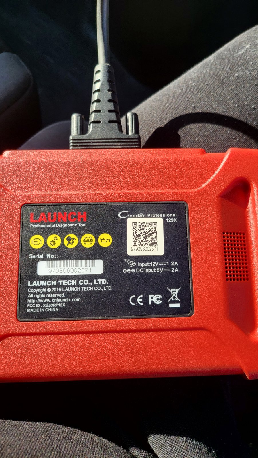

I can't help with your issues, but do you mind me asking which code reader you're using? I'm struggling to get any confirmation of something compatible for my van, same as yours assuming it's the latest shape?

I am using a launch diagnostic machine, I have attached the picture below. The vehicle model year is on a 63 plate.sibo wrote: 11 Feb 2023, 12:38 I can't help with your issues, but do you mind me asking which code reader you're using? I'm struggling to get any confirmation of something compatible for my van, same as yours assuming it's the latest shape?

You need to start looking in live data. What is the turbo pressure looking like, what is the air flow saying?

I rescanned the abs module and got 2 codes c1335 rear right wheel speed sensor signal and c1325 rear left speed sesnor signal.RichardW wrote: 10 Feb 2023, 17:58 It's presumably in limp mode, but neither of those codes will cause it. If the power and ground is OK at the pump, then the pump is probably stuffed. The second one means that the DPF has reached its predetermined life - but it will probably be OK if you just tell it that has been replaced.
I need a wiring diagram if anyone can help?
