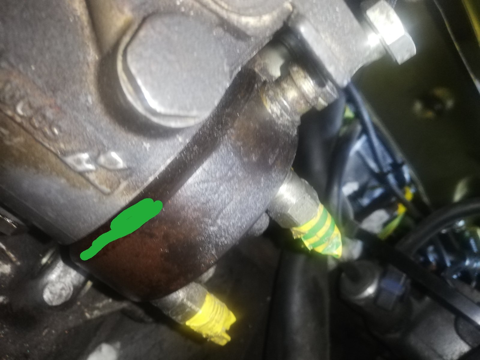

I was able to remove the armouring around without removing pump but unfortunately there is no leak. The diesel fuel is coming from the gap (green line)

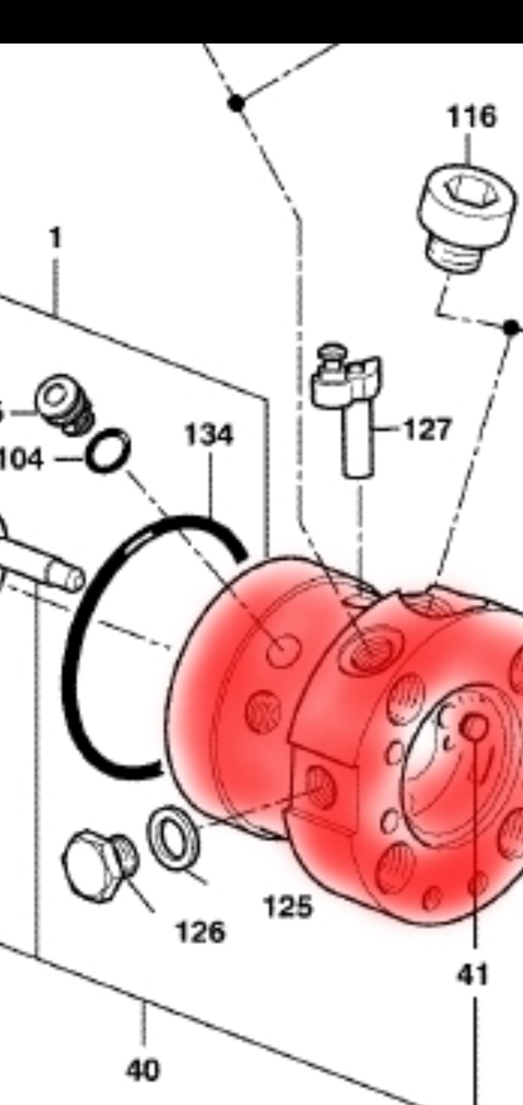

Is the leak from the gasket nr 134 or it might leak from somewhere else?
Thank you
Thank you

Good work on the de-armouring
134 is a good call but do be aware that leaks can originate far from where they ultimately appear... Diesel is good at creeping
As you now have the pump off, replace all seals wholesale, including the driveshaft oil seal.. The last thing you want to do is replace what you think might be the cause only to have to then do it all over again...
Be aware you may need to fabricate/obtain special tools to dismantle the pump and some quite innocent looking fixings can be very tight!
