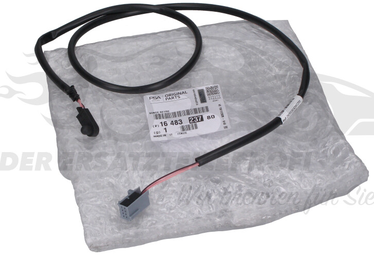

If it's the outside temperature, then the sensor is usually in the left wing mirror assembly. Pop your VIN up (please post your VIN in full without spaces - it will be automatically masked from public view after submitting your post & will only be visible to staff) and I'll double check as on some body styles it may be on the right.

Ok, so according to this, you may have 2 - one in each mirror as it's showing on both mirrors!
Look for a small dimple somewhere on the underside of the mirrors.

i have checked, there is one small dimple on the underside of the mirror but just on the driver side (LHD version)
I've opened the mirror and it's exactly like in the photo you provided.
I'll use the code from the photo to order it, thank you!
