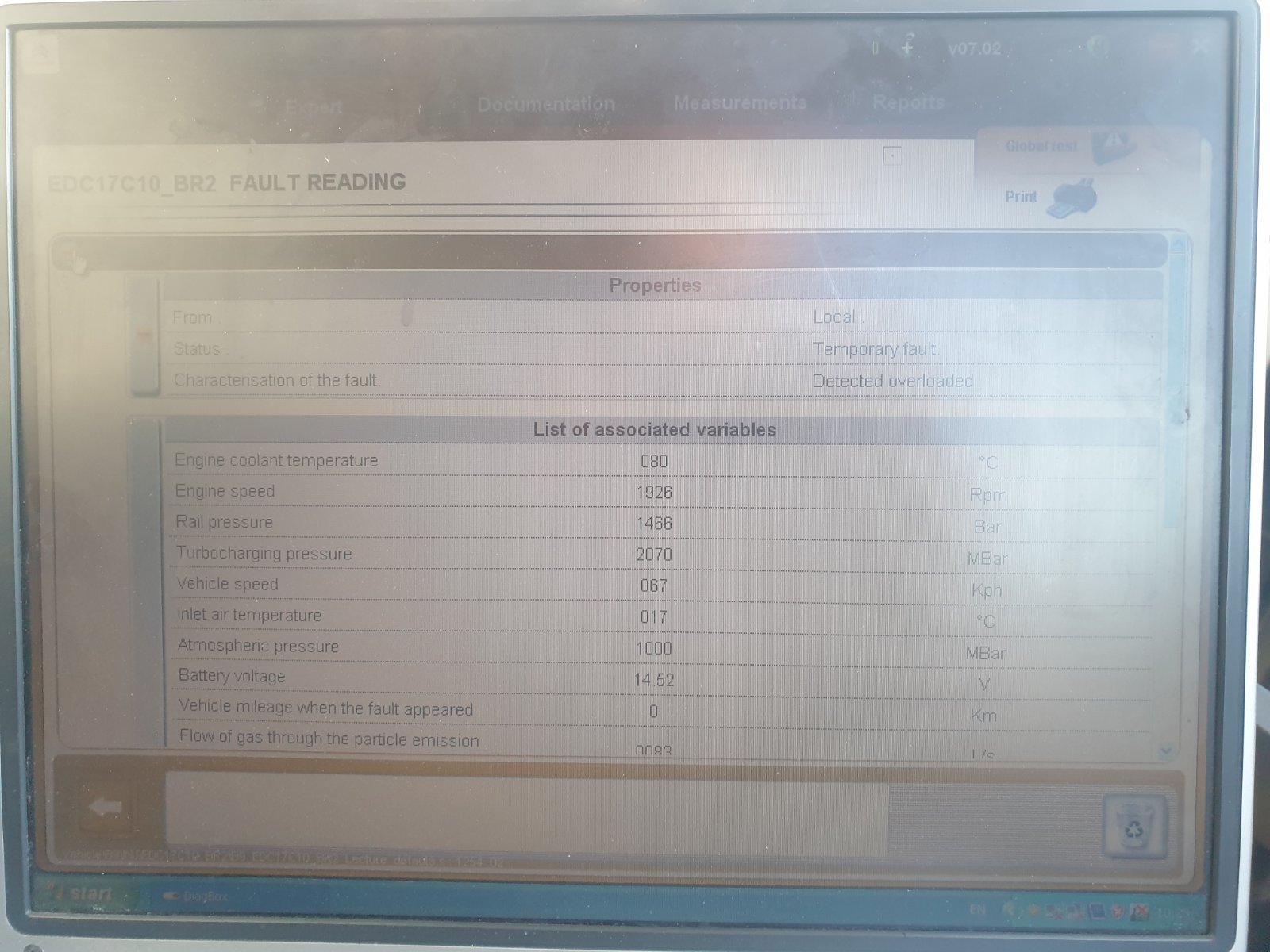

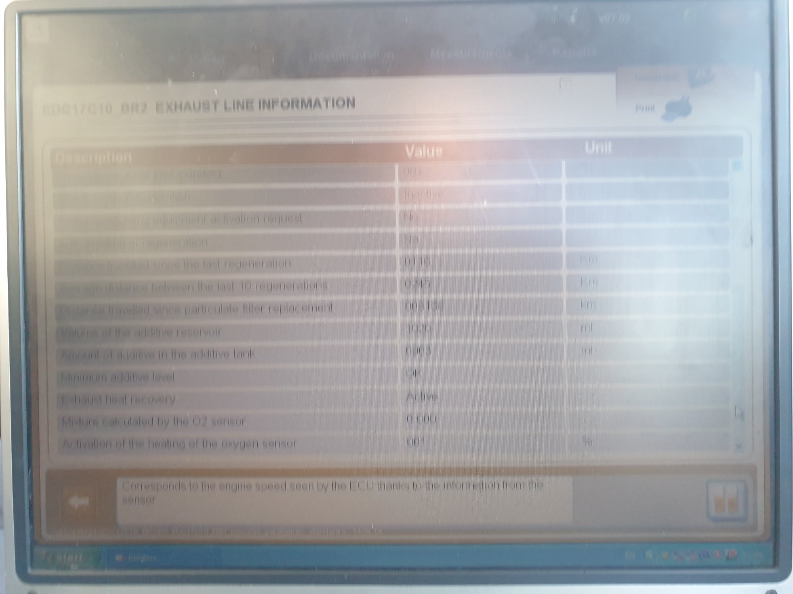

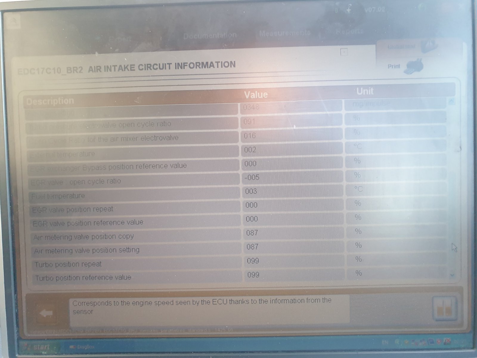

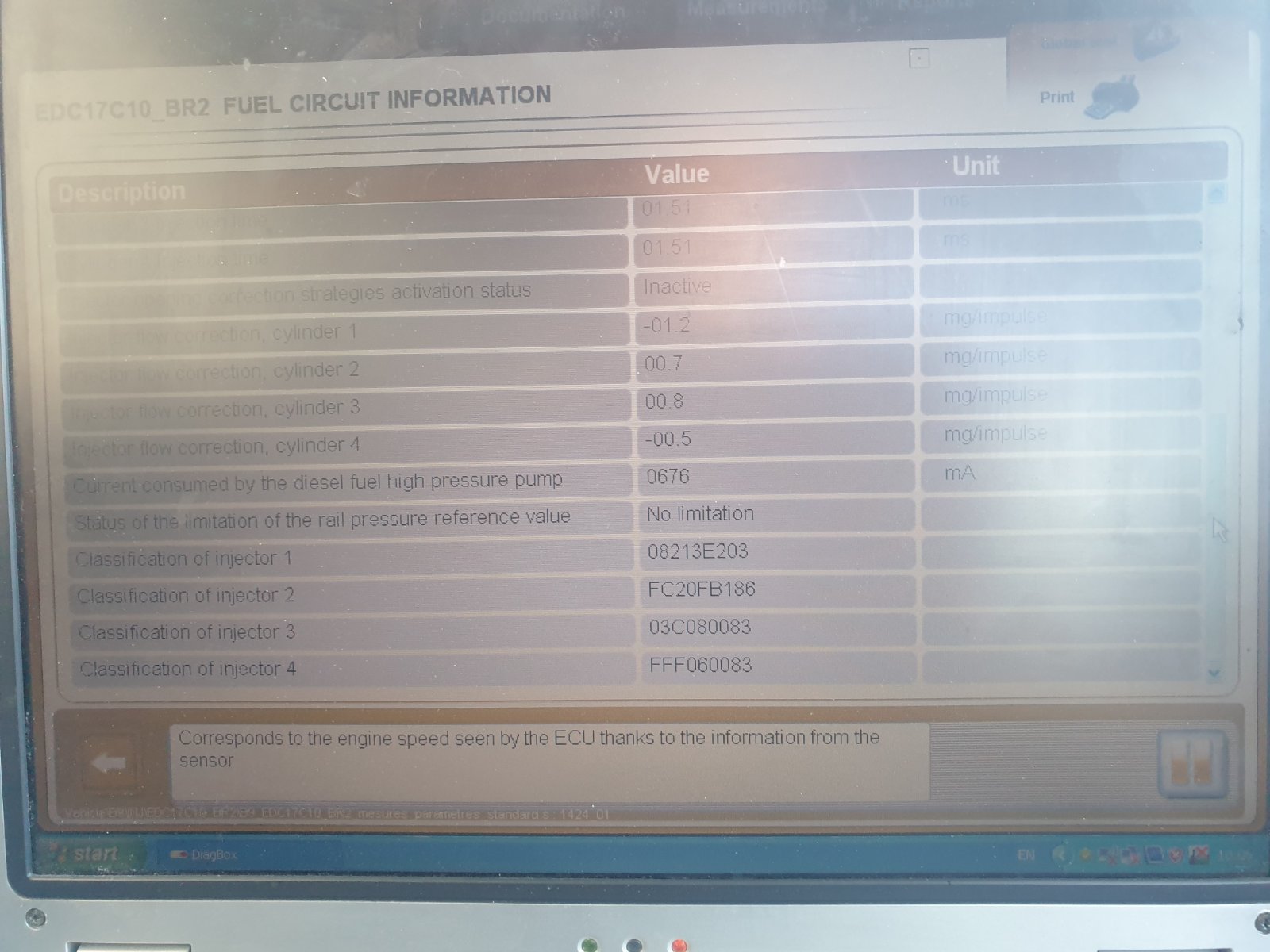

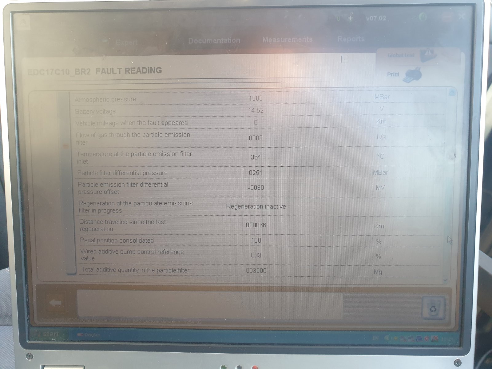

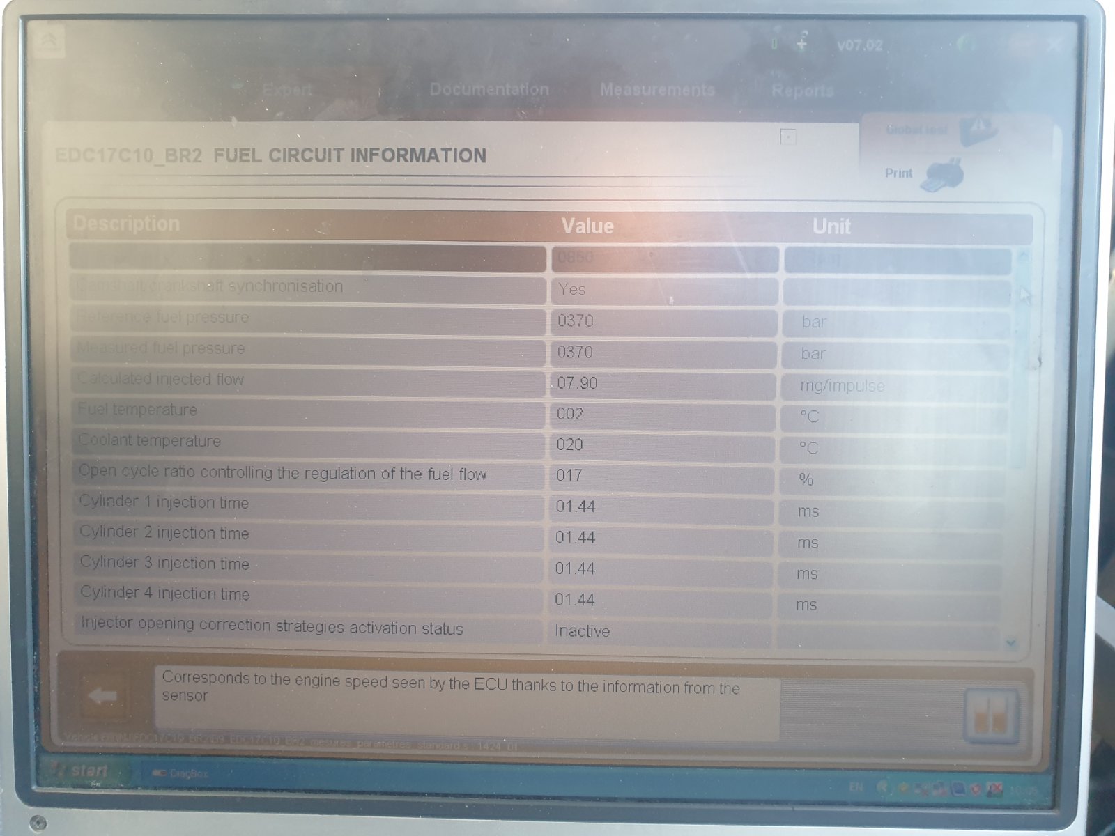

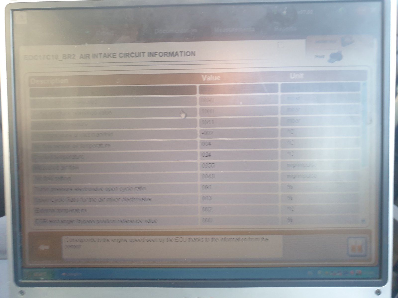

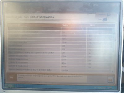

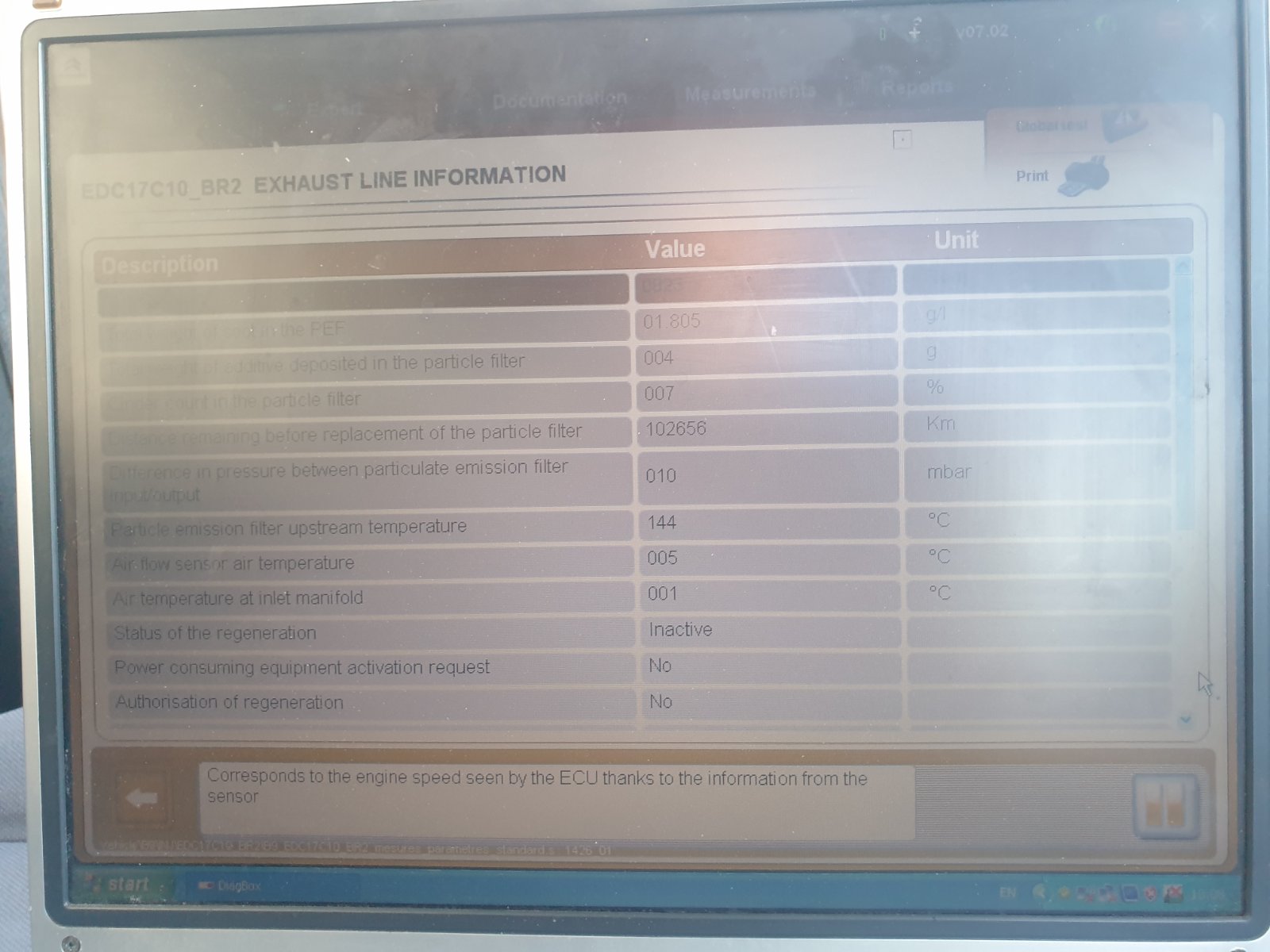

Ive gone into the pre-defined parameters.
Problem is a lot of the results dont mean a great deal to me.
Ive attached some pics (sorry for quality of images, but couldnt get the diagbox to print to file) and was hoping that there might be something obviously not correct causing the problem that a trained eye could spot, or failing that, some advice on what steps I can take with diagbox to point me in a direction to diagnosing the fault
Thanks again

Att 6, middle of the page it says 116km since last regen, average 245km / regen for the last 10. So it appears to be regenning, but given you are so far over the limit, I think it's possible the DPF has broken up and is letting soot through.

You need a bot of Windolene on that screen!
But yes, either you doing very short journeys or the filter capacity is reduced or as Richard says the filter may be damaged internally.

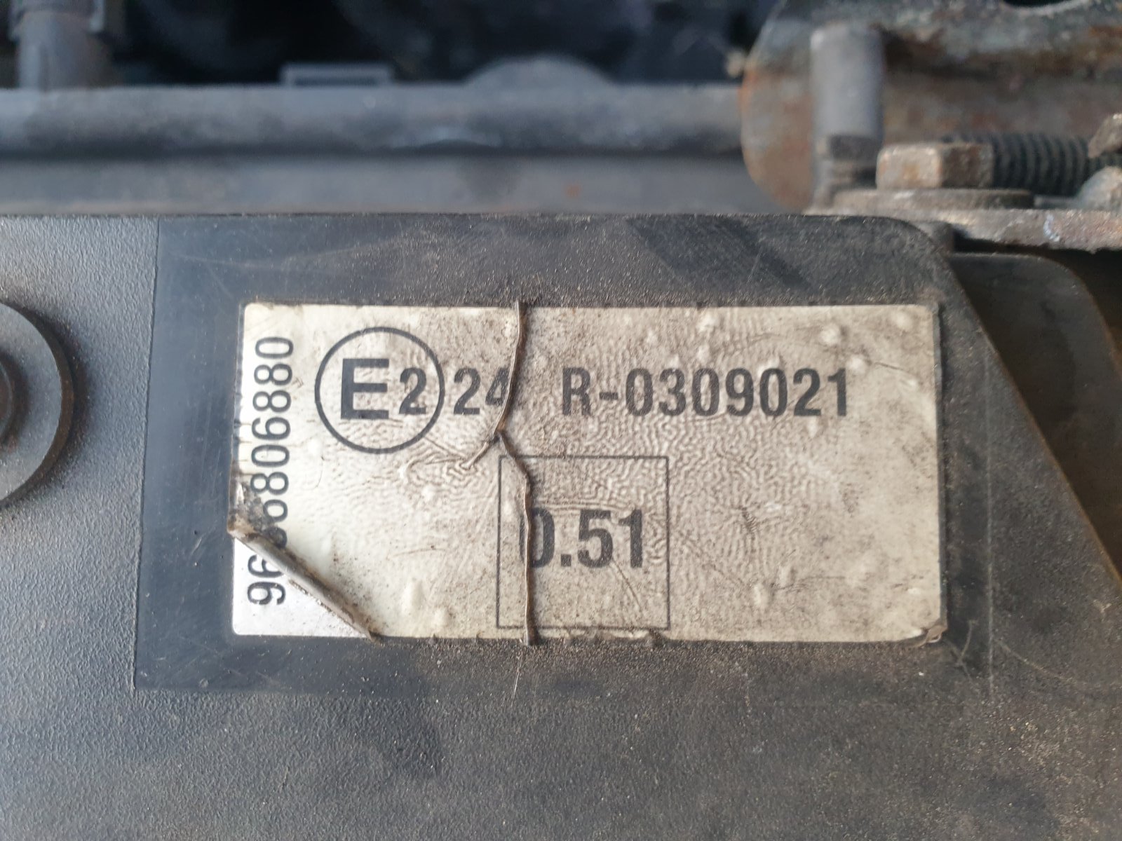

Please see attached regards testing - under bonnet sticker and test/fail result.GiveMeABreak wrote: 06 Feb 2023, 19:53 Be aware that if there are specific faults detected by the engine ECU, then as part of it's engine protection strategy, it can and will prevent manual / forced regeneration by a diagnostic tool. It seems from what you have said that this is the case.

Yes, I was just pointing out to check that there are no fault codes showing up that could prevent forced regeneration.
Ok, so I can't comment on the label but the opacity limit is shown on many vehicles on the metal plate with the VIN etc. However, you need to be aware that there are more stringent tests in place now.
As of May 2018 the following limits are in force:
So it looks like because that sticker is there, you have failed as it states 0.51. However if you look in the table, your 2012 vehicle would fall into the 'on or after 1st July 2008' category if they couldn't find the plate or sticker, so would have passed as the limit is 1.5!
So they probably used the sticker as it was in plain sight, but if it wasn't there.....
