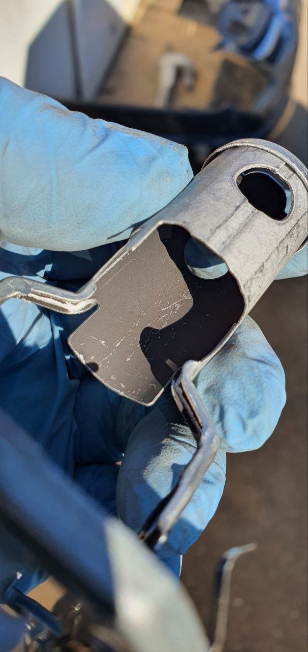

Is this part originally chromed inside?
This is from inside the headlamp where xenon bulb go inside.

Now that i'm thinking better about it , i imagine it is originally painted black inside , as the light reflex from inside the tube could be difficult to control. Just did a light polish in the exterior of the tube for a better looking (Not mirror finish)

I've had a similar "baffle" / shade?? out of a fog lamp assembly. That was made from aluminium and was unpainted, no attempt to polish or chrome it up from factory.
If it was me, I think I'd be trying to polish it , just because the thought of a bulb shining against a black / unreflective surface would niggle at me from an "efficiency" perspective. You are quite right in that light reflected back from a mirrored surface in here then reaching the main reflector might not be directed where it should go.

The light polishing i did in the outside , specially more pronounced in the front (as that will not pose reflective issues) , is really nice from a visual perspective. I'll try to capture a photo and i'll share here.MattBLancs wrote: 05 Feb 2023, 08:44 I've had a similar "baffle" / shade?? out of a fog lamp assembly. That was made from aluminium and was unpainted, no attempt to polish or chrome it up from factory.
If the headlamps were easy to open and then close (seal) back , i'd give them a good clean and then there would be some areas that i'd paint black (Areas where chrome is not needed , for sure)
