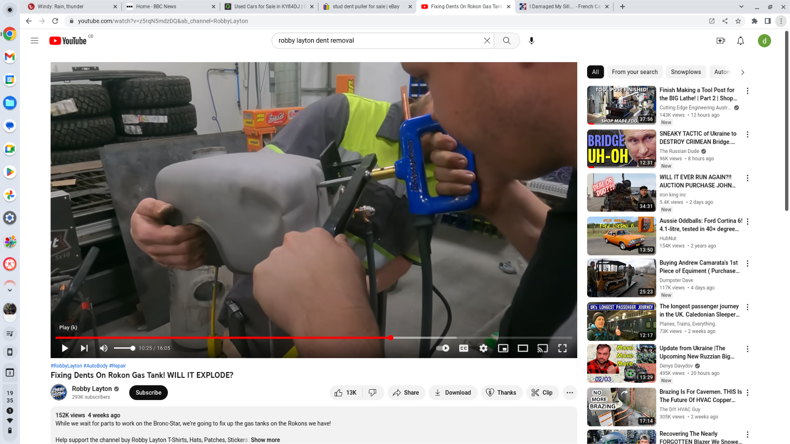

Took a while, and I still don't have the exact video I really wanted, but here is the modern version of what I did.

Dormouse wrote: 03 Feb 2023, 19:39 Took a while, and I still don't have the exact video I really wanted, but here is the modern version of what I did.
I bought a hand held spot welder, but it wasn't working, so gave it to a mate to give to a mate who gave it to a mate who I assume fixed it because I never heard from the guy ](*,)
I am planning an arc welder when they come back into Lidl. They are very small, but ideal for the likes of gates and whatnot. Gas is expensive so cheaper using an arc welder.
