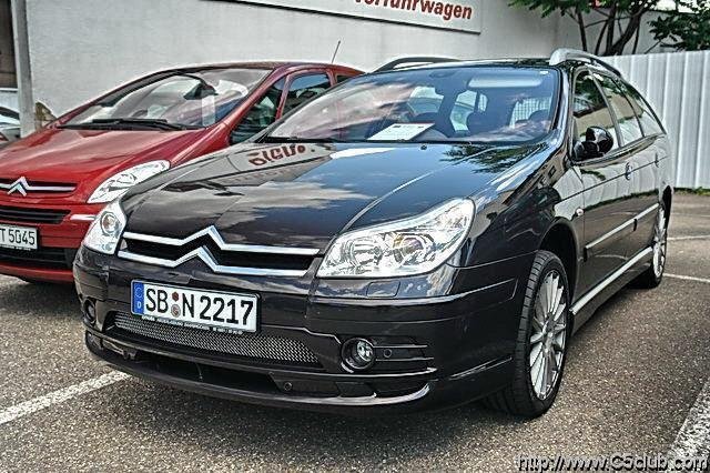

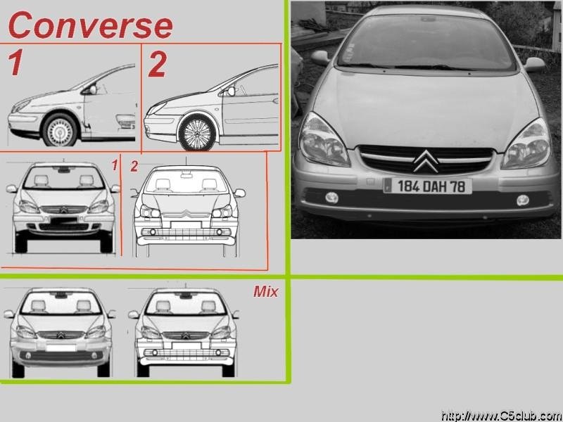

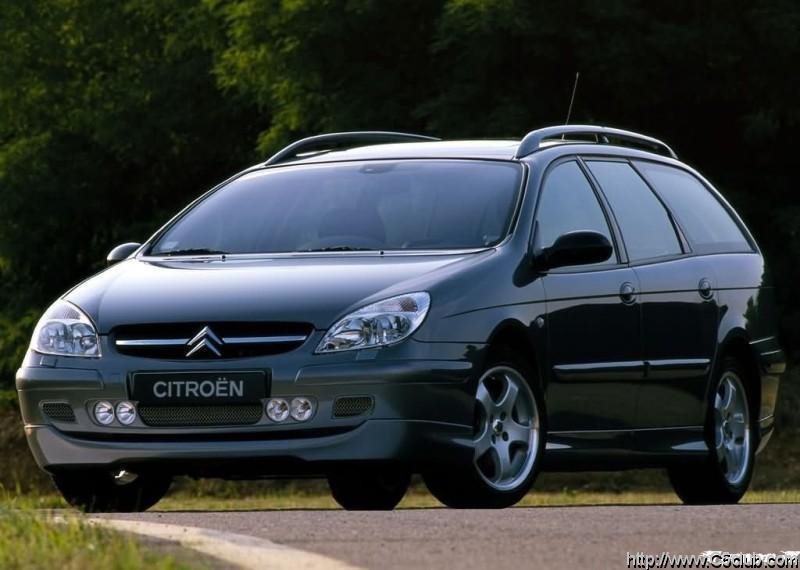

As the title says , i'm trying to find if Mk1 Xenon lights and the next restyling have the same connection on headlights?
Thinking about the possibility of changing the front for the restyling one , and (if possible) get the directional xenon lights, in the future.
Anyone around here has that experience? :roll:
(Images taken from the web as an example)
From this:
To this:

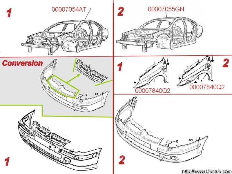

I know that the shape of the lights is different. My idea would be to change the side fenders , front bumper , hood and headlights. My doubt is more in the connection of the headlights , if it would be the same or if it would need some new wiring. (Or other thing that i may be forgetting too)
Got this information on the web, but nothing about the electrical connections. (I think this is more about the front bumper, but the idea would be to change the whole front for the newer "MKIi")
