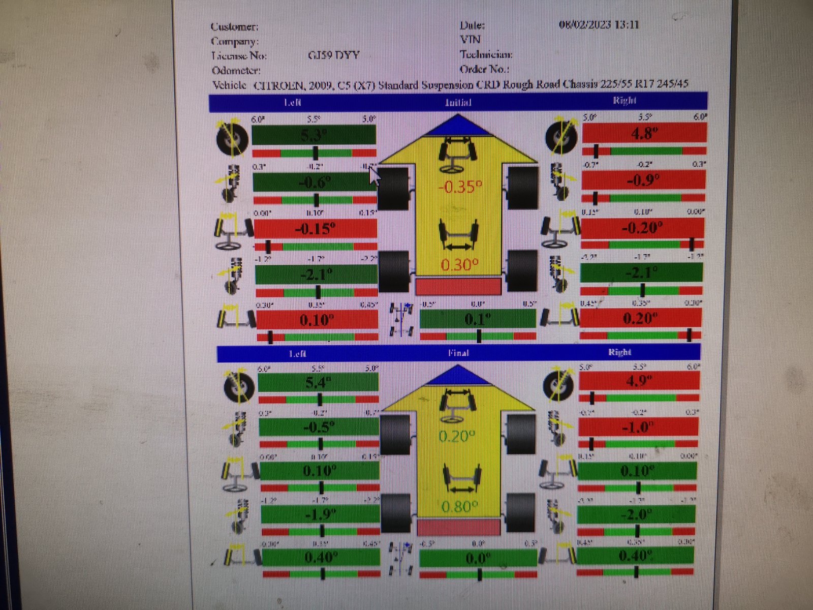

Update:car didnt make that sensation again for the next 2 weeks. Just had it tracked and it was out. Hopefully something that'll remain a mystery and never come back..
