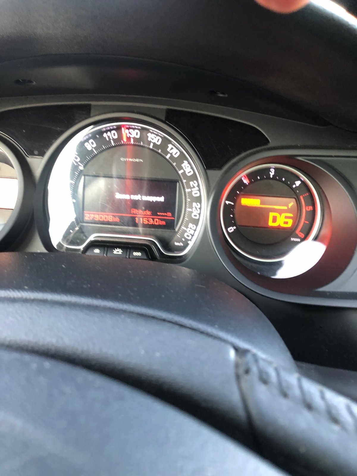

My nav part does not work on my instrument cluster, it just says "zone not mapped".
Is my software up to date or the cluster has its own software.
It doesnt show anything there, no altitude or any other things.

All that works, on cluster doesn’t have even altitude

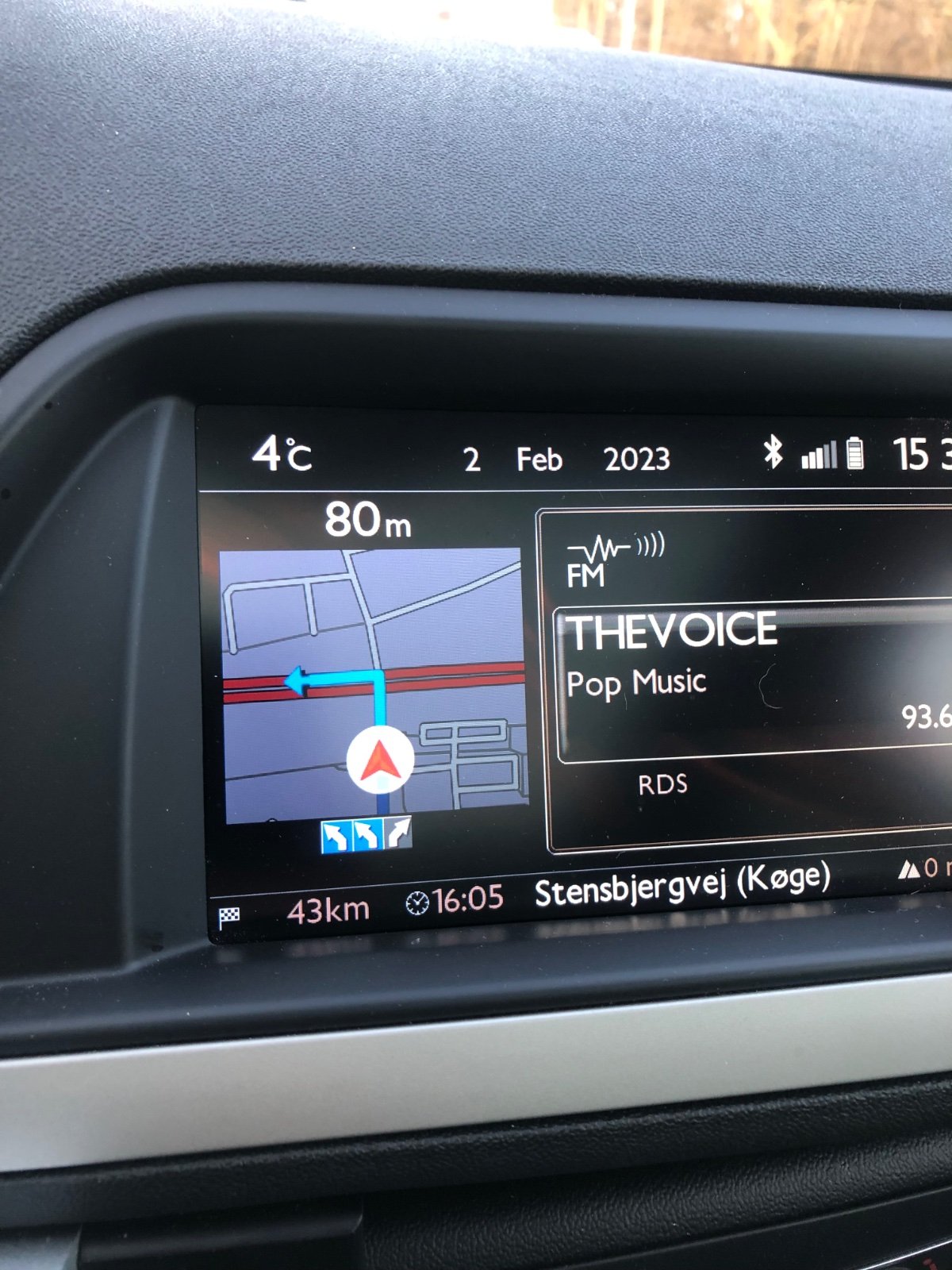

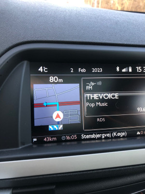

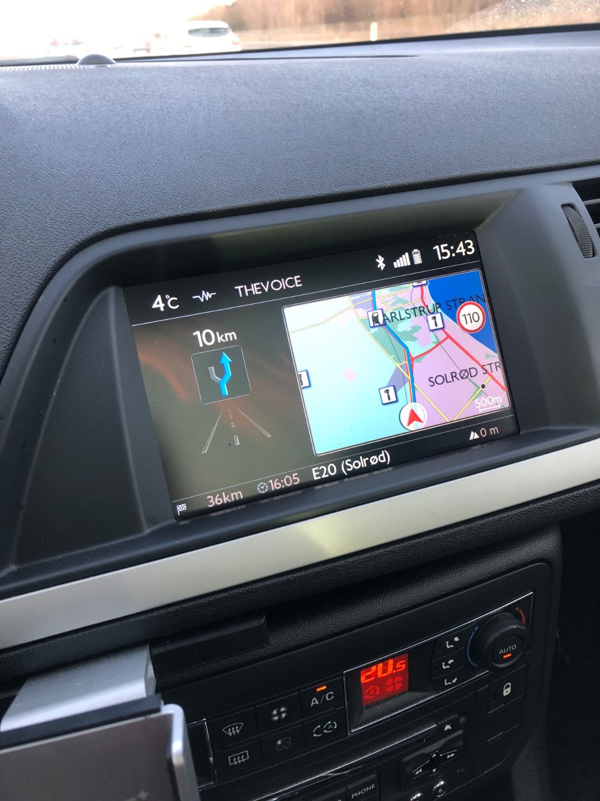

Pic of the nav and cluster, trip and other things on cluster work

Maps are from 21 and I think I read somewhere in this forum that it should show altitude if not then it’s communication issue, but nothing is showing up on that screen. I can see the trips and speed and so, even the wierd side parking thing shows up when in use. And have driven all big roads, no small roads, and always shows the turns and exits that I need to take
