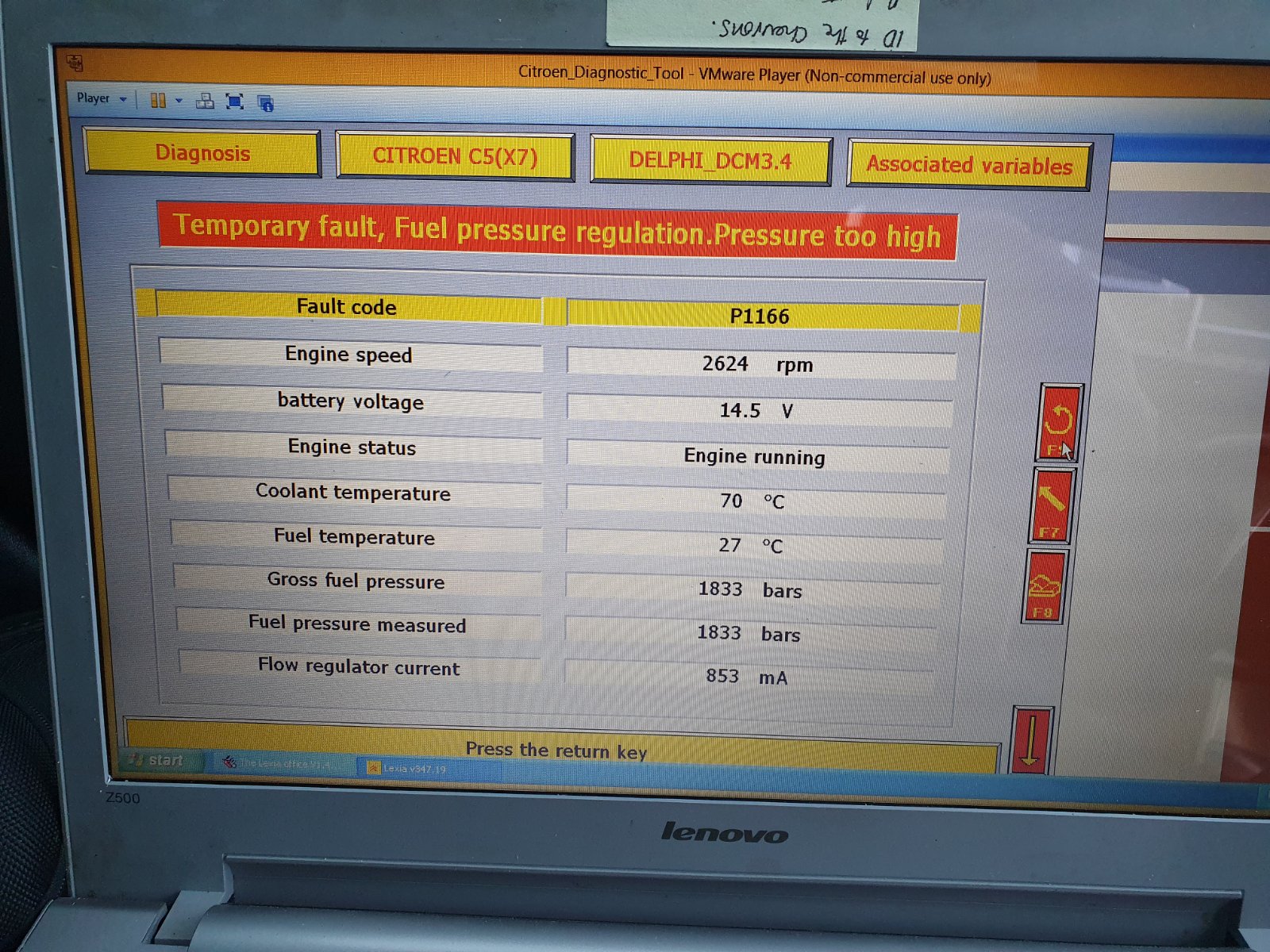

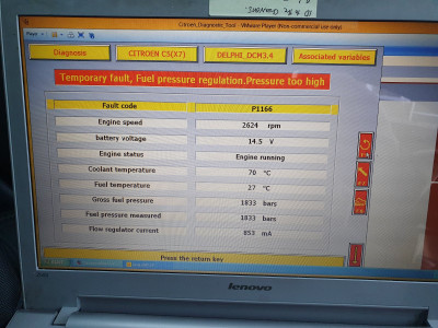

Anyway, about half an hour south of Carlisle the cruise control turned itself off and the warning "Engine management system faulty" and the yellow engine light is now on. This morning I hooked the lexia to it and it came up with several faults for the engine:
Anyone have a more comprehensive idea of what we're looking at here? The one that concerns the most is the P1166 Fuel pressure too high..

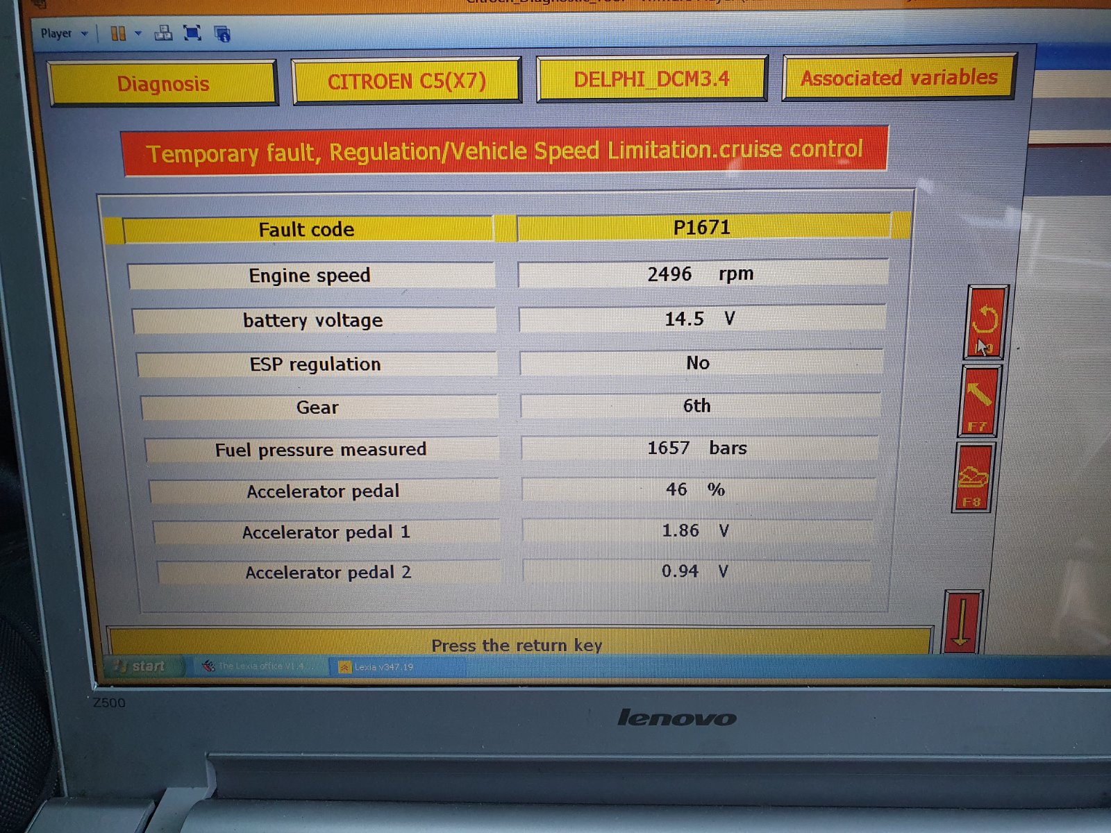

I guess the other fault of P1671 is the cruise control fault caused by the engine fault

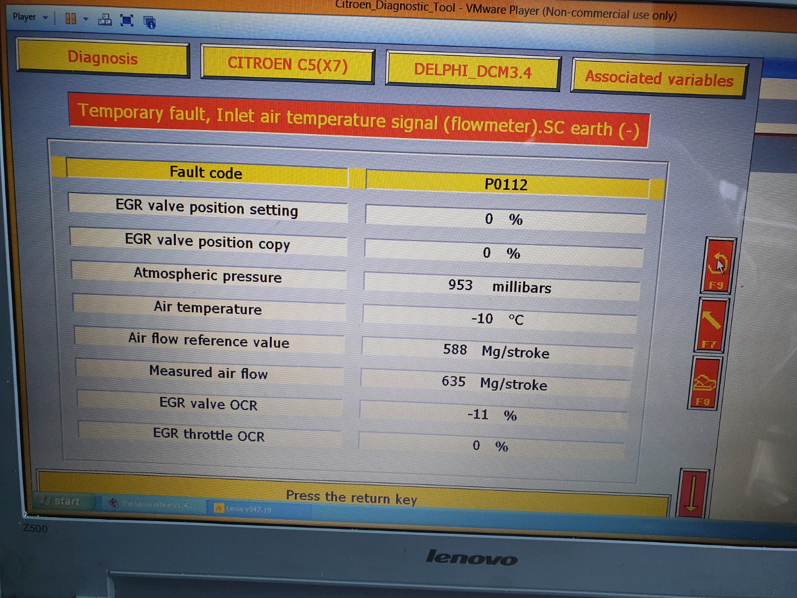

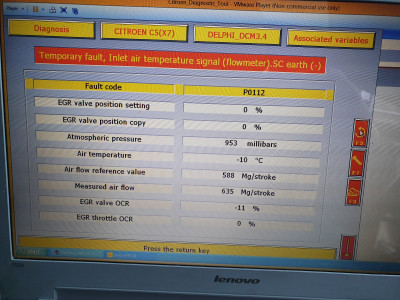

Just looking at that again, the fault for air flow meter says it measures the air inlet at -10c, seems wrong.

Looking up P1166 on here suggests possible benign or terrible causes.. This occurred at motorway speed with cruise on at say, 65-70. Just cruising along really but I had dipped the throttle to overtake quite quickly and it was shortly after that. A suggestion to clear P1166 is to go hard on the throttle for 5 seconds?

P1671 just relates to Cruise control: Reference speed outside the tolerance, with no further detail.
Your rail pressure shows as being 33 bar over reference values:
Fault Code: P1166
Description of Fault: High pressure fuel regulation: Measured rail pressure higher than the maximum pressure. Pressure of the fuel high pressure common injection rail measured higher than the maximum pressure of 1800 bars for 6 seconds.
Conditions for Fault to clear: Driving for 5 min with several full load accelerations for 10 seconds.
Downgrade Modes whilst Fault is active:

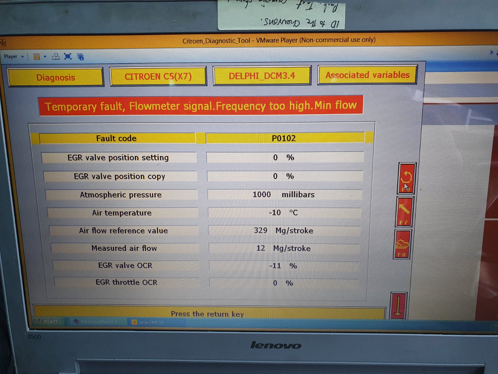

Fault Code: P0102
Description of Fault: Flowmeter signal: Measured flow less than the minimum flow. The ECU detects a drift of the air flow signal: The period of the signal for air flow measured exceeds the maximum threshold of 65535 µs corresponding to the minimum threshold for air flow.
The fault appears at the end of 300 ms
Conditions for Fault to clear: Ignition on
  • Deactivation speed limiter until the next time the ignition is switched on
  • Deactivation cruise control until the next time the ignition is switched on
  • Deactivation of the forced regeneration of the particle emission filter
  • The ECU stops the regulation of the EGR valve
Symptoms:
  • Smoke from the exhaust
Suspect Areas:
  • Air flow meter
  • Electrical harness
  • Engine ECU
Fault Code: P0112
Description of Fault: Intake air temperature signal (Air flow meter): Short circuit to earth; Value too low. The voltage of the inlet air temperature sensor signal is lower than the minimum threshold corresponding to a temperature of -49.9°C for more than 5 seconds.
Downgrade Modes whilst Fault is active: Deactivation of the coherence faults of the flowmeter
Symptoms:
  • Jerking/stalling
  • Lack of power
Suspect Areas:
  • Air temperature sensor on the flowmeter
  • Engine ECU

Thanks Marc, I was hoping the air flow meter fault was simply caused by my accidental running of the engine with the air filter (and the sensor) removed while changing the transmission fluid last weekend.
The first fault P1166, hasn't so far shown any symptoms such as low power. Just wonder if the 'Driving for 5 min with several full load accelerations for 10 seconds.' suggestion is a good idea.

There's definitely something it's not happy about that possibly will have a knock-on effect on other systems, so I'd always start with the specifics like the Air flow Meter as if that's faulty it will result in incorrect fuelling which may be your other issue.
