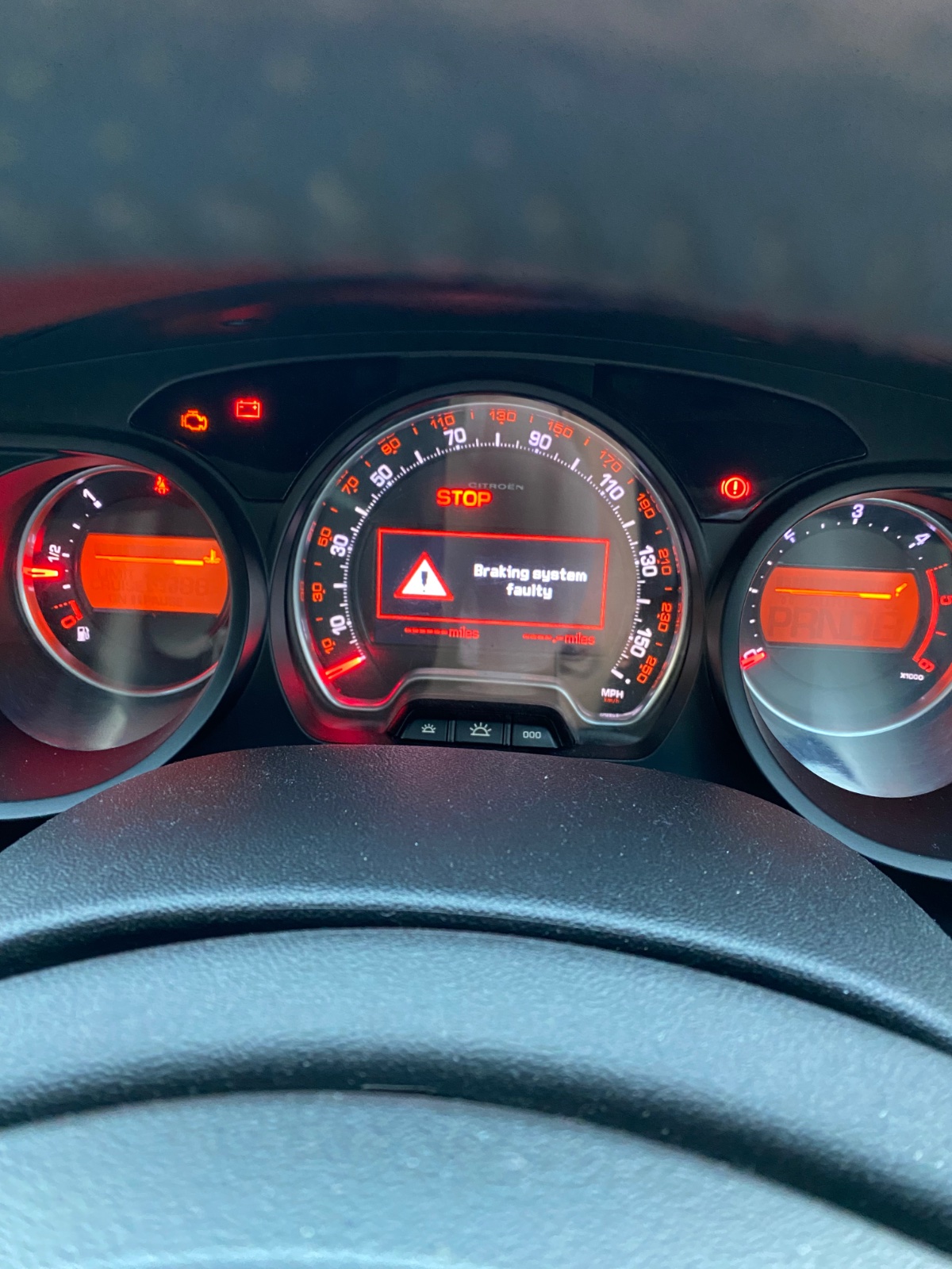

Hi there,
Looking for assistance if possible. I have a 2009 Citroen C5 iii, it has an issue which is driving me mad. When I try and start the car I get a message saying “braking system failure”, and the car will not start. It won’t even crank, I can hear a relay clicking in the internal fuse box when I turn the key but that’s all I’m getting. Also when this message is displayed it blocks access to scanning the car through the OBD port. Rarely on occasion this message will disappear on its own then the car will start and drive perfectly! I have this morning changed the brake switch but no change, checked all relevant fuses internally and in engine bay. Anybody got any ideas? It’s a manual car and manual handbrake too. Thanks

Without a diagnostic code it won't be easy to assist you. It could be anything to do with the braking or associated components as a lot of these systems are interlinked.
For example a faulty ABS wheel sensor, a fuse or the ABS / ESP module etc. etc.
Best if you can connect up Lexia or diagbox and get some fault codes, then pop them up.

Thanks for the reply Marc, the issue is the car won’t let me hook up to it with any device. Nothing sees the car when that message is present. Really strange. Checked all fuses too. I thought even though that message is displaying to show the warning that the car should still start?

You will have to connect the diagnostic when the car manages to start. You can run it with the engine running just to get the saved error codes.
