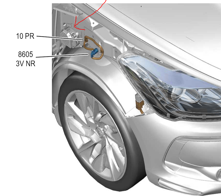

Ok so be wary here. Sensors aside, there are 2 other main components the alarm ECU itself and the alarm siren.
In my experience it is mostly always the actual alarm siren that fails, because these are self-powered and use mini accumulators that normally are charged with the vehicle running. If the supply fails the alarm is triggered. If the accumulators are end of life, which will start the behaviour you are having, then you can just replace the siren. The siren also incorporates the anti-tilt sensor to detect if the vehicle is being lifted.
The siren is located on the right (UK driver's side) wheel arch, behind the wheel arch protection guards, here where I have arrowed:

x 6945
Re: DS5 Sport 2013 - Alarm keeps going off
I've updated my post with an image ^
