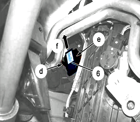

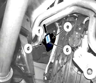

It's very likely to be the Blower Motor Control Module. This controls the fan speed and when they fail, the fan will remain of full speed or no speed.

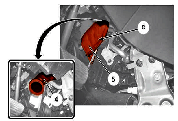

For the Front blower motor, this is located on the left hand side of the centre console in the footwell.
You will need to remove the trim panel, the air conduit pipe and sound deadening...
It should be located here.
