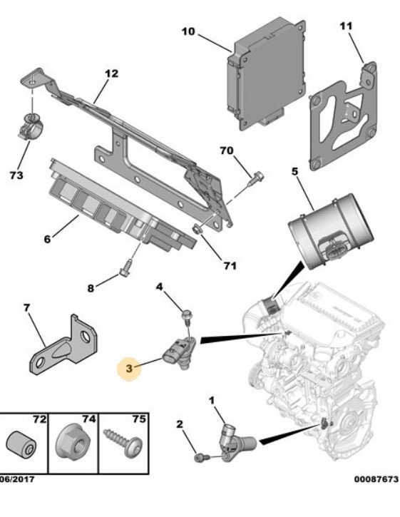

Hi
My 63 Plate Nemo Van has thrown up a P0340 code which I belive is a camshaft sensor fault?
Can any of you knowledgeable chaps (or ladys) point me in the right location for it?
1.3 Hdi 75ps nemo Van on a 63 plate
Thanks in advance
Pipkin51
wheeler
Posts: 7930
Joined: 21 Sep 2002, 19:07
x 1055
Re: Nemo Van Camshaft Sensor Location
Unread post by wheeler »
Number 3

I have changed the unit number 3 on diagrame
What is the sensor numbered 1 lower down on the engine block?
Number 1 is the crankshaft position/speed sensor.

So just to confirm
I had a P0340 code which is camshaft position sensor (3) which I have changed
Could a faulty crankshaft sensor (1) be at fault?
Just because you have a fault code relating to a sensor does not necessarily meant the sensor itself is faulty.
most basic diag tools should be able to read live data from the crank sensor, to see if there is an RPM signal coming from it when trying to start the engine, check this before replacing parts.
