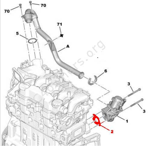

Hi Ian - Not sure if 2010 1.6HDI is same as slightly older ones but I saw a stuck open EGR cause that symptom before (admittedly it caused error codes that pointed that direction). A good explanation shows why MAF/O2 Sensor/EGR interact (like EGR stuck open puts too much inert gas - i.e not oxygen, into the mix and the O2/MAF end up trying to compensate in making the correct mix of fuel/air ratio but a smaller volume in the piston as the bulk of the gas is not Oxygen.... meaning lack of power) loosening just 2 long bolts a little and the battery to have access round the back of the engine to get those bolts - yours may be a bit easier/trickier depending on scuttle/battery/pipes around the area. Clearly a blanking plate will be an MOT fail as it likely brings on the EML but for a few £ it will certainly prove the EGR is the cause or not. Once you know if its the EGR or not you get to decide whether to try cleaning it or bite the bullet and buy new.
But I totally agree with Marc's recommendation for Lexia kit - I wouldn't be without one now, and has paid for itself many times over in what it saves (including friends)
I imagine yours is similar to this dont remove bolts 3 all the way - just a few mm enough to slip the plate in between item 1 (egr) and 2 (gasket) .
Edit - I had a look back on some photos of how I did it - I was preparing for a new EGR anyway so did the following: remove wipers, scuttle, MAF and pipe to turbo, airbox inlet pipe - that gives you loads of room from above . Then i disconnected EGR plug, Fuel filter plugs x2, fuel filter pipes x2, removed fuel filter (keep it upright so you dont lose any fuel), removed the fuel filter ally bracket (3 bolts) - you now have all the room in the world.
A bit of advice, the EGR cooler - which isnt actually shown in the picture above - it replaces the long pipe. That cooler has a 10mm nut holding it against the engine and loosening it a bit gives a load of flex at the EGR itself also the circular clip holding cooler to EGR can be a pig, just replace it with one that has a hex fastener (similar to exhaust fasteners) - only need to do that if you are changing the EGR out though.
Again - I totally reiterate Marc's suggestion you get error codes read to confirm thats the direction you are going - It can be really annoying if you did all that and its just an air leak in a pipe somewhere. - Learn from your own mistakes is smart, learning from others mistakes is really smart
