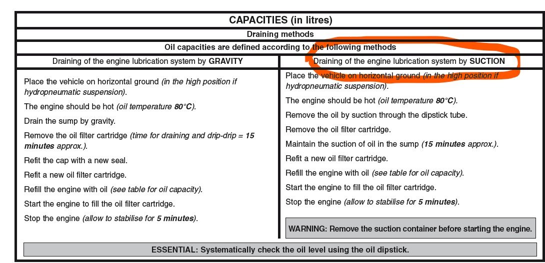

I note Lidl has oil change pumps on sale today. Can anyone confirm that removing oil of my C5 hdr using one of these is fine. Some say yay and others say nay. I assume this is stuck down the oil dipstick and you replace the same amount you remove? Are there any problems with this method. It would save me having to pay the best part of £200 to the garage.

Citroen are OK with suction draining.
There are some manufacturers engines that dont even have a sump plug now like some variants of the smart car, suction draining only.
