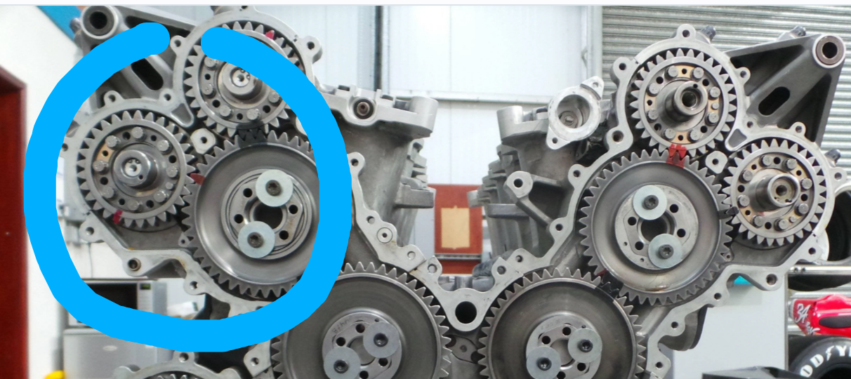

In terms of power consumption, straight cut gears are most efficient. Make an unruly din, but tolerable for a race engine (think some bikes are gear drive to cam, and some aero engines too)
Renault V10 F1 engine apparently:
Helical gears next down for efficiency due to the thrust forces they generate, think then maybe bevel gears then chain then belt. Will have it somewhere in the uni notes, buried in the loft!
Belt looses a bit on efficiency due the rubber bending then straightening on each pulley. Presume the pivoting chain links (when nicely oiled!) Must generate less internal friction than the flexing rubber.

Re: Dose "Pro-Line Oil Loss Stop" hurt timing belt ???
Couldn't help but notice...
