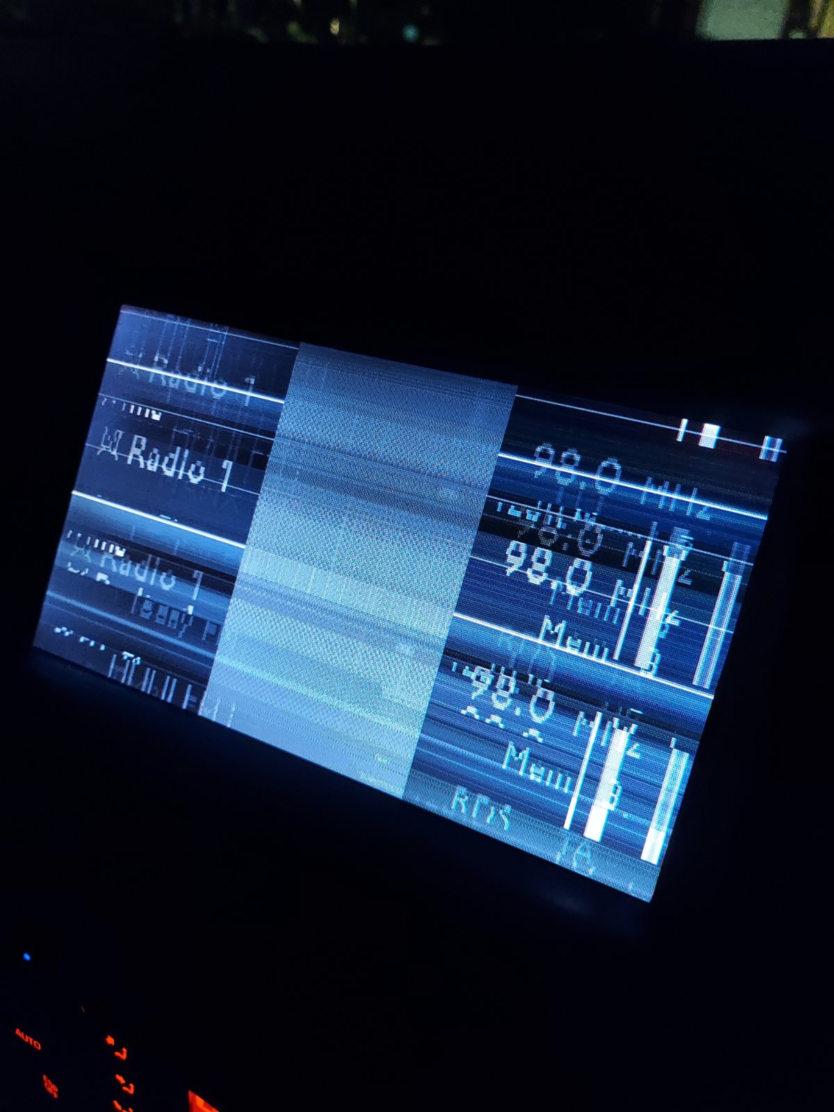

Hi...MY screen is damaged somehow...can i purchase secound hand one and just attach..or is it more complicated than this? TiA
- x 6956
Re: CITROEN c5 2011 vtr 2.0 diesel
Normally you would test it to determine if it is the actual screen itself, or the head unit hardware.
The test the dealer would undertake usually consists of dumping the core data from the unit to an SD card or USB, which includes several screen dumps. When viewed on a computer, if the screenshots are ok then this rules out the graphic controller of the head unit and confirms either the connection to the screen or the screen itself.
