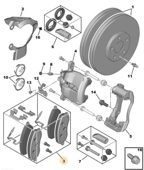

As for the brake pad wear detection harness, I can't see it specifically mentioned.
This is diagram for the front brakes
You can only see the pads with the plugs that connect to the wiring loom.

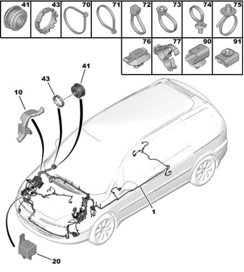

This is the under engine wiring Harness
I can't tell from this if it shows the connections for the brake pad wear plugs though.
The only other diagrams are the supplementary ones for the bumper and lighting harness and the other is for the main engine block (injection) so not on that.
So you may have to look for a repair.

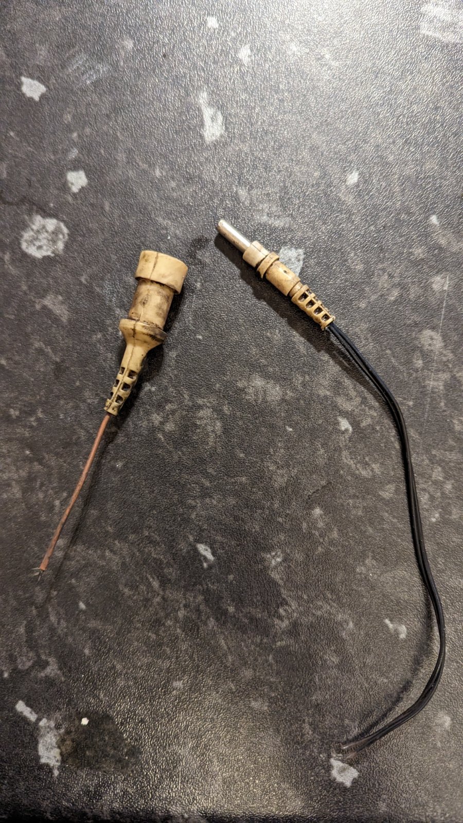

This is the wire that has snapped, and was just hanging loose, when I went to check what it was it just broke away from the brakes.
So based on all your experience, is this the brake worn sensor cable?
'The Wire'
'The Wire'

Just splice it back in with a bit of solder and some heatshrink tubing. All will be good.

Re: Peugeot 807 brake pad worn alerts
The part on the left is what has broken off the main loom and that is the bit you'll need to repair with a wiring block. The actual sensor cable on the right will come with the new pads if you get the version with the sensors and just plugs in.
