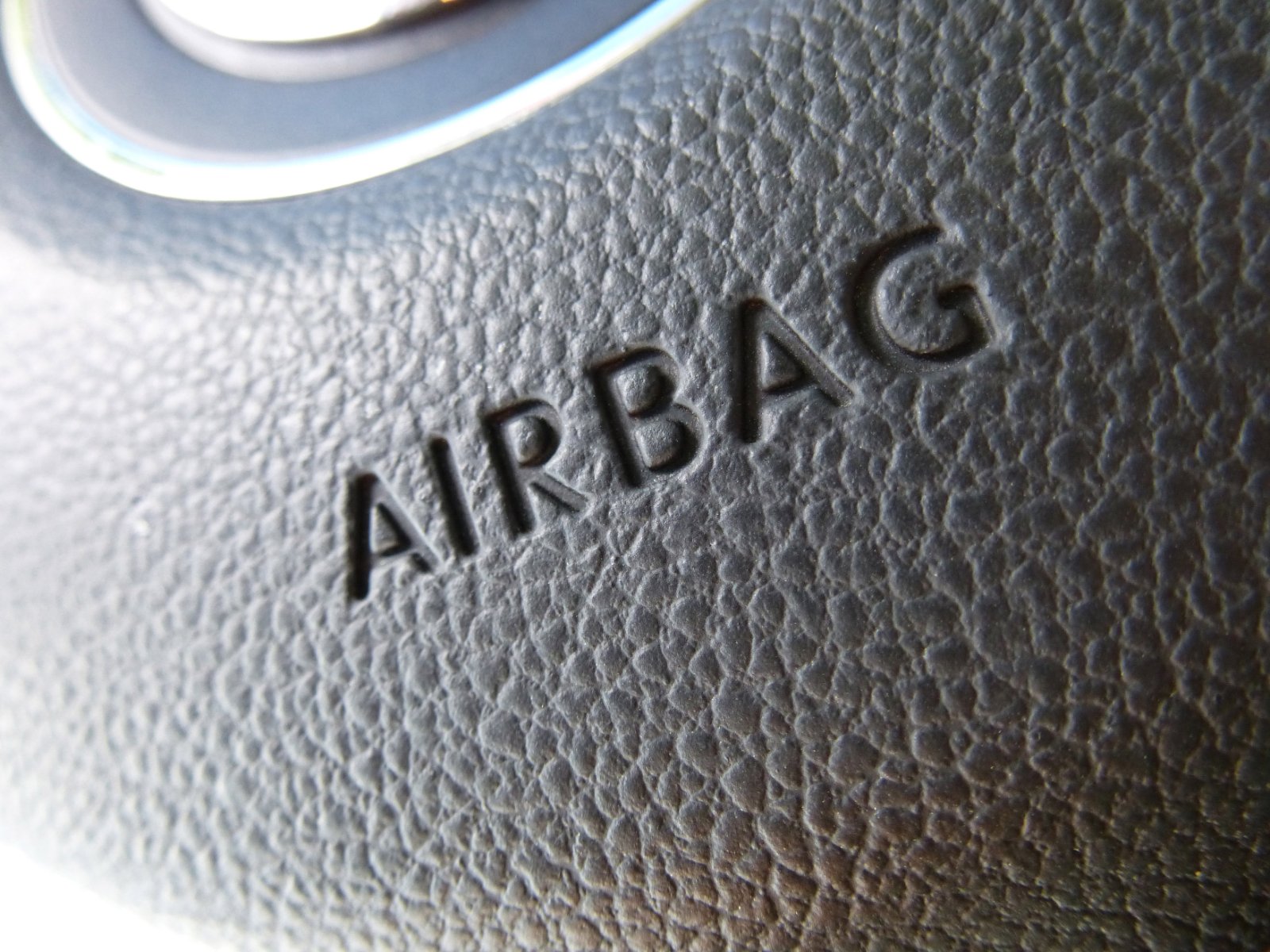

I'd imagine that, where fitted, they're integral to the seat rather than being installed in the door. There should be an 'Airbag' or 'SRS Airbag' sign/tag/loop to advertise the fact that they're fitted?

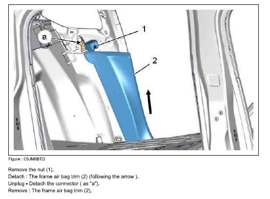

I thought so too, but can't see anything. There's what appears to be a foam 'bolster' with a fabric skin on the ouside of the seats (mounted on the C-pillar). Perhaps that's the mount point and the foam is there like a blanking plate? This is the best photo I could find on google (it's too dark to take a good photo of mine).Ross_K wrote: 01 Jan 2023, 19:13 Parkers says the two rear airbags were optional too. It's probably one of those things that nobody every specced when buying the car![]()

It should be on anything that has an airbag in it so nothing is put in front of it that could be turned into a missile or cudgel. Look at the ones you know have airbags in them.

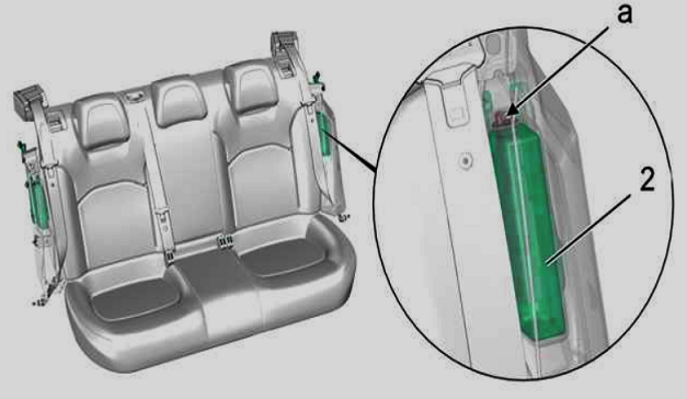

Huh, so it was those things. Thanks for the reply. I wonder if it's possible to retrofit them without too much faff?

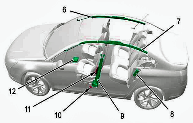

Not really, as the wiring probably won't be there, then you have to have the correct airbag pyrotechnics as they have different gas volumes - 15 litres for row 2 (rear seat airbags) compared with 9 litres for the front seat airbags. Then there is the matter of needing the correct Airbag ECU control unit - which is different depending on fitted equipment and variant.
These were not standard and only an optional extra for the rear passenger seats shown at (8):
(6) Right side airbag (Curtain type)
(7) Left side airbag (Curtain type)
(8) Rear left side air bag (chest-type)
(9) Front left seat belt with pyrotechnic pretensioner
(10) Left-hand lateral acceleration sensor
(11) Front left side air bag (chest-type)
(12) Airbag ECU (Located under the central console)
