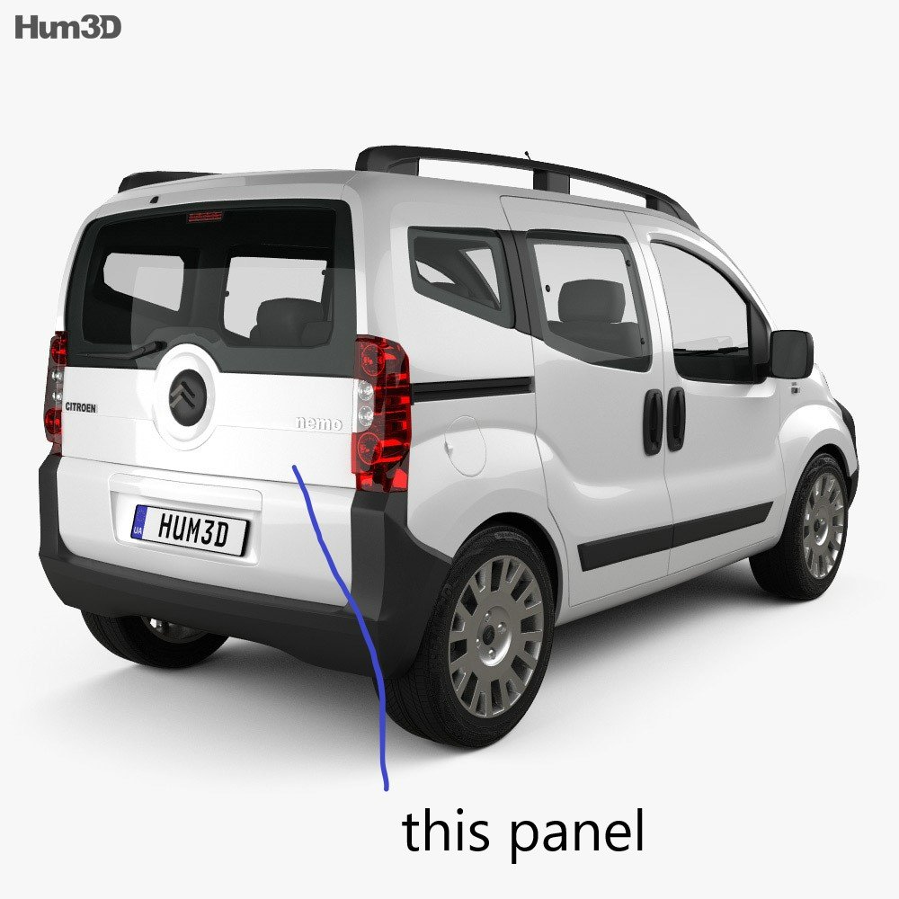

Can anyone help
I have tried various tapes
and my friend is a glazer and had super sticky adhesive tape but it only lasted 2 weeks
My back panel has come off

Never used it, just did a quick google search
OEM Spec ?

How much cleaning (and what with?) Are you doing?
Surface preparation key to success with this I'd think.

ohspecial1 wrote: 29 Dec 2022, 18:49 Can anyone help
I use Tiger Seal for stuff like this. Don't go mad, but a 50p sized blob on each corner and a couple of smaller blobs in the middle top & bottom.
if you ever need to remove the panel, get glue remover and apply on 1st blob and use a plastic "knife" to encourage it off.
Tiger Seal is my No1 go to for this kind of awkward nonsense.
Apply on the plastic, or on the boot lid, clamp each side with cardboard between the clamps to prevent scratches. In this weather, allow 24hrs for a good bond. If in a heated garage, 4hrs should see it all right. Don't wash for 24hrs (the car that is :lol: ).
https://www.eurocarparts.com/p/u-pol-ti ... W8QAvD_BwE
BEWARE, this stuff is manky! Wear thin gloves & keep away from clothes, kids, pets, couch, in fact anything indoors 8-[
