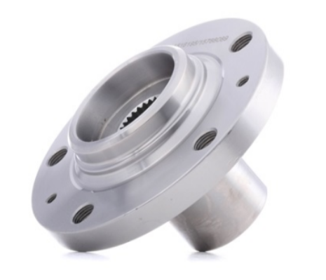

Wheel hub - if there's enough of a gap for the silicone to have actually done something then I'd suspect there's precious little steel for any thread to be recut. Should be able to find a replacement hub easy enough, but sadly lines you up for a new wheel bearing at same time.
Would guess removing hub on an X7 also lines you up for a new lower bearing (FRIP) on the hub carrier too.
So that one bodge is growing arms and legs to fix!

Sorry, might be me being unclear with terminology, sometimes called the "drive flange" , this is what I talked about replacing:
The wheel bearing obviously sits on that inner section. In my experience it's difficult to extract the flange without pulling the bearing in to two pieces, particularly the outer bearing's inner race wants to stay on the hub/flange. (And indeed normally cut this off during a bearing replacement, not much room to get any sort of pulley in to extract it undamaged)
