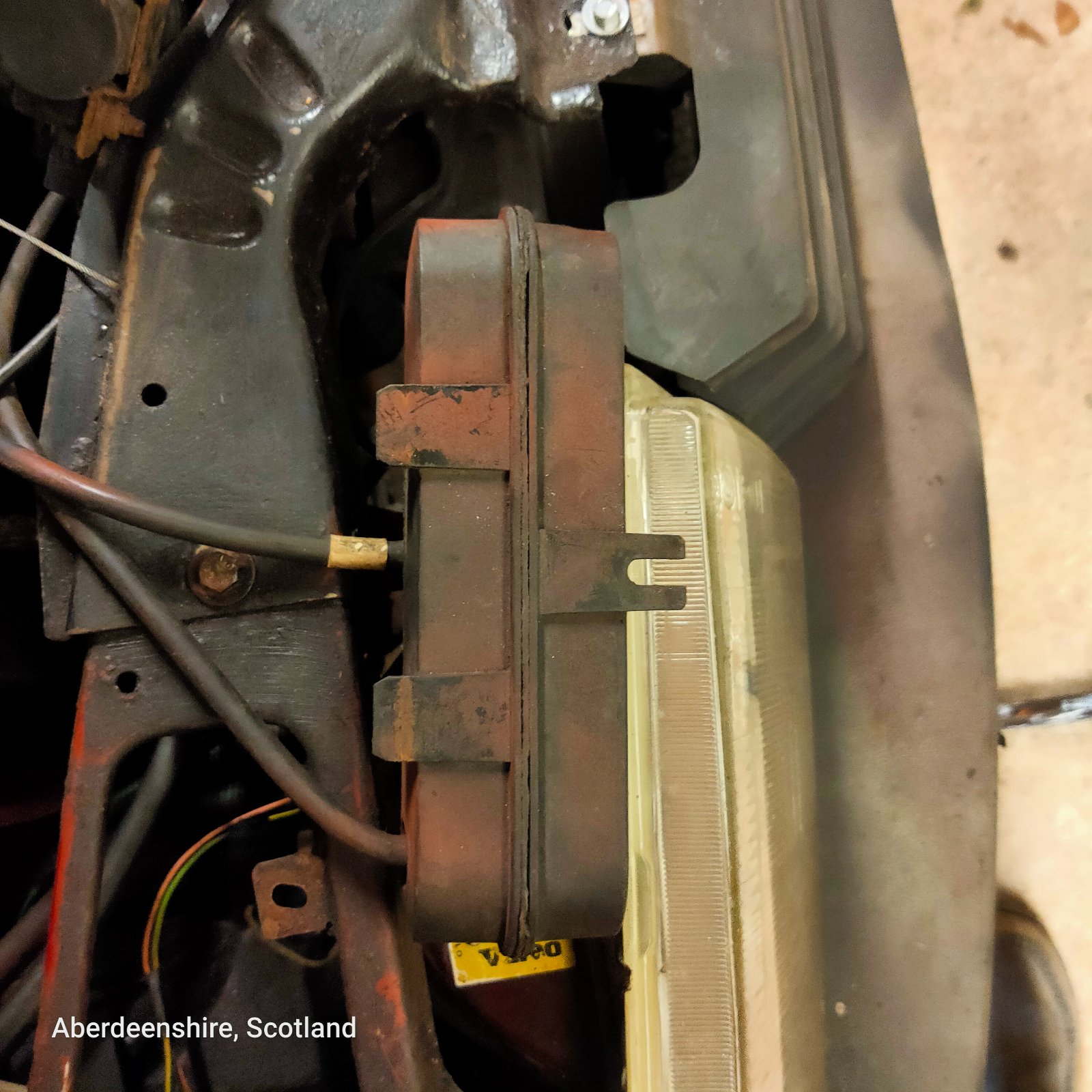

Excuse my ignorance but can anyone tell me what the following parts of my C15 are,cheers Olly

May prove well off the mark, but I remember my dad's work C15D had adjustment knob for headlamp height - as do lots of PSA stuff, but usually on the Citroen I'm pretty sure it was completely mechanical.
So, by location as pictured, I'm going to guess it's part of that mechanism.

Ummm. That's interesting... Looks like vacuum pipes... What does the box attach to and where do the two pipes go to exactly?
Some wider-view pictures may help...
My Saxo have electrically aimed headlamps whereas my AX has knobs... I've not seen vacuum operated ones - yet...

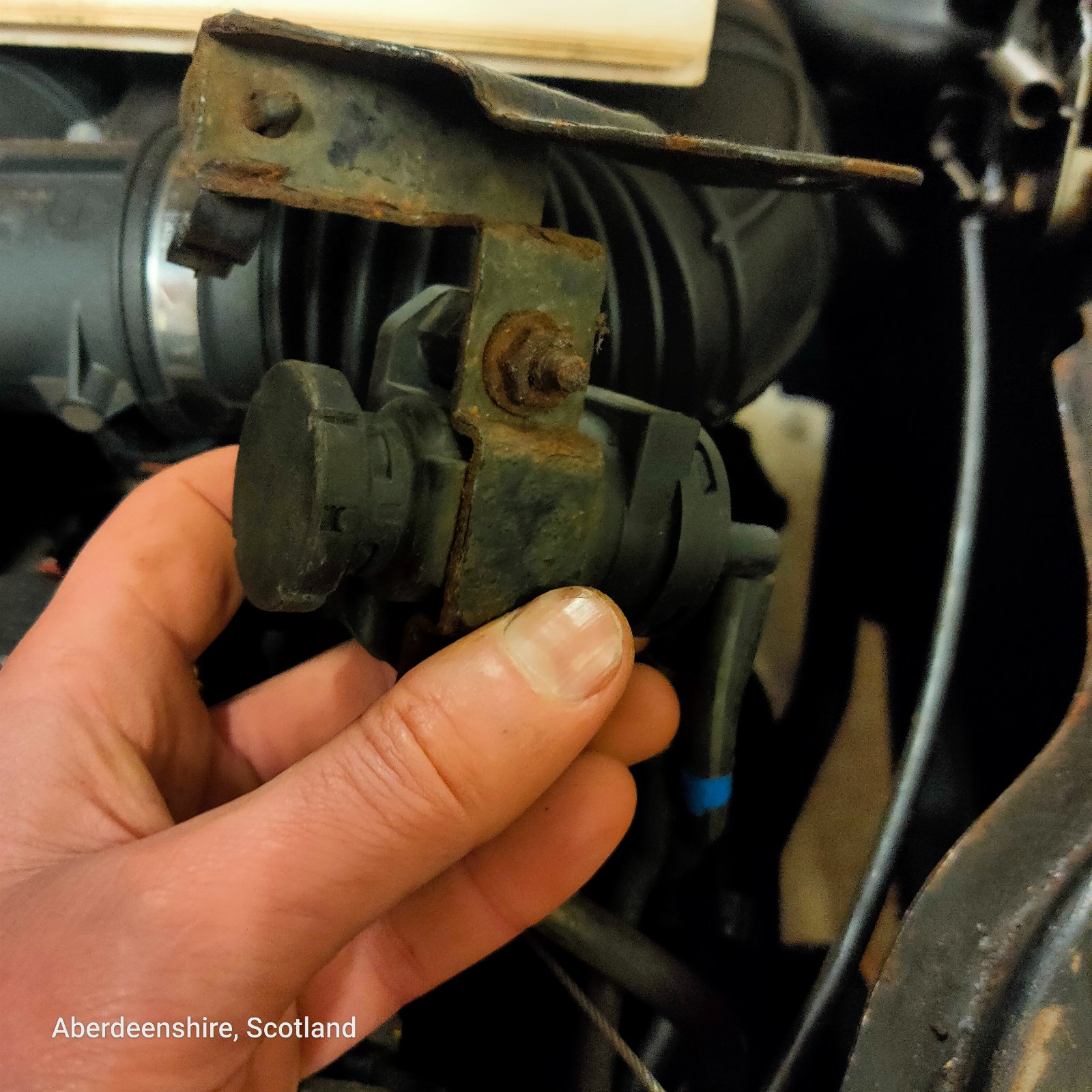

The bit in the second picture looks vaguely familiar but at the moment I can't place it...
Two things thin vacuum pipes might do on a diesel is operate an EGR valve or set cold advance/fast idle on the injection pump...

Picture 2 is a turbo solenoid valve, or possibly EGR solenoid valve.

You saw vacuum pipes, I saw Bowden cables!CitroJim wrote: 29 Dec 2022, 17:42Looks like vacuum pipes...

No1 possibly a control box for glow plugs.ollylever2020 wrote: 29 Dec 2022, 13:12 Excuse my ignorance but can anyone tell me what the following parts of my C15 are,cheers Olly
No2 looks like a vacuum operated throttle damper to me

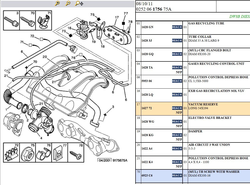

I take it this is a DW8 engine?
The first pic is the vacuum reservoir, the second pic is a vacuum electro valve for the EGR system.
Parts 16 & 17 in the pic
