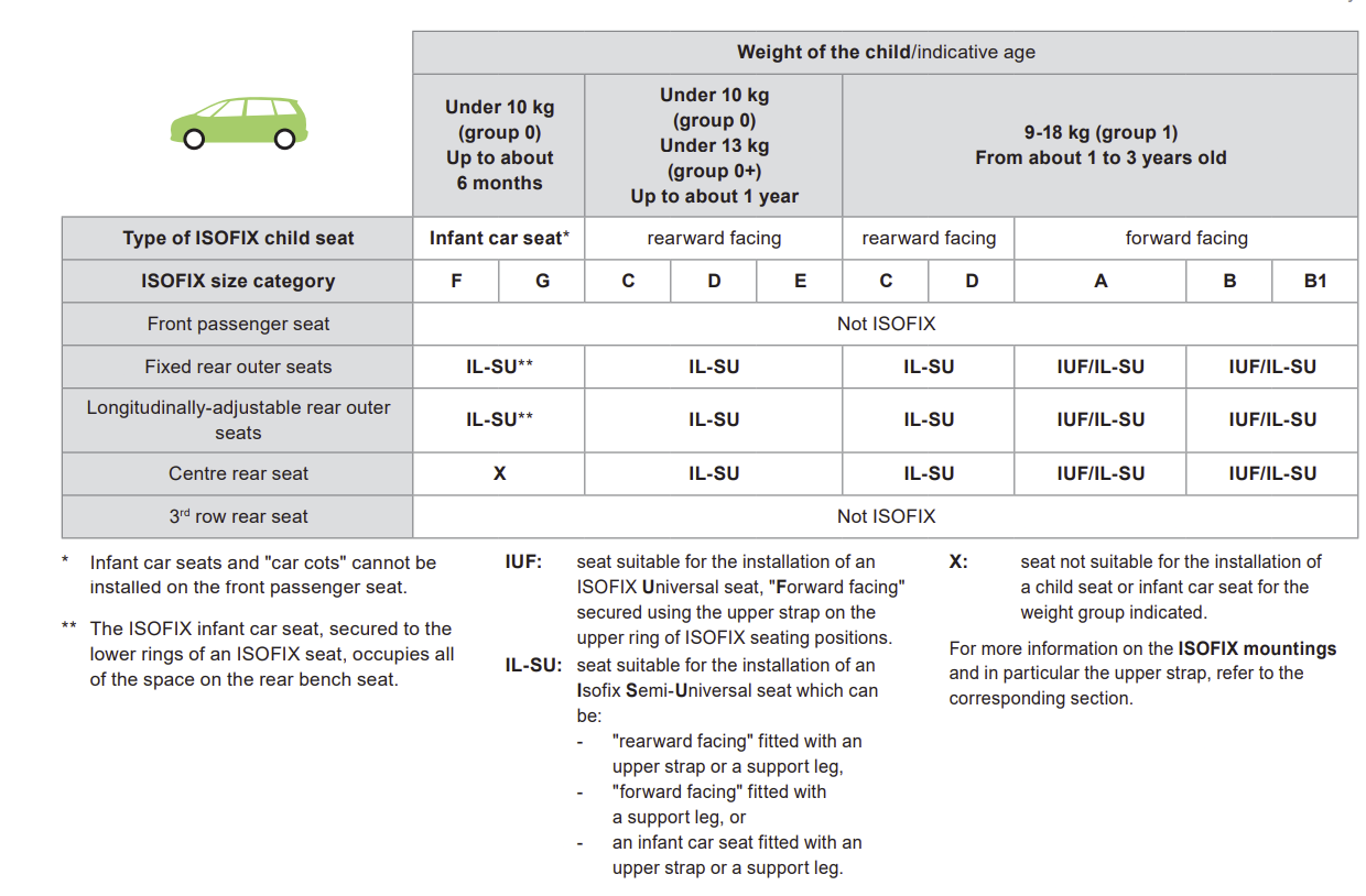

From the manual (click images to magnify):
Here's a PDF of the manual you can download and read through the whole section:

I've just edited the above to include the complete manual link for this year. These are the only recommended places to secure child seats and in the manual you can see the recommended child seats and the groups referred to.

So three of the car seats recommended in the manual use support legs, and for all of them the manual says "the base has a height adjustable support leg that rests on the vehicle's floor".
But no mention is made of the underfloor storage boxes, despite the Isofix positions being across the middle row of seats where the boxes are. It's frustratingly unclear given the general advice of most people/companies on the internet to not use a car seat with a support leg on top of an underfloor storage compartment.

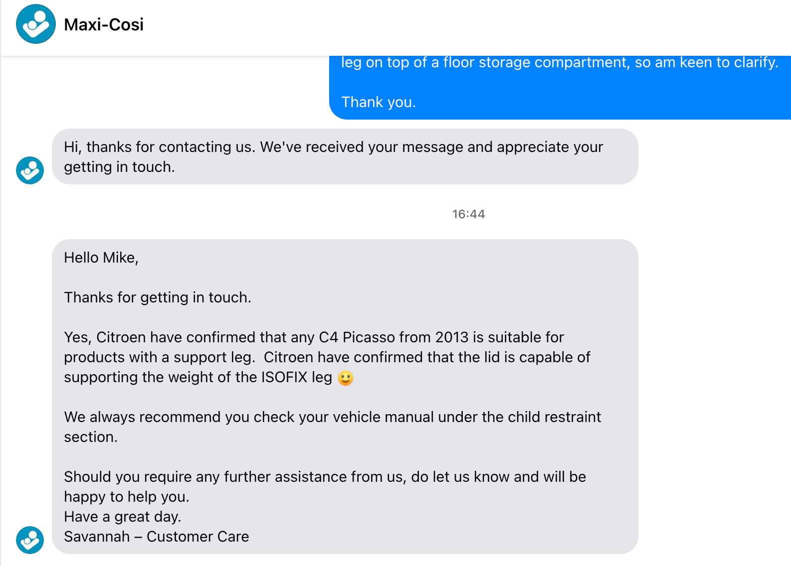

Just for anyone looking for an answer on this at a later date, Maxi-Cosi also replied to me today.
