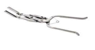

The fronts don't require the piston to be wound back on this vehicle. You use Facom pliers (D60.A) like these:

Handbrake operates on the rear calipers on an X7, thread title mentions front caliper?
Piston is conventional on the front, isn't it? So a g-cramp would do to push it back in, no need to rotate and shove?
- Posts: 5373
- Joined: 25 Apr 2022, 09:03
- x 2374
Re: C5 X7 front brake caliper
Glad we didn't disagree with one another!
- x 6950
Yes, only wind back on the rears Matt.
