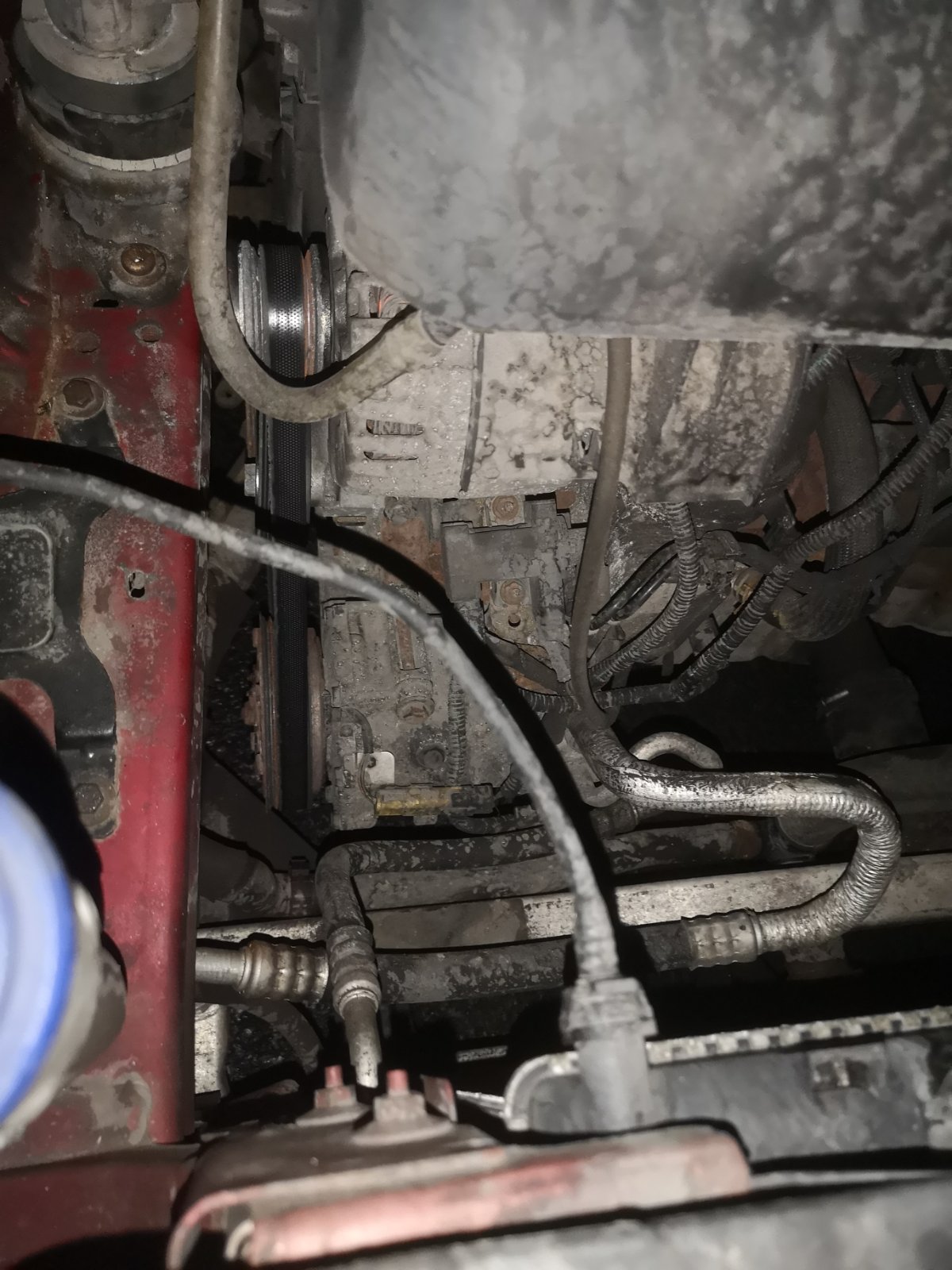

Agour
(Donor 2026)
Posts: 116
Joined: 27 May 2018, 16:36
x 5
Re: C5 x7 - power steering leak
Unread post by Agour »
Think I might be wrong on the pump!
Looks to be the engine turning the belt, tensioner, alternator and a pump for the radiator. (Or probably the air con pump going to condensor?).
If i disconnect the fuse for the power steering, would that minimise any damage from driving it?
Stuck 2 hours from home and had 2 failed recovery vehicle attempts already 😅 (Third one is due after midnight!) Hence why im tempted to yolo it home
Posts: 6820
x 3542
If it is an electric pump, then you'll be OK to pull the fuse on it and drive it, but it'll be hard going to steer - so check you're OK with that before you cancel the tow truck ! You may well get an engine code and/or warning up on the dash.
And BTW, you've not got the right auxilliary belt on that - it should be wider :)
Agour wrote: 23 Dec 2022, 20:55 Looks to be the engine turning the belt, tensioner, alternator and a pump for the radiator. (Or probably the air con pump going to condensor?).
Yep - that's the aircon pump at the bottom.
bobins wrote: 23 Dec 2022, 21:02 If it is an electric pump, then you'll be OK to pull the fuse on it and drive it, but it'll be hard going to steer - so check you're OK with that before you cancel the tow truck ! You may well get an engine code and/or warning up on the dash.
Cool yeah I'll whip it out and go for a lap of the car park.
Yeah.. The engine is slightly misalinged and a wider belt runs over the edge of the tensioner, which causes it to pop off.
