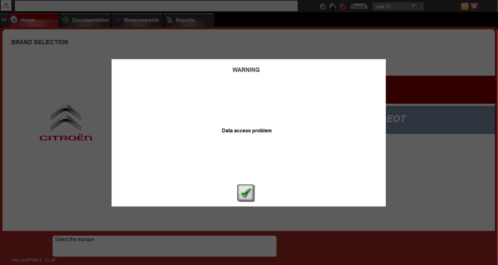

I am trying to get Diagbox working so I can initialise a replacement NOx sensor on a late 2016 DS3 1.6Hdi. I bought the full chip kit from Easy Diagnostics, and after a little IT battling, I have managed to work through the various installation versions, v7.02, v7.57 and then a number of interim steps to get to v8.17 which is the latest version that comes from Easy diagnostics.
I have two challenges:
1) None of these versions ever show DS as a third manufacturer choice, something I see on some screenshots of Diagbox out there. Only Citroen and Peugeot. Now I appreciate that a DS3 is just a Citroen with some different badges on, but it does not give me confidence that this is the right software version to talk to my car.
2) I cannot get past the 'Data Access Problem' that comes up when selecting Citroen - even when disconnected from the Internet. Searching shows lots of people with the same issue, but no solutions - simply a recommendation to go back to v7.57.
Before I go back to Easy Diagnostics for help, I wondered if anyone has any pearls of wisdom. Any ideas on what version I need to work with my particular late 2016 car? Do I need to go to VMWare and v9.x?

Answering this one myself as I have managed to solve it. I initially re-installed back to v7.57 - over the top of v8.17 - and this has corrected the 'Data Access Problem' message and actually allowed me to access the features of Diagbox. v7.57 only lists Peugeot and Citroen as manufacturers though, not DS.
