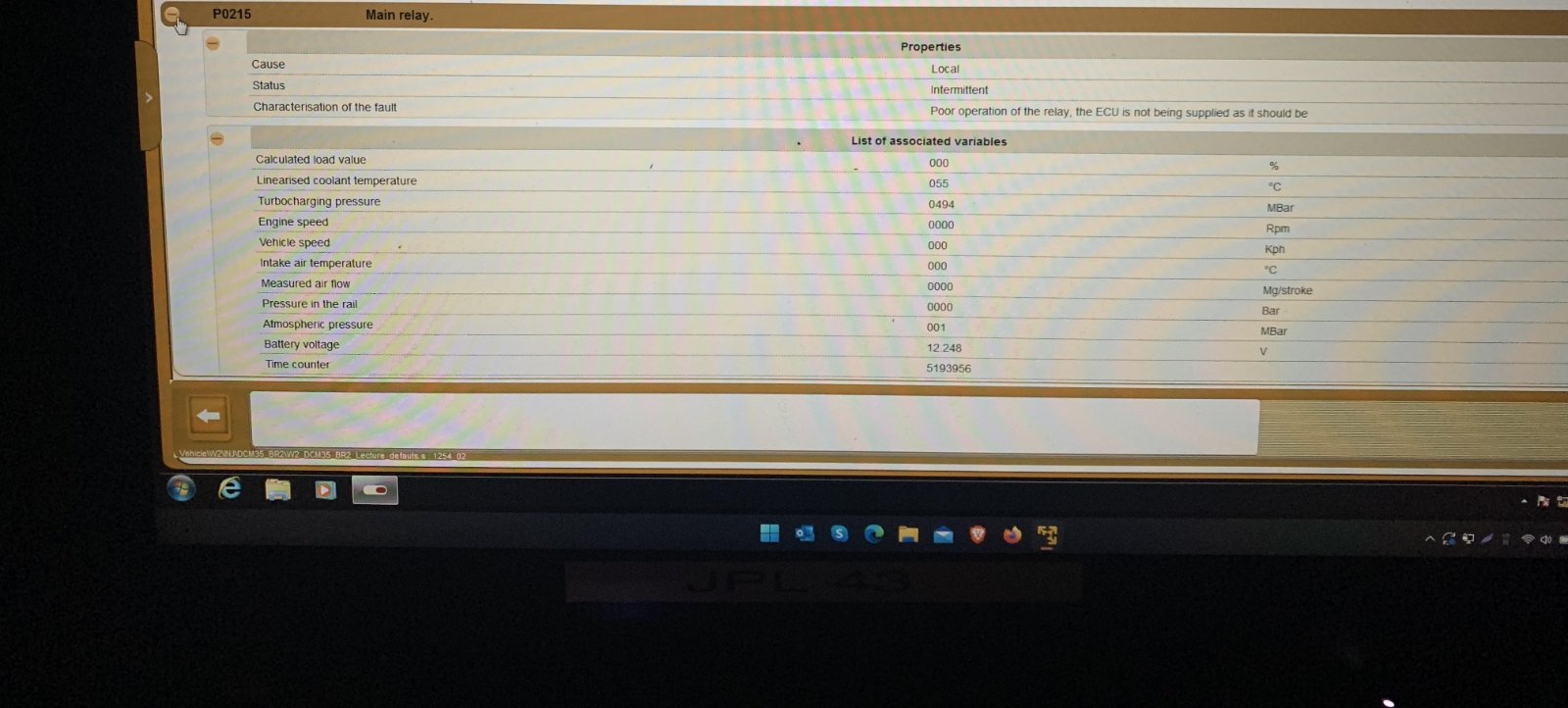

Hello guys,
Car is Peugeot 508 2.0 163 hp 2011.
So i have problem that is happening occasionally and that is about starting the car.
Some times i can start it, some times i cant it happens randomly, after i successfully start it car drives fine.
When car is not starting, i can hear click sound from engine bay and that is it.
Only error that i could find with diagbox related to this problem is attached.
Already checked fuse box that is on top of the battery(1yr old battery, no problem with it), checked connections, tightened the screws that hold that fuse box.(Recommended from googling this error)
Any help would be appreciated.

It sounds like the starter isn't energising. It also sounds like you may need a new starter! If you do your own repairs, remove it and take it to an auto electrician for testing. He`ll tell you if it needs replacing.
