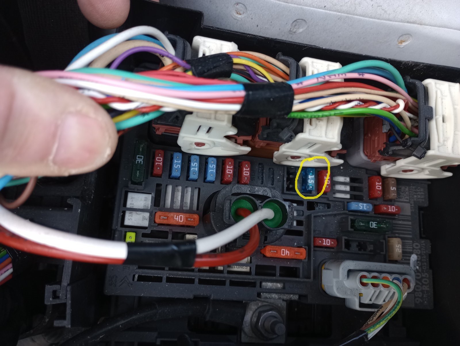

Hi all, am having a headache finding the under the bonnet fuse board schematic for the Citroen Berlingo diesel 2014. None seem to fit what I have. Top left should be 6 fuses in a row, with a larger 7th to the far left. Horn has gone and trying to discount fuse failure. I've attached a photo that I hope has worked

The horn should be fuse number 2.
The positioning of the fuses may look different in your handbook but the allocation numbers should still be the same. Sometimes when you replace the fusebox with a new one from the dealers the manufacturer may have changed & it can look different.
Can you hear a clicking from the fusebox when the horn push is pressed?

Ok. In the photo there's an empty fuse slot where I thought F2 should have been, but there are no metal contacts in it.
I bought this van second hand and it had passed an MOT but not sure how, if that fuse slot is F2 and non functional - unless that slot is irrelevant and fuse for horn located elsewhere.
I haven't listened for a click yet

I'd say fuse 2 was this 15 amp one. You can see its not the original fuse either, been changed at some point.
The empty one looks like Fuse 4?

I changed that to know what to buy, same amps, 15, as the blank one to the left, which I thought was the horn. Then I mislaid the original so left the new in.
Have listened for a clicking when pressing horn, with ignition in position 1 so lecci is flowing, but I dont hear anything.
I'll just have to put it into its MOT and hope they can solve it. Not ideal
