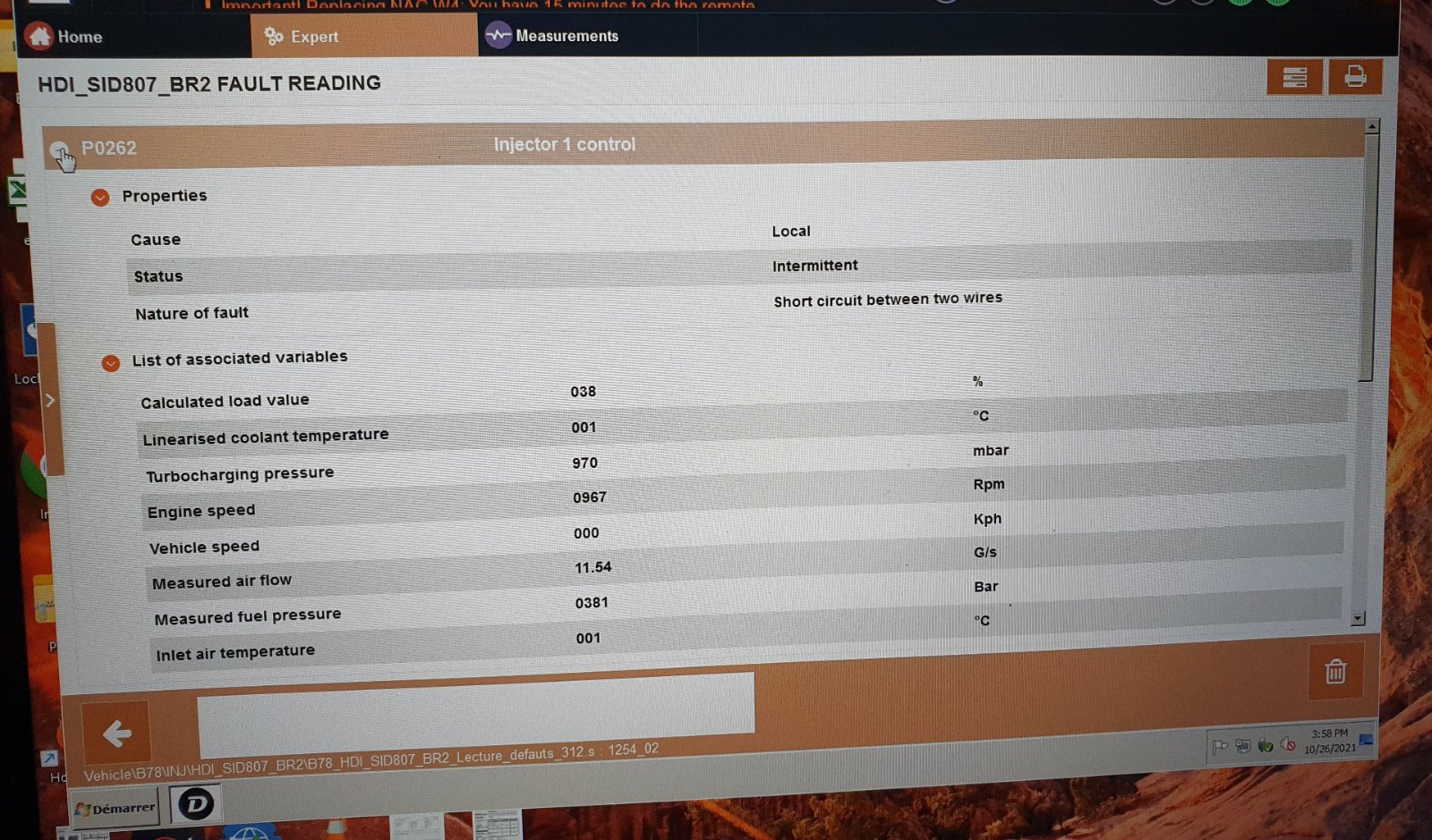

I have plugged in the Diagbox and after clearing all the errors the following error comes back after 30 seconds of the car being on:
P0262. - Injector 1 Control - Intermittent short circuit between 2 wires.

Managed to drive it back home and checked it on the diagbox and it had the same error code: P0262. - Injector 1 Control - Intermittent short circuit between 2 wires.
