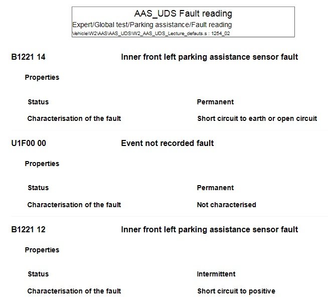

Using Lexia3 and Diagbox I got:
I cleared the errors and replaced the left with the right front inner sensor and got the same error message again.
I removed the front bumper and checked for an open or maybe a short in one of the wires for each of the sensors to the common connector on the bumper.
There is no open or any wire is shorted.

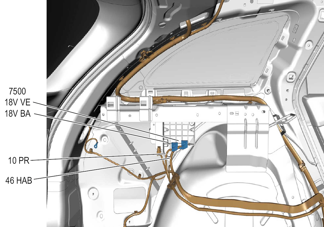

The sensors can be faulty internally as water ingress causes the issue. If one sensor is down the parking assistance ECU disables the system. There are rarely issues with the ECU itself, but the Parking Assistance ECU is located here on the inner left compartment of the boot area, marked as 7500 and showing the connections into it.

I assume that the sensor is correct inside, because when I switch the sensor from that location to another, it does not report an error, and the sensor from another location reports an error in that place. That's why I first checked the wiring in the bumper, and now I want to see that there is no problem with the wiring to the parking ECU. If you have any other ideas on what to check, that would be great.
